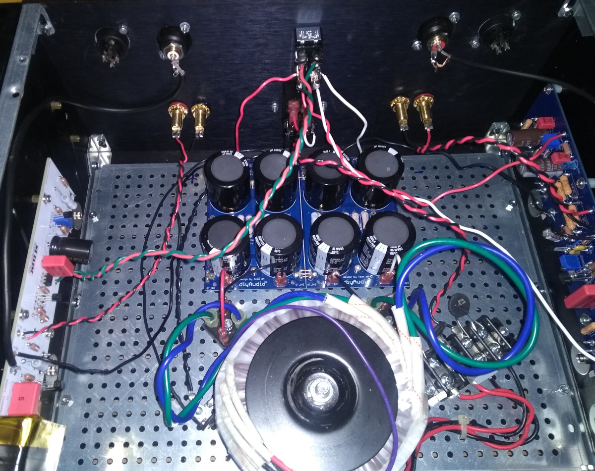

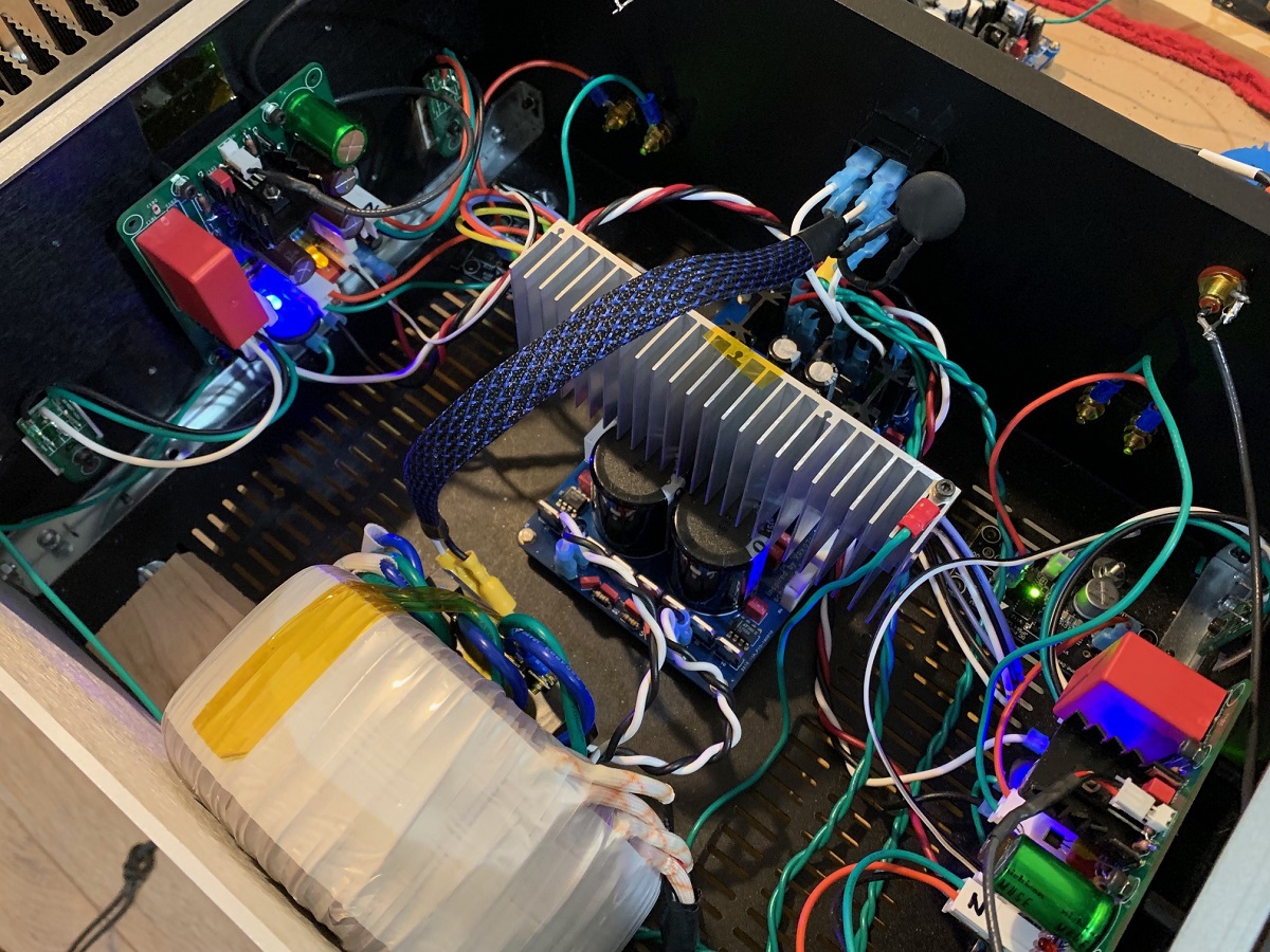

I had built an M2 and an Aleph J a while back. I've always loved the stereo imaging and sound-stage depth I get from mono-blocks, so I wanted to convert my amps to mono-blocks - but the expense for the extra chassis and power supplies kept me from doing so.
Since the Aleph J and the M2 use the same power supply, I decided to swap an Aleph J channel for an M2 channel between amps, so each amp has one Aleph J and one M2 board. I installed a heavy duty DPDT switch on the back of each amp, unhooked the V+ and V- from the power supply to the boards, and instead ran the V+ and V- to the center pole of the switch, and then ran lines from the switch to the V+ and V- of the audio boards. I didn't do anything with the ground lines.

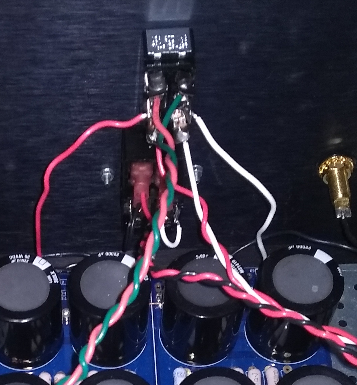

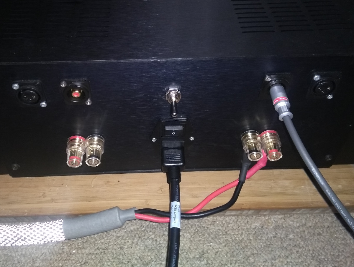

The power supply in each amp now only powers one board depending on the position of the switch, and I change the RCA input, speaker outputs and switch position depending on whether I want to hear M2 mono-blocks or Aleph J mono-blocks.
How did it turn out? Really well. I always had a bit of a ground loop that I could hear in my Aleph J if my ears were close to the speakers. Beyond the increase in separation that mono-blocks bring, now both the M2 and the Aleph J are totally silent with my ears right next to the drivers.
Both amps were built with Antek 18V 300 VAC transformers. As a stereo amp with this transformer, the M2 sounded very pretty for jazz, and folk type music, but wouldn't really rock to satisfaction. Dedicating the power supply to a single audio board has given the M2 much more bass drive and punch. I was actually shocked at the difference, as I wasn't expecting it. Now the amp can rock as well.
Hear are a few not-so-great pictures that demonstrate the change.
P.S. Not that there would be any reason to, but as 6L6 pointed out when I asked about the idea earlier, you would never want to flip the switch while the amp is running.

What should the DPDT switch be rated? 10 amp sufficient? Suggested switch? Always fearing my clever Puddy Cat will walk behind switch switch in mid Jam.....
Couldn't quite make out numbers on switch blowing up your supplied pic.
Would like if possible a semi protected switch to prevent Cat's shinanigans, as well as prevent owner/operator mishap as well!
Guess I could locate switch inside chassis.

Hopefully the picture will help. I don't have the packaging material so I don't know the exact model number. I just went to the local electronics distributor and found a reasonably heavy duty switch. The switch takes quite a bit of force to flip, so I don't think your cat could flip it, unless she is a mountain lion.
