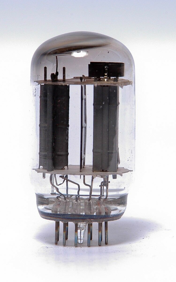

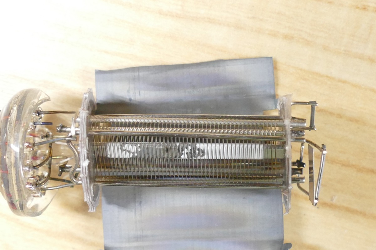

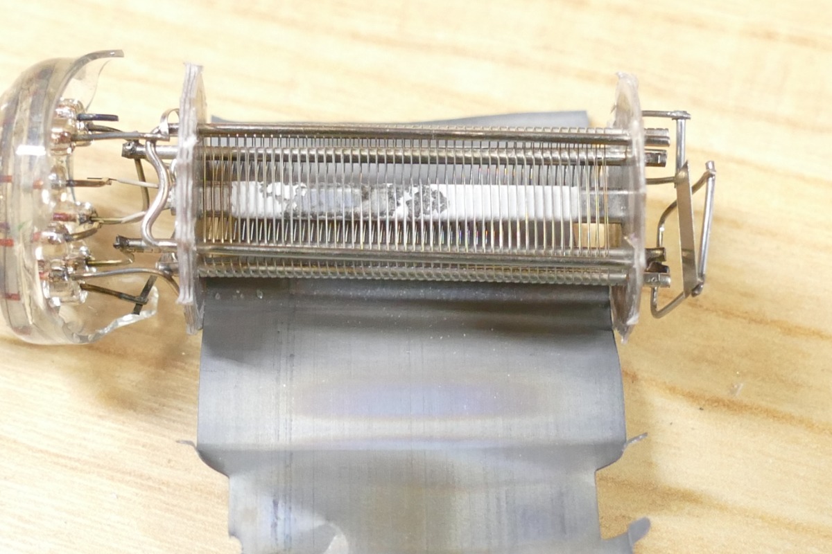

WHACK said the hammer to the tube. I looked into my bag of 5763 tubes and it wasn't hard to find one with cathode flakes loose inside the glass and near zero getter, so I offered it up to science. I have cracked open LOTS of tubes in my nearly 60 years of tinkering with them, and I have never seen this. There are no beam forming plates, and no suppressor grid either, just 4 grid posts with no grid wire on them. This explains the tetrode kink. This tube has likely arced over a few times since there is cathode material missing from both sided of the cathode and the plate looks like its seen some redness. I wasn't being too careful when I ripped it open, so the misalignment twist was my doing.
Really nothing connected to pin #3? The spec sheet says it is a pentode. Not that an actual tube would differ from stated specs.
That's odd alright. The lack of beam forming plates in an RF amplifier tube seems, well, bizarre.
I've definitely seen it before (pure tetrode with no suppressor grid or beam forming plates), but the only tube that comes to mind is a 715 / 5D21.
From careful scrutiny of Tubelab's pics, it's got two side posts with no gridding wire on them (to pin 3). Half way between a beam pentode and a tetrode. Explains the somewhat kinked curves. Wiseoldtech had it right. "Internal design is different, specifically for RF use." Fishing bobbers in other words.

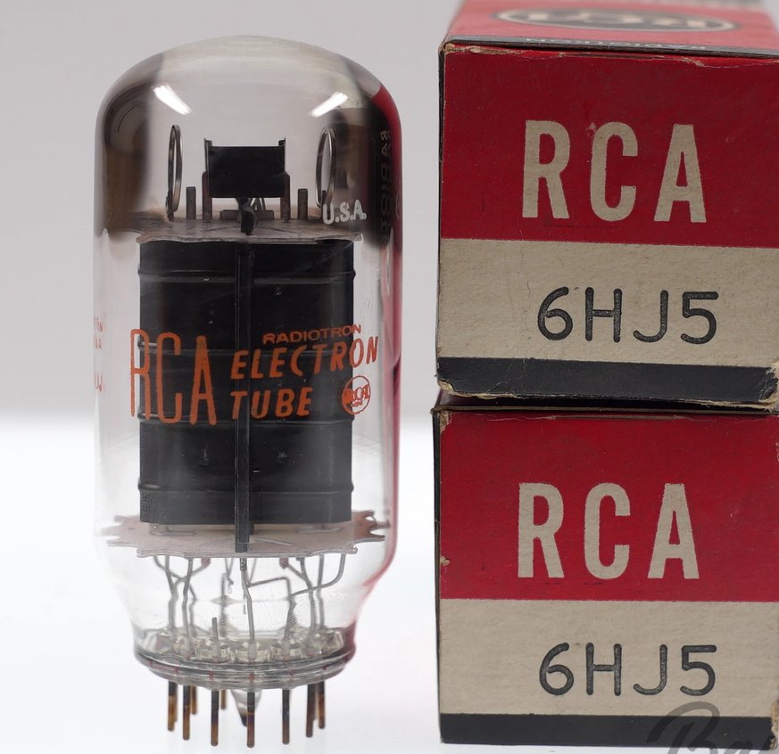

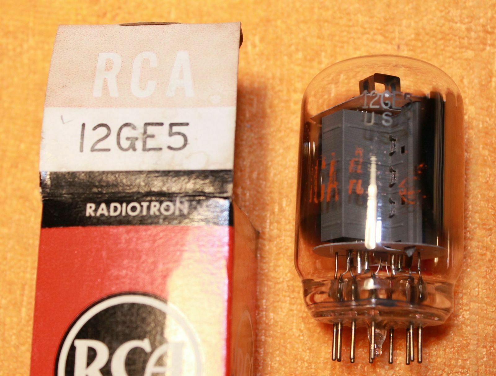

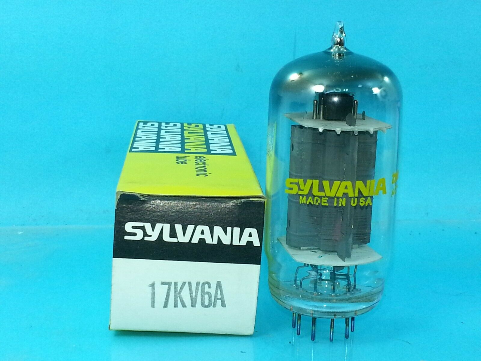

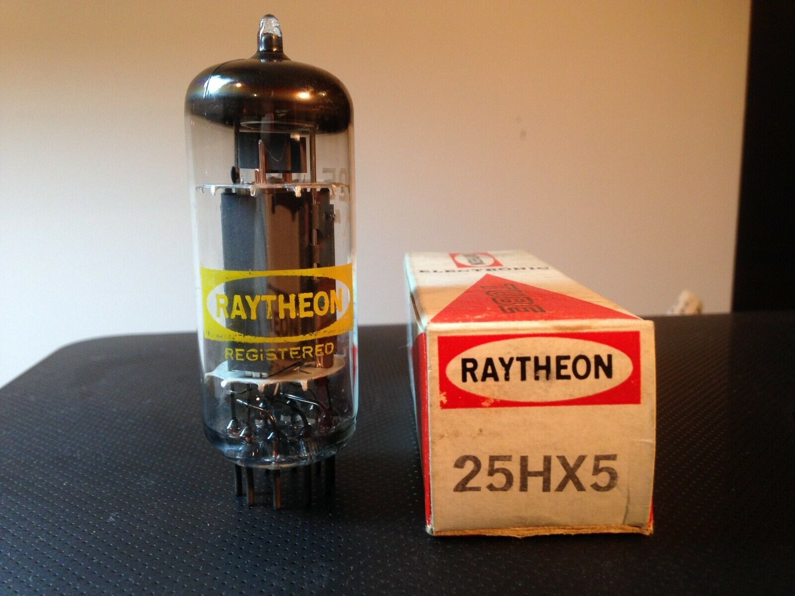

Save yourself some grief. Get some 6197 tubes (similar to 6CL6 video tube) pentodes for something cheap, military, and very audio use-able. (curves below)
Or a selection like 6197, 6HB6, 6EW6, 6BN11, 12HL7, 6HZ8, 6GF5, 6LY8, 6KV8, 6KR8, 6LU8, 6FM7, 10/6JA5, 6JC5, 38HE7, 25HX5, 6CB5A, 6EX6, 12GE5, 21HB5A, 33/21JV6, 17KV6A, 6HJ5 , 21LG6A

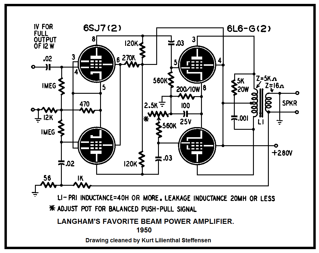

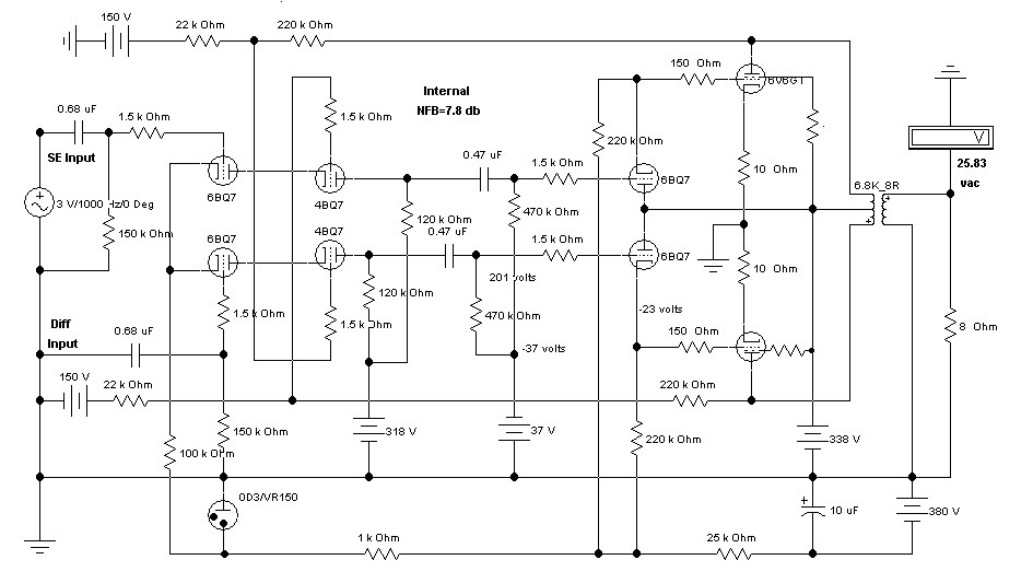

To stir this pot further, if one is adventurous why not try the 5763 as a voltage amplifier in an
amp such as the attached. Its only a tube, not particularly special aside from what the manufacturer
thinks is a best fit. The OP seems to have a fleet of these toobz. The cct as shewn needs some
components values changed but not a big deal at all.
The cct is very innovative & gets a lot done with a few toobz. Notice the designer did not bypass
the screens of the driver, this has a balancing effect similar to an unbypassed cathode resister.
Running large value resisters on the plate & screens of the driver reduces the gm so there is
less likely to be self oscillation in the driver stage. For a first pass omit some of the frills such as
the AC balance control & the RC network across the OPT primary.
The end product will be the same as most other toob amps on this forum, which kind of distortion
do we like best. For an experienced designer this one is a 'no brainer'. 🙂
But still only 5W at best. Looks like it makes a good AM modulator in Class AB2 tho.

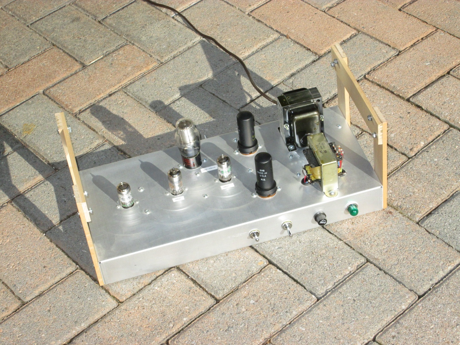

Wouldn't Ya know it, here is my experimental effort at Class AB2 on PP 6V6s about 20 yrs ago.
The cct could easily fit those 5763s & from the data sheet, the claim is 20 Watts.
This built manages 27W. And the measured results are pretty good.
I had it on the test bench in February, the numbers still look very good.
Contrast that to many amps the shew up here but never any test results
we can compare to. They just 'sound OK'. So does this amp.
Depends on the toobz used, it runs in Class A up to about 5W.👍

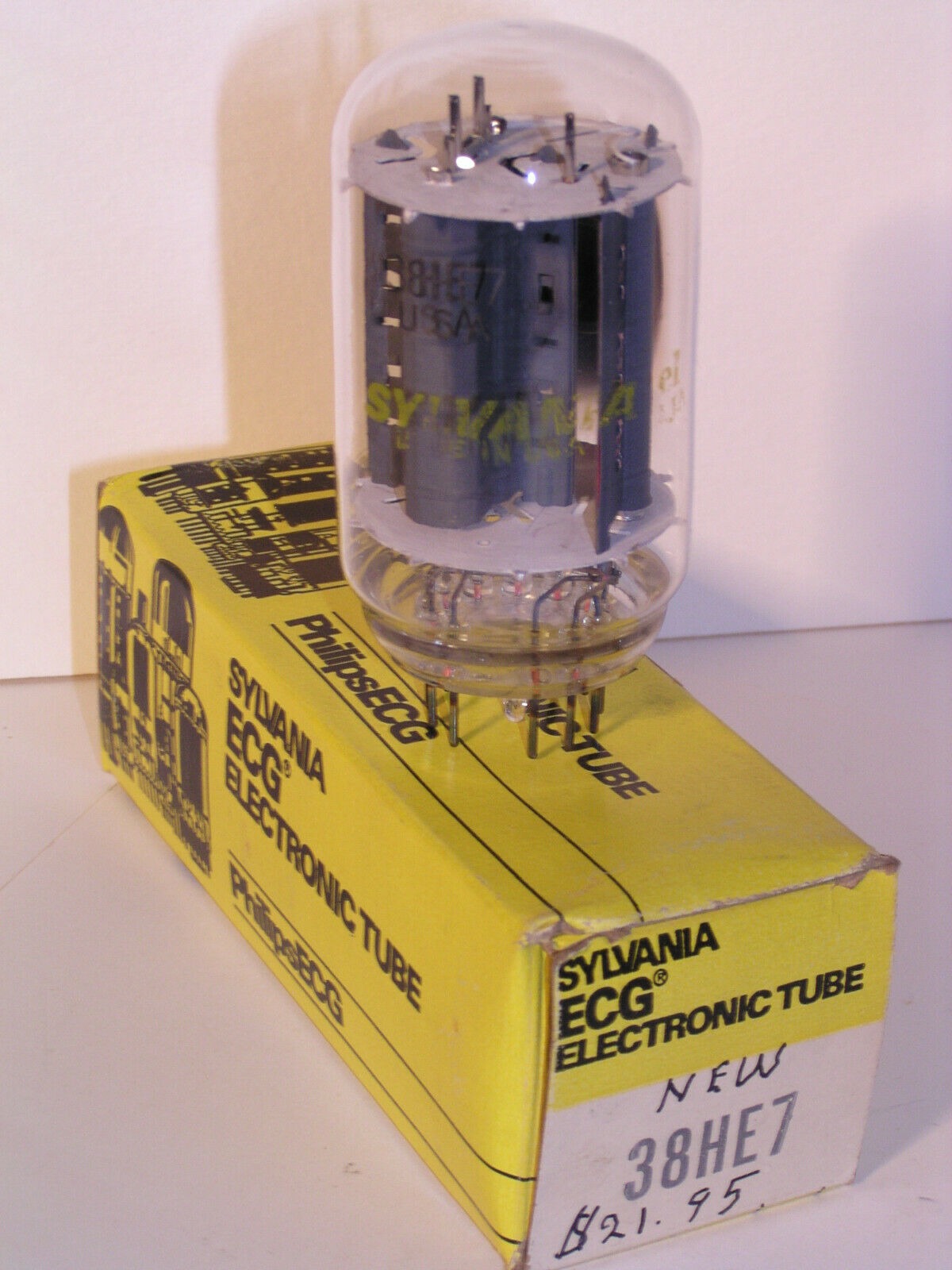

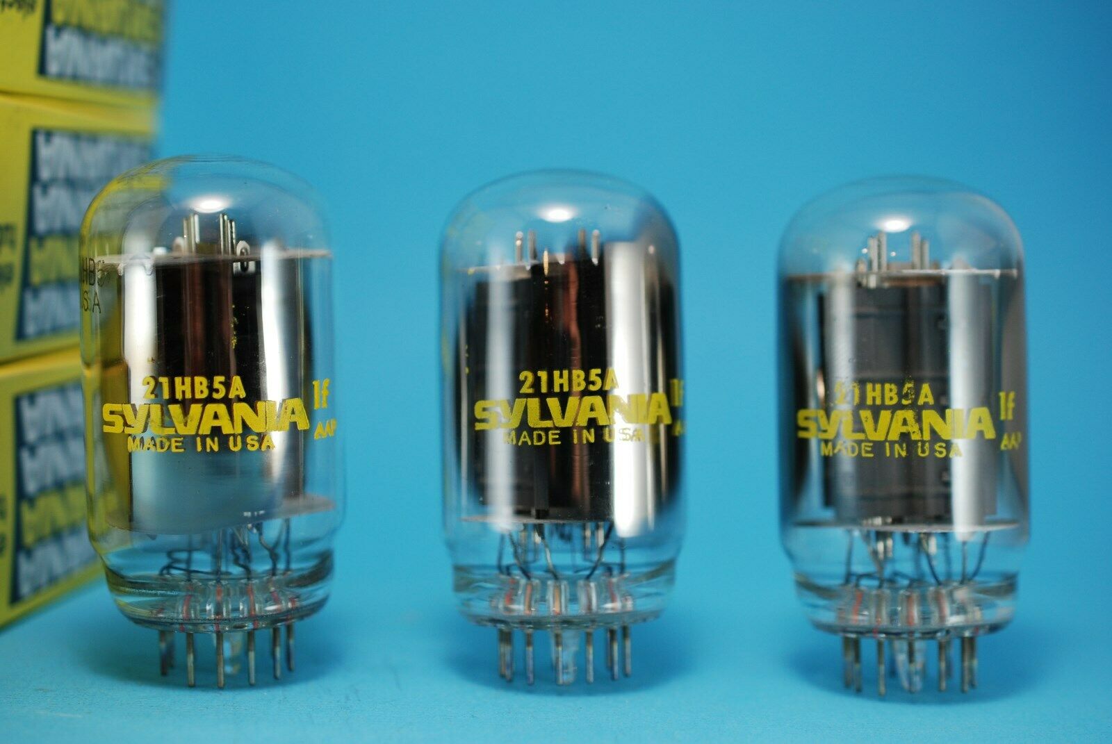

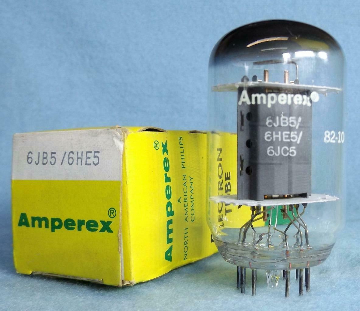

Some of the dirt cheap ( $3 to $4 ) power tubes around, and decent audio tubes as well.
6GF5 ( "70 to 80 Watts" George must be water cooling these, or using a big fan!! Oh, UNSET mode probably )
6LU8
6JC5/6JB5, 10/6JA5
21LG6A
12GE5
21HB5 21JV6
38HE7 most of these have series heaters, so the pentode only can be run with 21V on pins 10 and 12, with the pentode up-rated to 15 Watts Pdiss (sweep rating)
21EX6, 6CD6, 6DQ5, 6CB5A

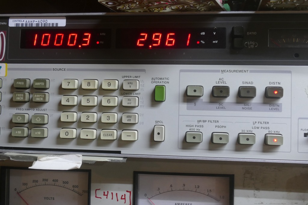

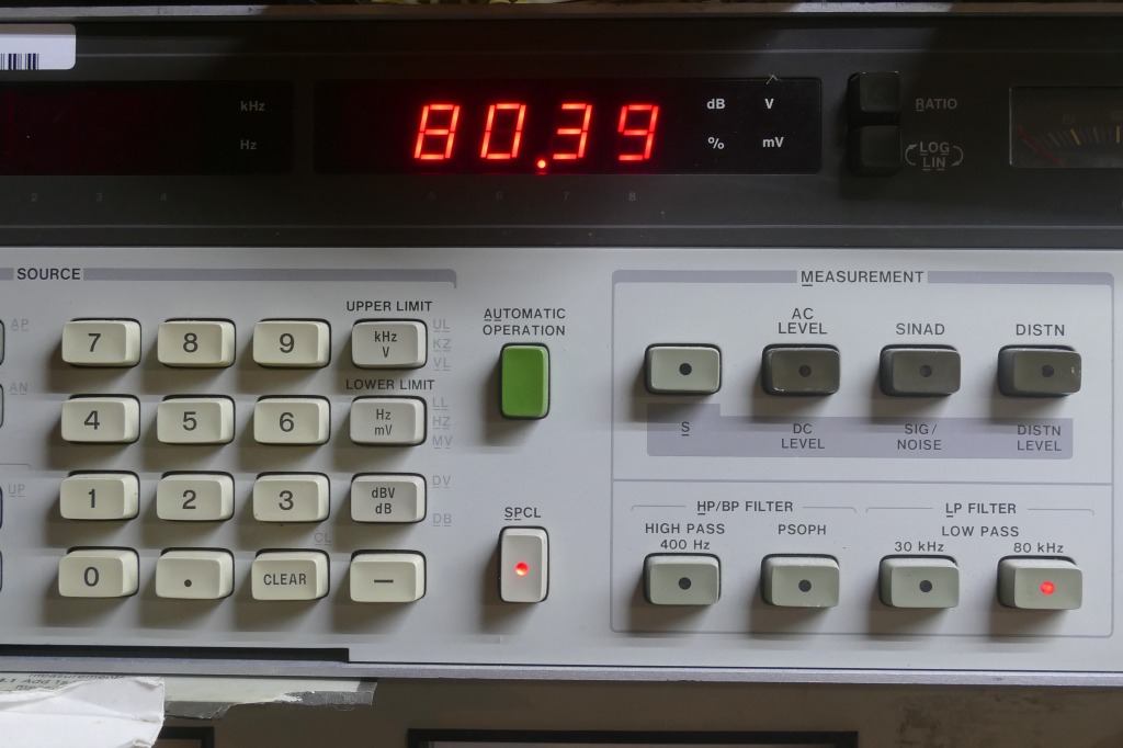

No fan needed. These little guys can take a beating and keep on ticking (remember that one).

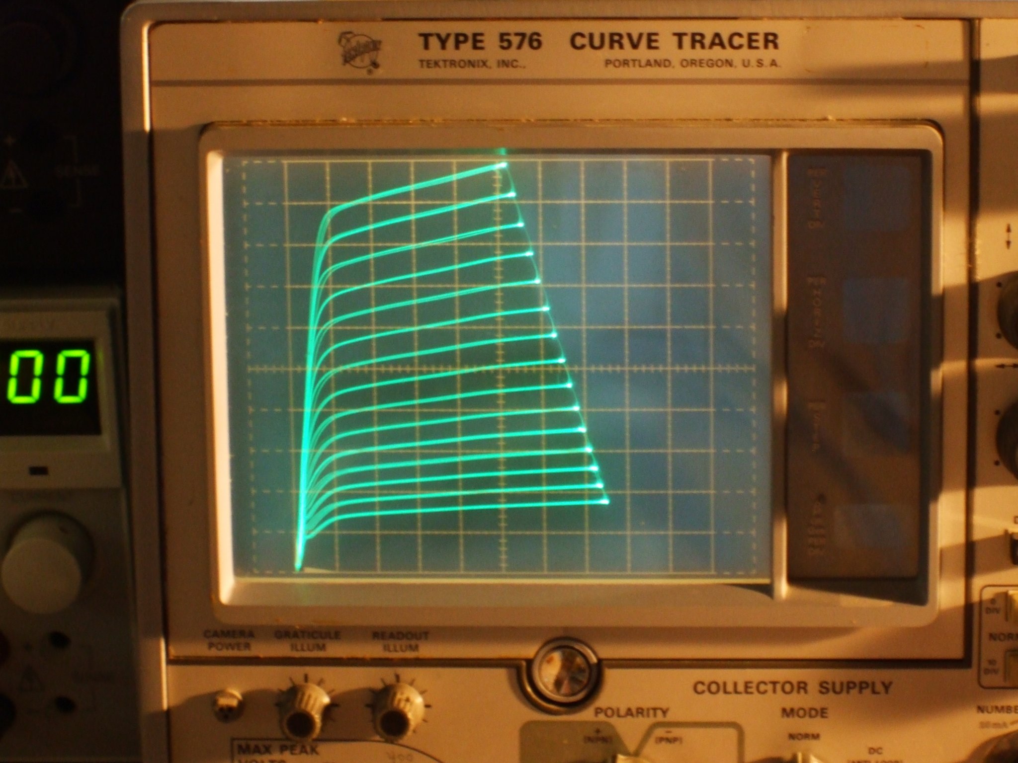

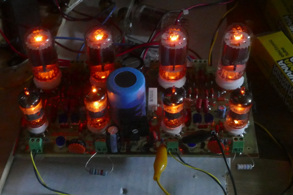

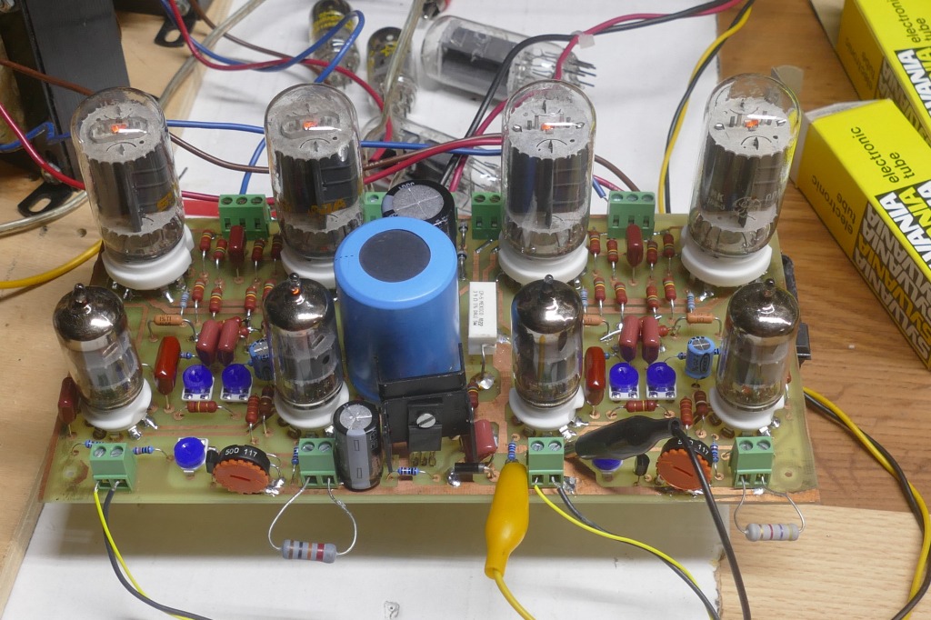

The circuit is UN - Push Pull. The first amp I built using this tech was push pull. It can be seen here cranking out 80 watts at 2.9% THD from a 500 volt power supply. Nothing but heaters glowing. I have also seen a pair of 36LW6's make 250 watts using the same tech, but they are not cheap tubes. The 6GF5 was on the dollar list forever, so I got a bunch. Despite trying, I haven't blown one up yet. I also got a box full of 25DN6's for 50 cents each. A pair of those will do 100 watts all day long using conventional G1 drive tech.
