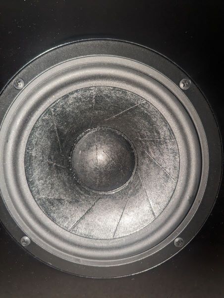

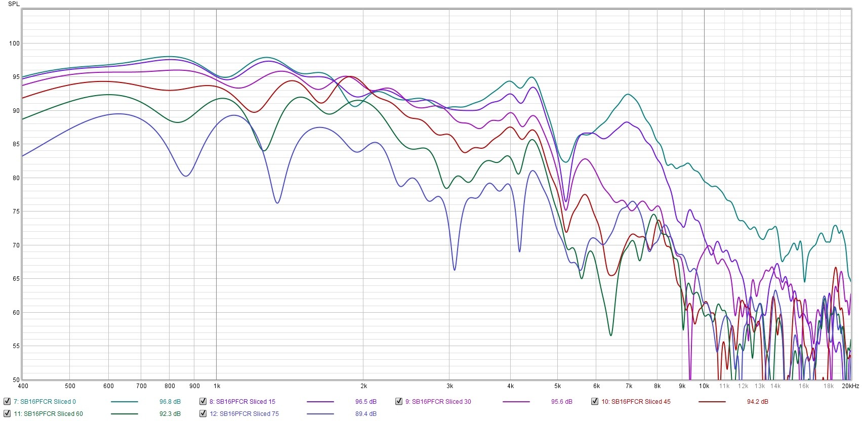

Despite the forum's prompt to start a new thread, I thought it made more sense to post this here where some other experiments have been posted. I sliced an SB16PFCR25-8 in a similar pattern to the revelator. I used DAP Alex Plus with Silicone Clear caulk. Because it was clear I could see light through the cone and wasn't sure if there was air leakage so I put some black Dynaflex caulk on the back just to make sure there was no air leak. I put a little bit of gloss Modge Podge on the cone and quickly wiped it off - not trying to add damping but just to make my ugly glue-job look better.

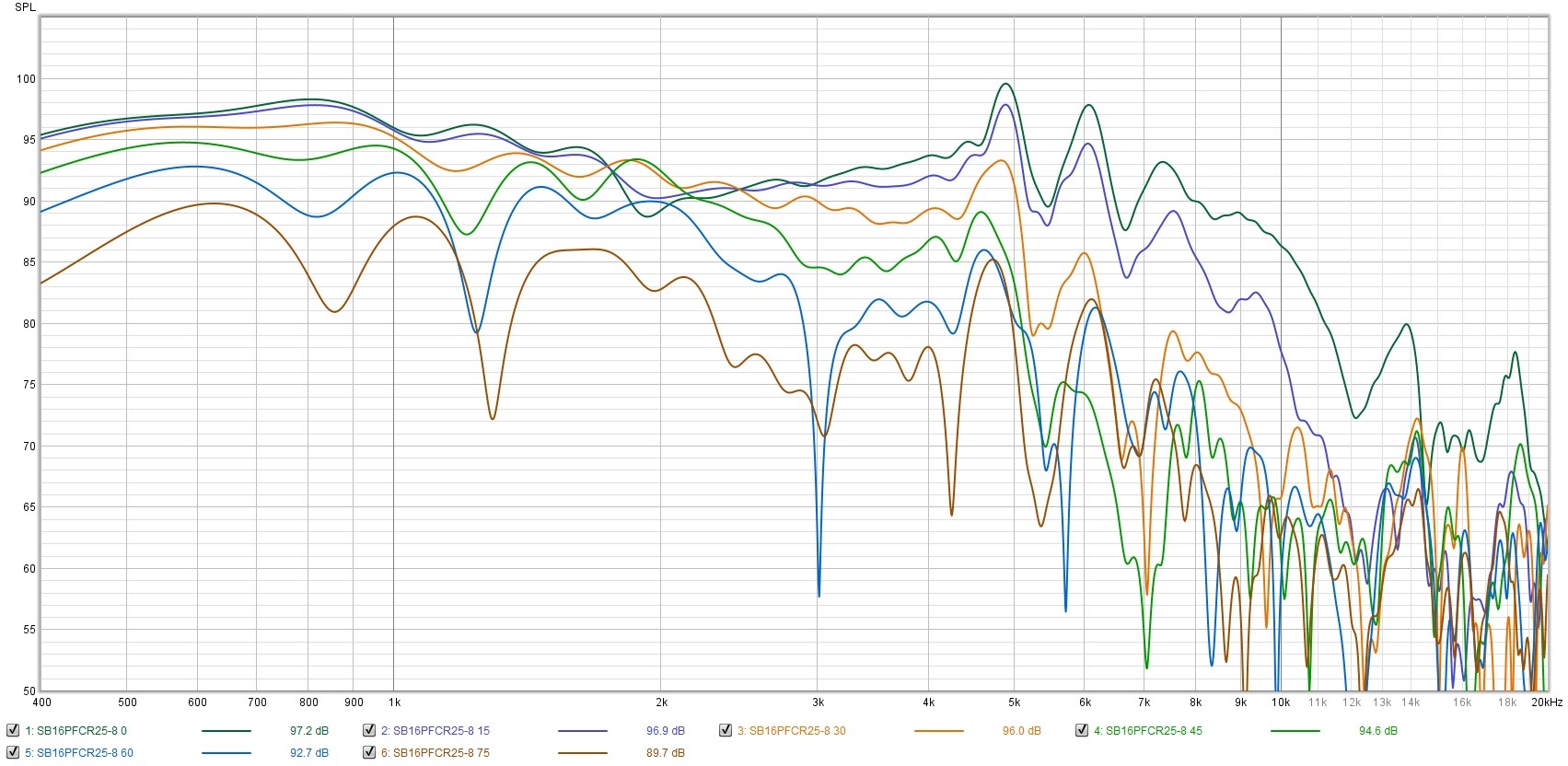

Here is the stock driver from 0 to 75 degrees (15 degree increments)
And here is the modified driver - greatly reducing the cone breakup at 5Khz and 6Khz

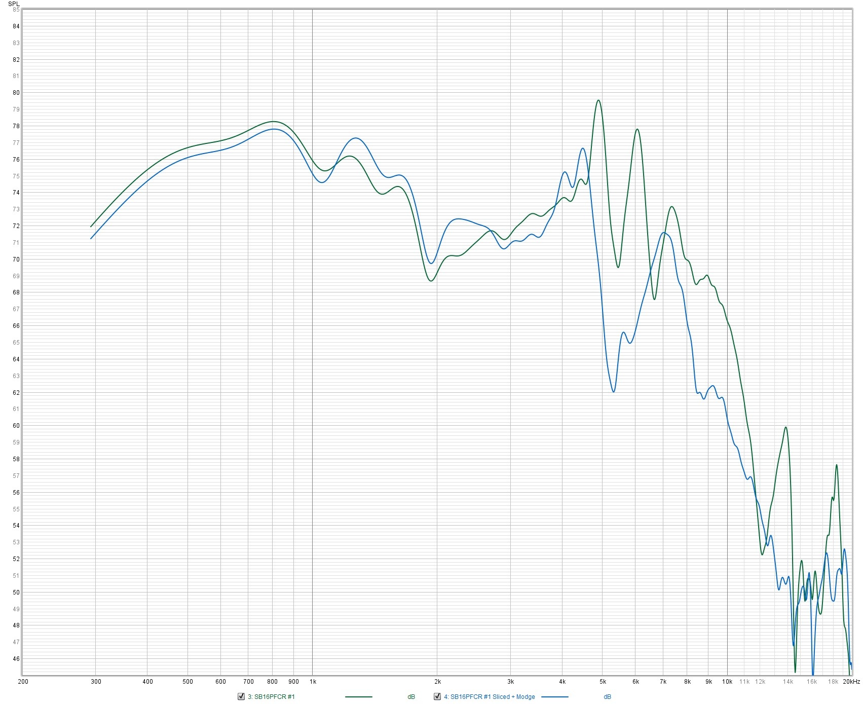

On-axis SPL of stock cone vs sliced cone

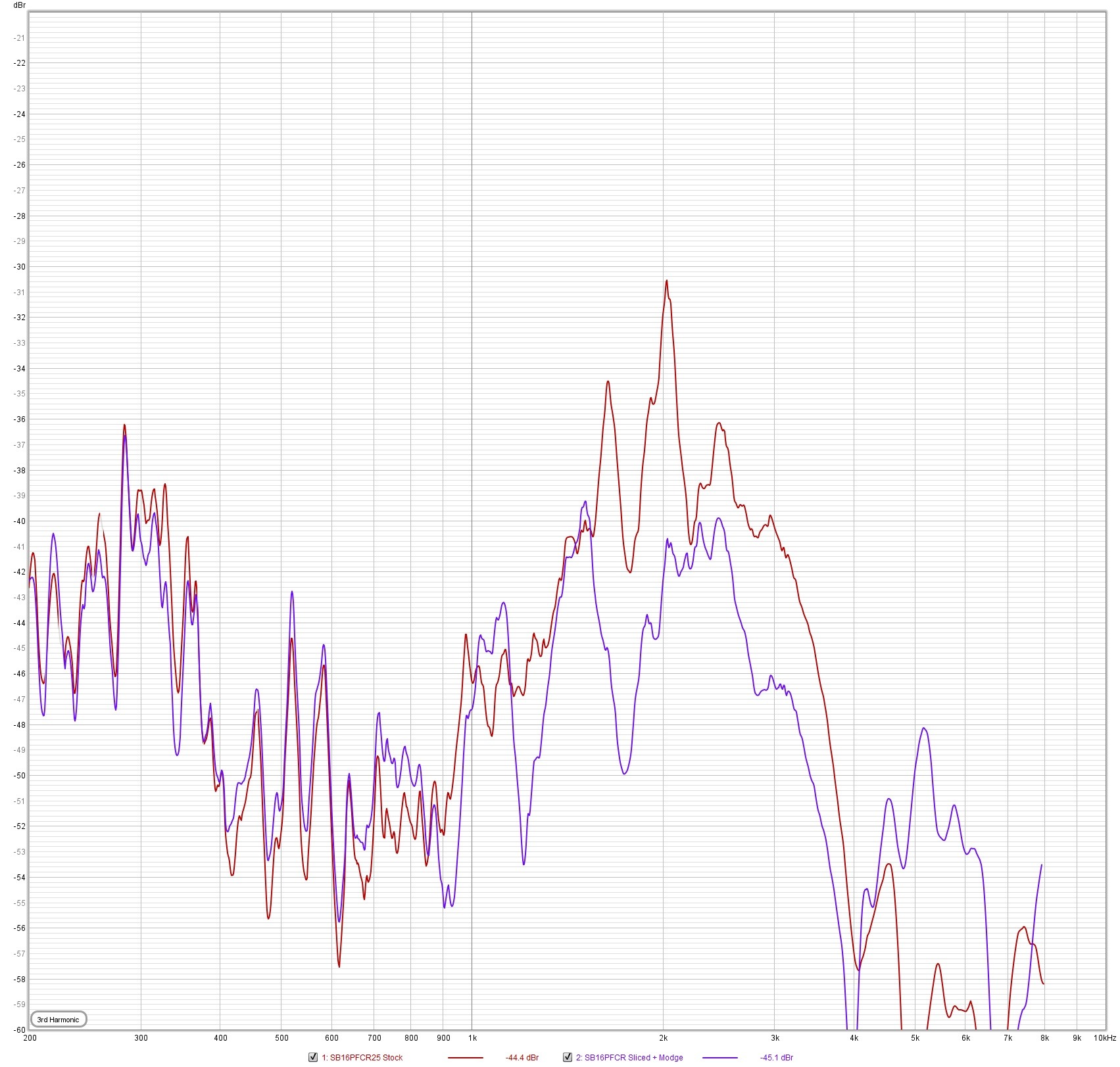

Here is 3rd order distortion of the stock cone vs the sliced cone

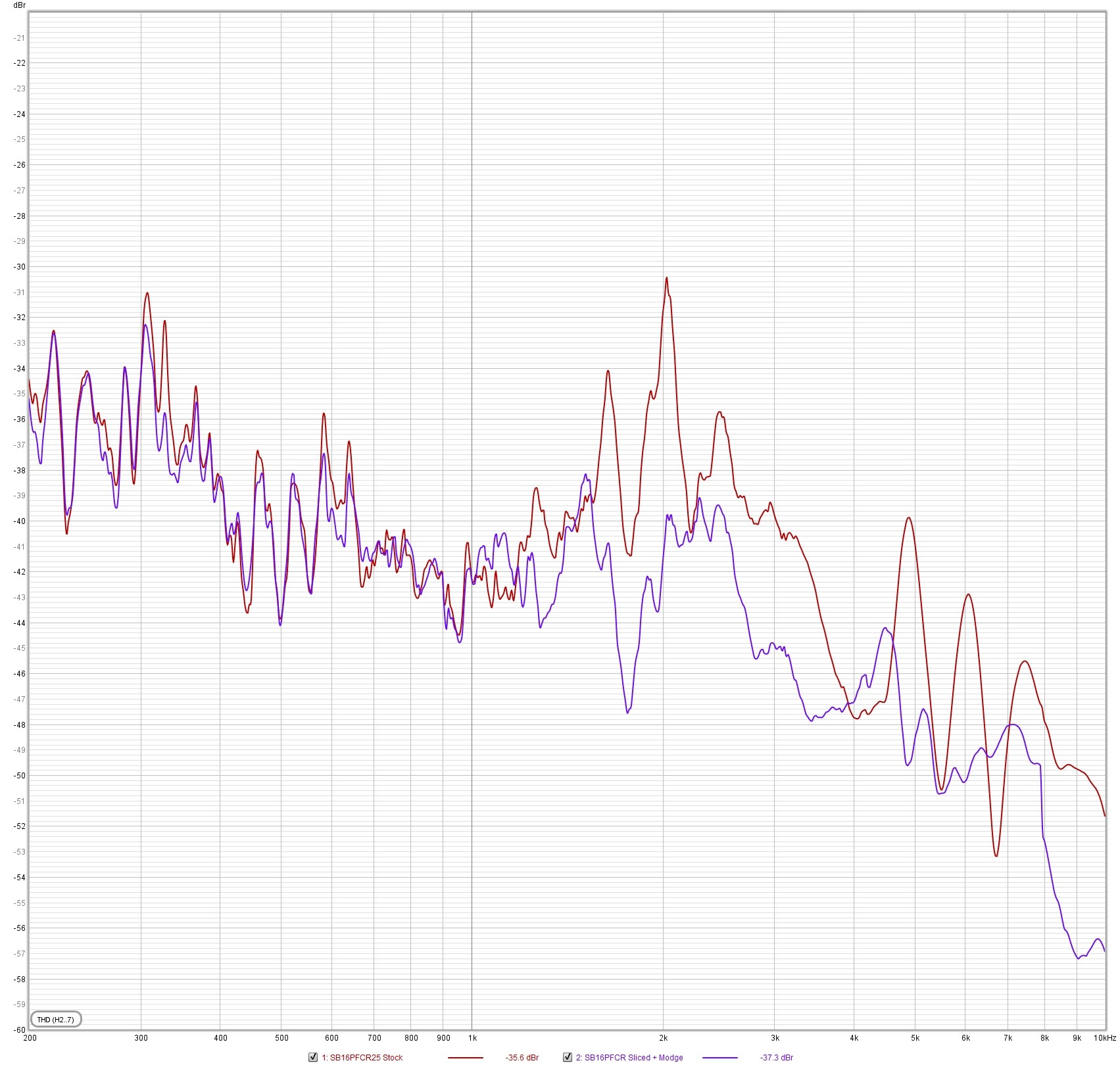

Here is THD of stock cone vs sliced cone

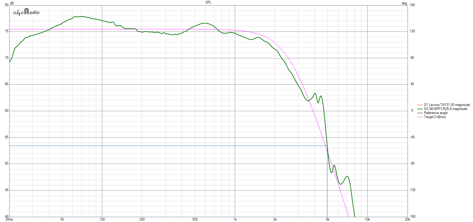

Here is the woofer with a LR4 acoustic crossover in place
Nice work! Note that Revelator at al, use 5 slices for pentagonal symmetry, which prevents even order (mirror symmetry) drum head vibration modes. Could use 7 but too many more and it approximates a round even cone. You used 10 slices - which is even number. It might have been better at 9 or 7.

The Scanspeak 15M/4531K Revelator 5.5" Midrange pictured on Madisound has 10 slices along with the two on the dust cap.Nice work! Note that Revelator at al, use 5 slices for pentagonal symmetry, which prevents even order (mirror symmetry) drum head vibration modes.

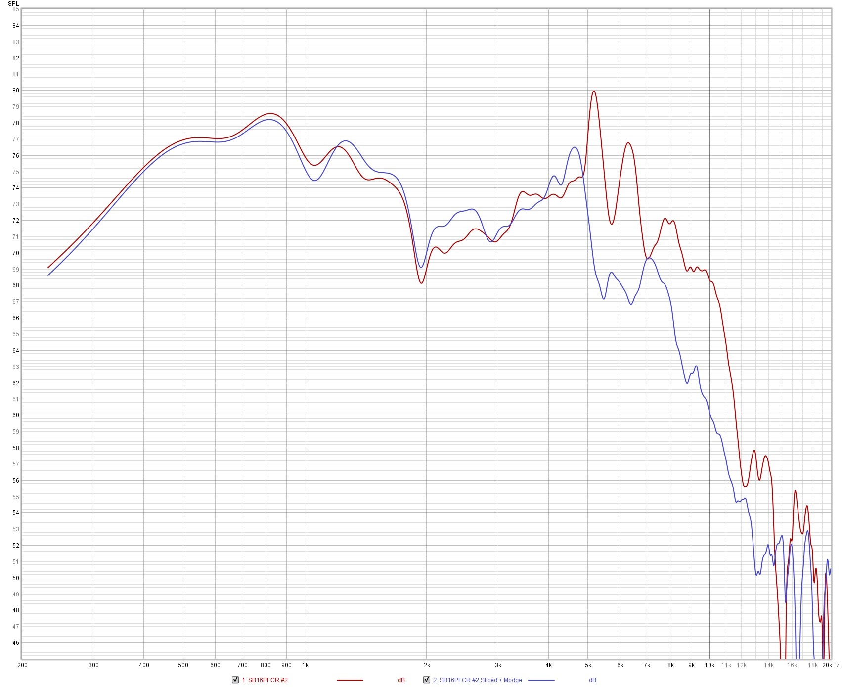

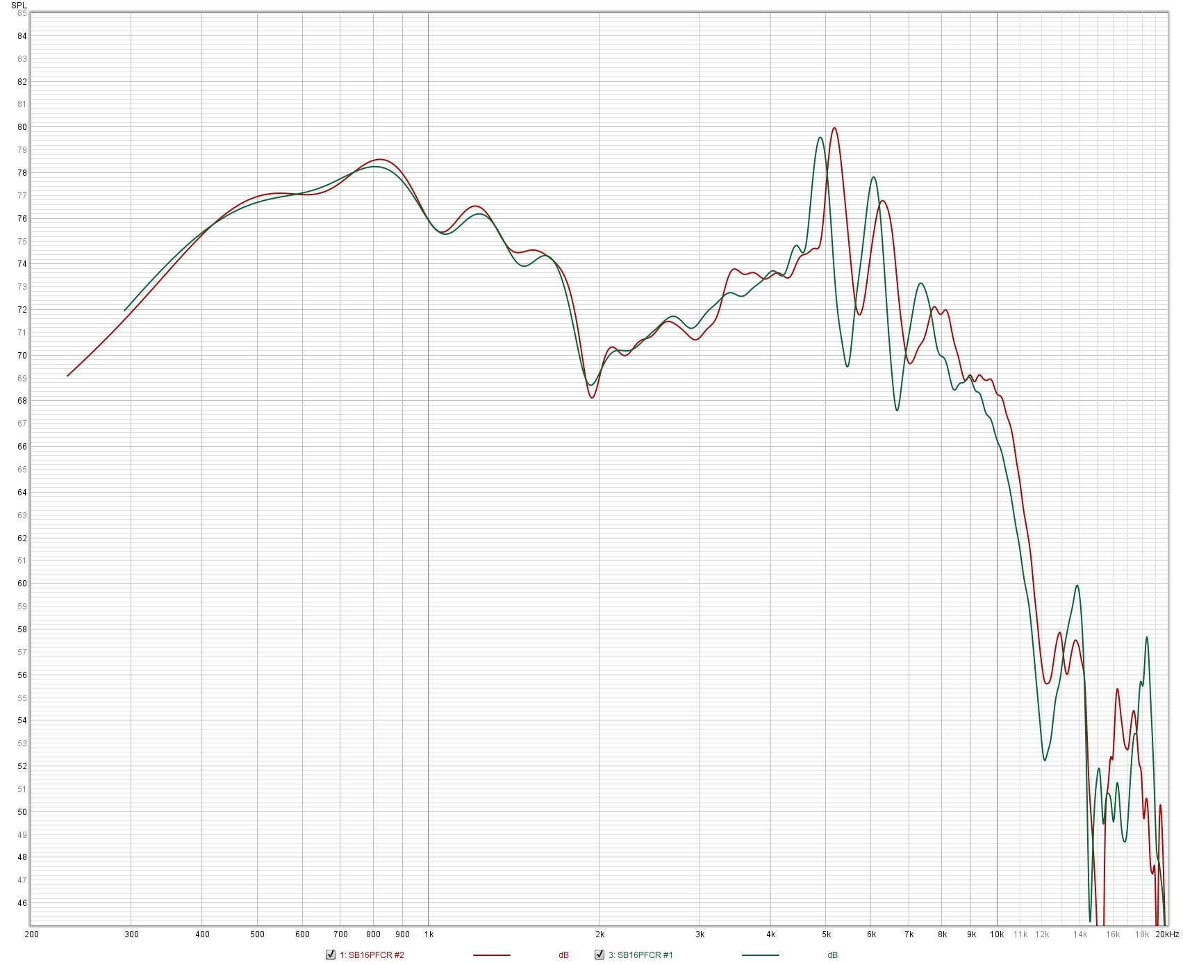

The "On-axis SPL of stock cone vs sliced cone" in the post above was my woofer #1, here is the same for woofer #2
Here were the two stock (un-modified) woofers before I started.

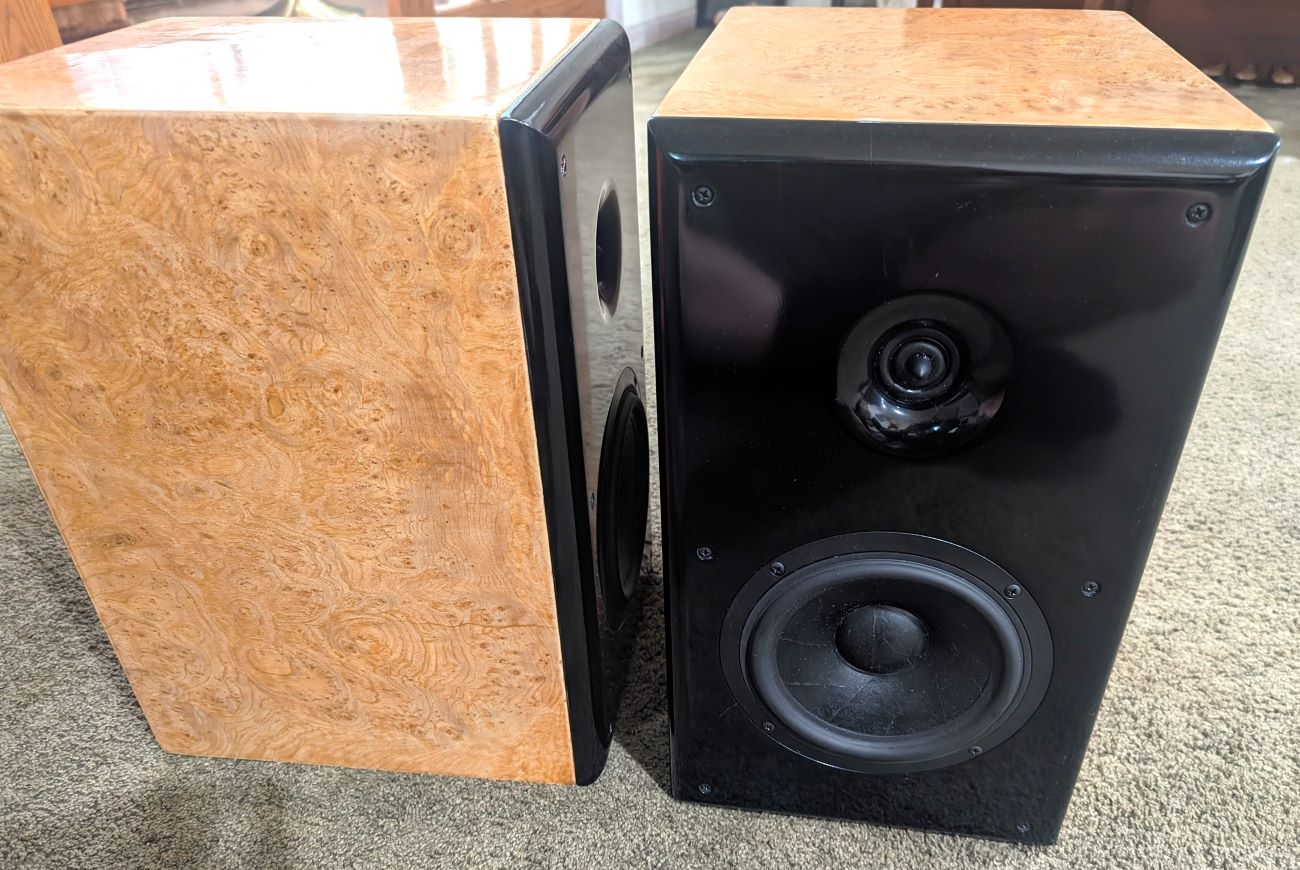

Here is an actual speaker with a Lavoce TN131.00 tweeter, taken to InDIYana 2023 and Parts Expresss SDC2023.
This is the speaker, but the tweeter changed to a Peerless XT25SC40 since then. Ash Burl veneer and a DIY waveguide using a Yonico table edge router bit.
My objective conclusions: Slicing a paper cone woofer can reduce the cone breakup significantly as well as lower distortion.
Practical conclusion: This is mostly above the crossover. Reducing the cone breakup definitely makes designing the crossover easier, but its not clear that I couldn't get to the same place with more or different components.
