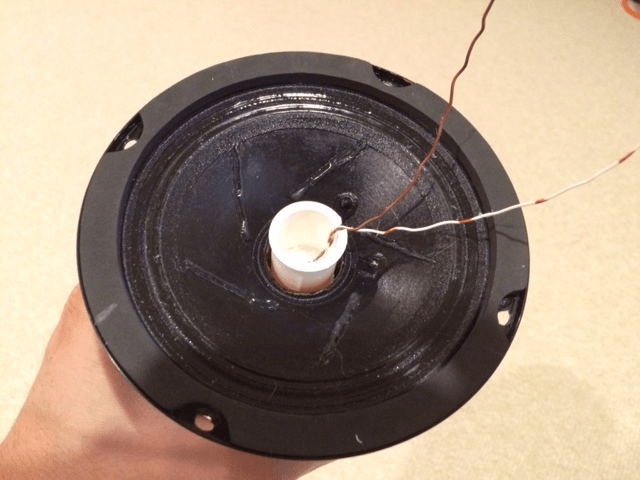

The varnish is pretty flexible even when cured. https://photos.app.goo.gl/t6DFPtA3uZkCc5r36
I tried something similar on a PA130-8.

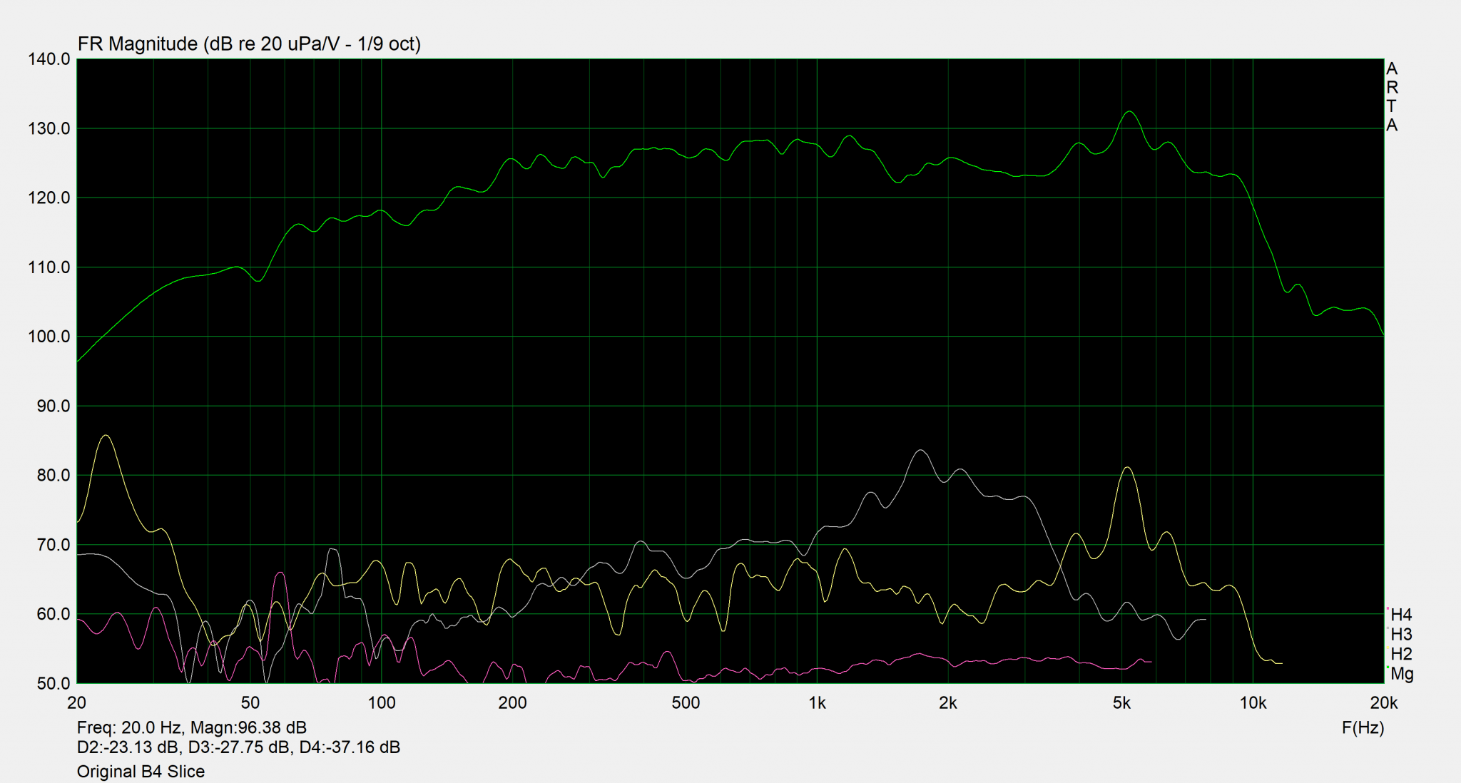

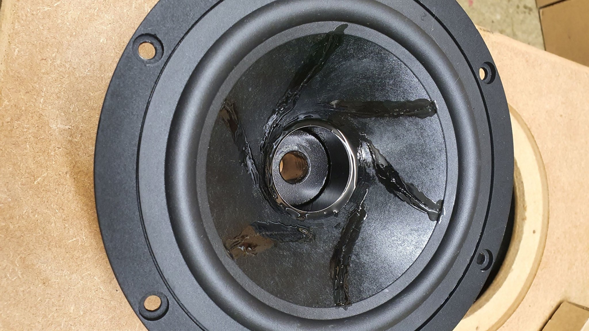

It looks a little flatter than original between 1.5 and just over 3kHz range where the ear is sensitive. This might work better depending where the crossover to a tweeter is placed. Cosmetically you could have done a tidier job, possibly with some suitable material glued or adhesive tapes across the cuts at the back of the cone. Maybe you should buy some cheap speakers to use as guinea pigs. I recently used removable painters masking tape to stabilise the disc drive of a CD player. I had bought this at an op shop and worked well for a while but started skipping. Opening it up I found that a cover to clamp the disc was not there. The movement of the motor did not affect the effectiveness of the tape.I was curious about the effect of slicing and coating a speaker cone in a similar way ScanSpeak do.

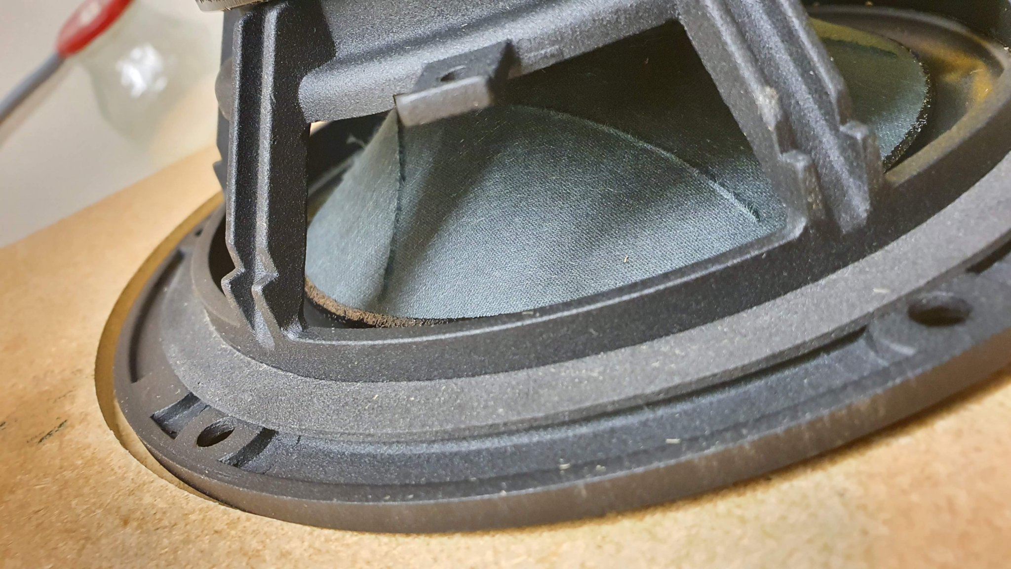

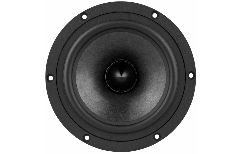

So here you go. Original driver, measured 80dB @ 30cm (at least according to my phone SPL meter).

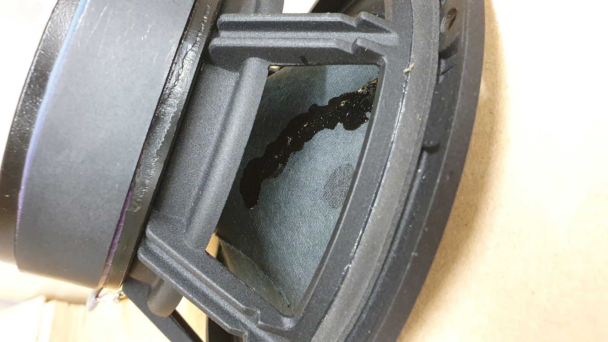

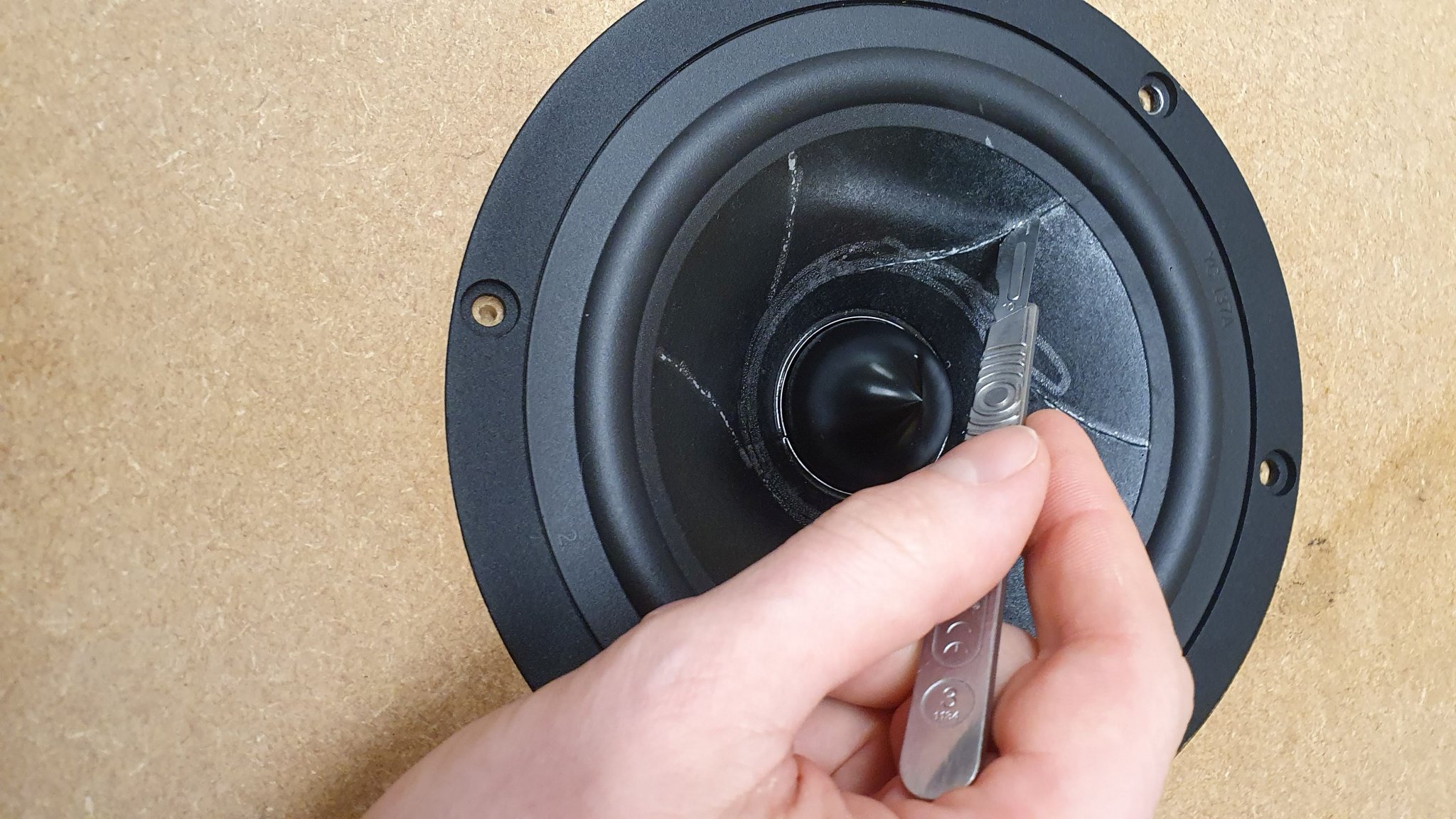

Now we slice and varnish! Varnish used was two part Sayerlack TLL3097.
I'm amazed the results are so damn similar before and after such brutal slaughter of the driver!
Thank you! Your experiment proves very well that anyone who advocates such treatment simply spreads snake oil BS, unless he's in need for an ugly looking driver.
