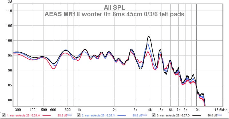

I sliced my speaker cone!
I was curious about the effect of slicing and coating a speaker cone in a similar way ScanSpeak do.
So here you go. Original driver, measured 80dB @ 30cm (at least according to my phone SPL meter).
Now we slice and varnish! Varnish used was two part Sayerlack TLL3097.
I'm amazed the results are so damn similar before and after such brutal slaughter of the driver!

Nice experiment. Try overlaying the results and observing them on a smaller vertical scale, as a 90 dB scale easily hides 1 dB differences.
Slicing can be done to alter the cone resonance modes. Where to slice, depends on the mode shapes, which you can find with a Finite Element study. It also matters what you do with the slices. If you glue the edges together with a stiff glue, I think you basically undo the slicing. Scan Speak uses a flexible glue that adds damping to the modes. I do not know if the slicing has a significant effect. The cone is also coated, which can be done to dampen these modes as well.
Overlaid, the differences are within measurement tolerance and noise.
I do know that the main breakups are happening around 1-2cm from the outer edge of the cone. I put the mic very close to 'scan' the cone surface.

I'm thinking to try a two coatings (I've got a pair of woofers to sacrifice) to see what happens with that 5KHz break-up. Any recommendations?
