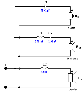

I put together a simple 3-way crossover diagram and I have some doubts about it
So there is no problem if I make a filter for the bass at 400hz and start the midrange at 404hz?
I thought it would cut the frequencies that were in the middle, or at least leave them lower.
In the music itself, wouldn't that make a difference? it wouldn't harm the sound so to speak
Why wouldn't you just calculate for 400 Hz? You are making a problem where none requires to exist!

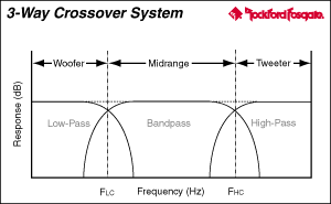

Here's how a 1st order, 3-way Butterworth filter is designed to cross:
The crossover slopes (full lines) are made to overlap so that the responses at fL and fH are 3 dB down.
This ensures that the overall response (horizontal dotted line) sums to flat.

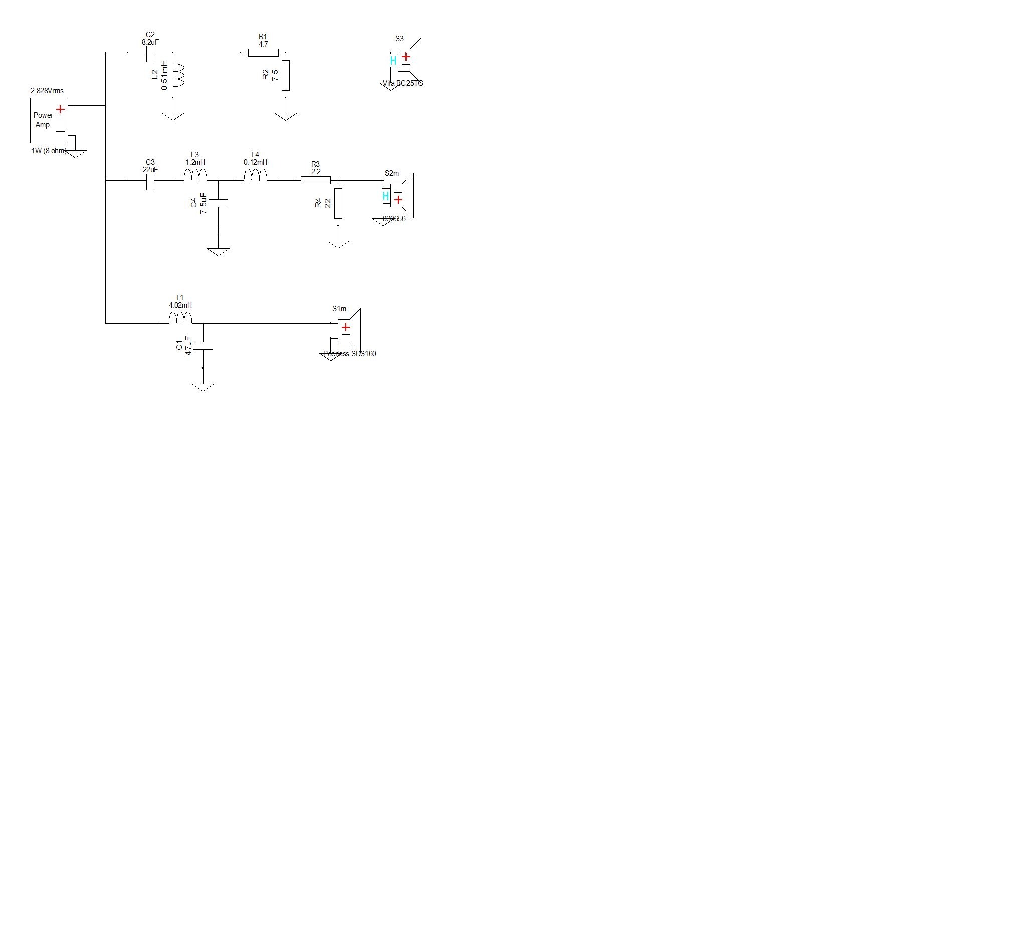

For illustration, I've attached a Xsim simulation of a three way speaker using well behaved and inexpensive drivers from Peerless: a 6.5' woofer, 5" mid and 1" dome tweeter.
It's only a simulation, based on graphs supplied by the manufacturer, but I've uploaded it to show you an example of the different values of the parts needed to get a reasonable response.
A real world, measured in box simulation will be different, but the principle's the same. The crossover points for this speaker are a bit high in the case of the woofer, and a bit low for the tweeter, but for this purpose that isn't too important, they can be moved up or down by using different value parts.

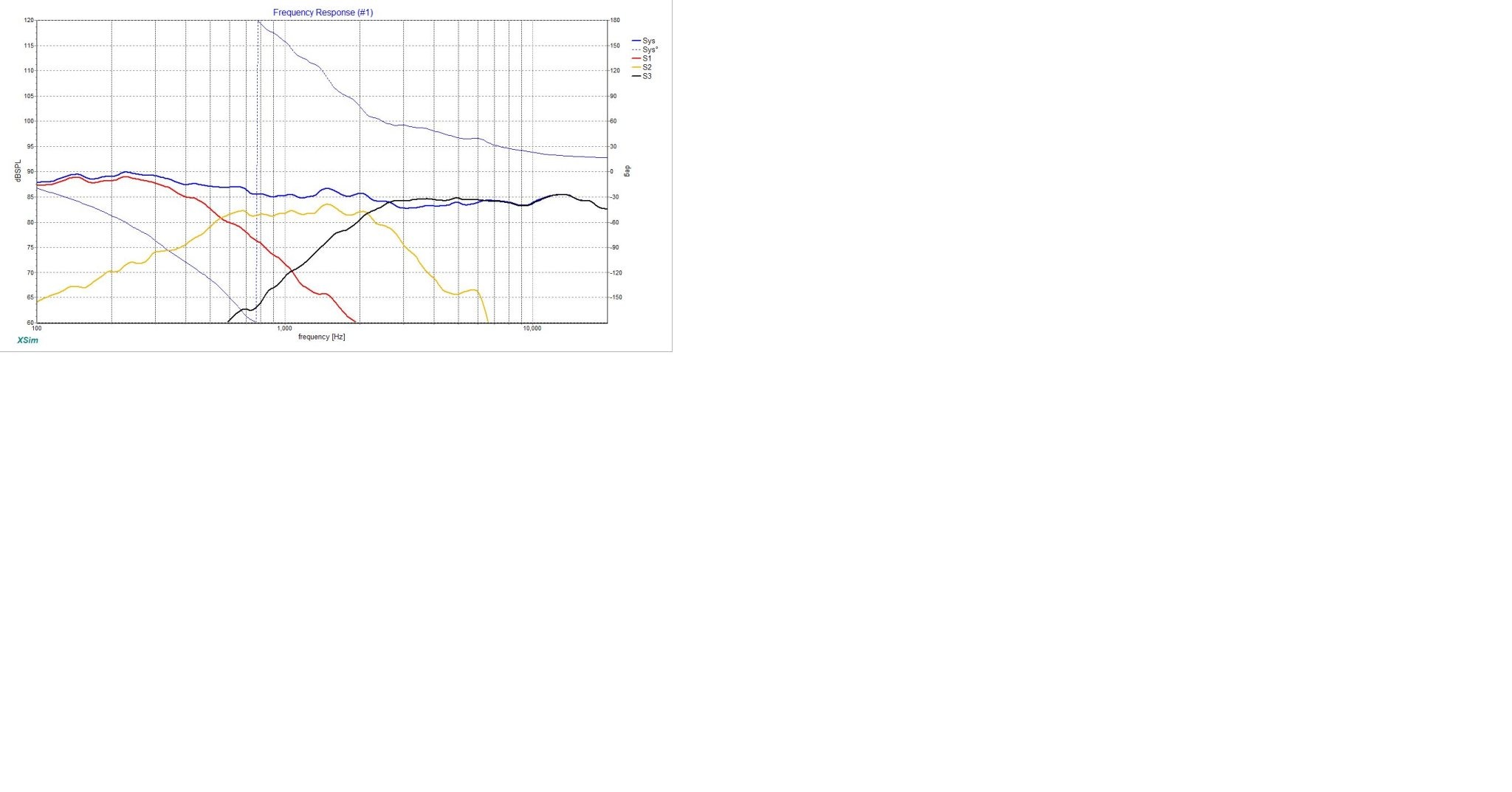

In the second graph, the blue line is the overall response, black the tweeter, orange the mid and red the woofer. You can see how the top and bottom ends of the mid are rolled off, they don't just stop producing sound.

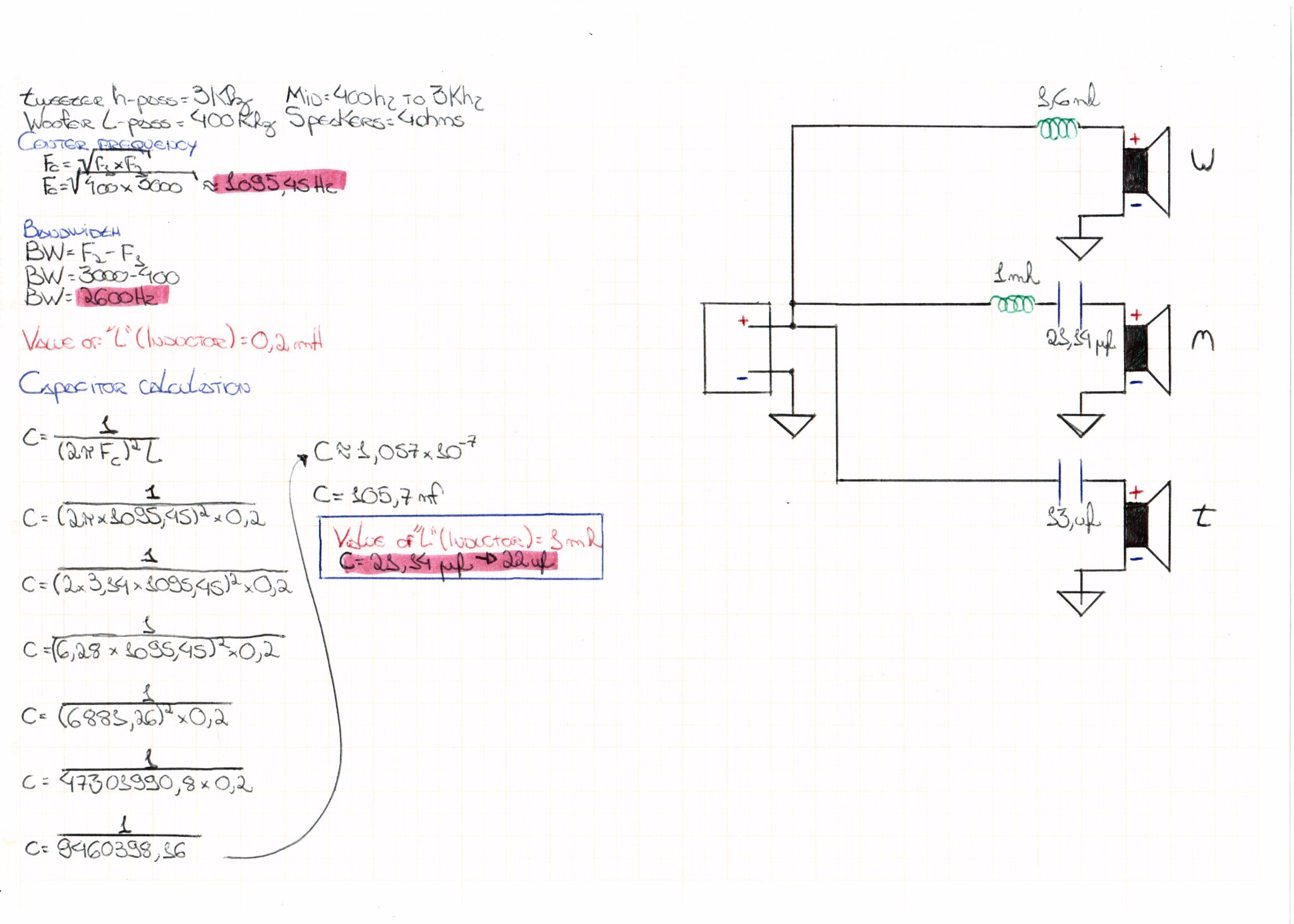

A previous post of mine was aimed at studying how to find capacitors by calculations...
I researched and researched and did the math to find the capacitor for my midrange using the 1mH inductor, I also tried with 0.2mH but I found the found value of the capacitor a bit difficult to find...
Set the cutoff frequency to 8 times that of Low-pass (400hz to 3000hz).
In reality it would be 3200hz but I didn't find any problems in rounding it to 3000hz.
The value of the average capacitor would be 21.14uf. I'm seriously thinking about getting a 22uf or 21uf capacitor, any ideas?
Did I do something wrong or is there something I can improve?
Both L (inductance) and C (capacitance) are related to load impedance. You need to search for a filter design of the high or low pass. The number of elements (L's and C's) depends on the slope of the filter and their values upon rhe kind of filter (Tchevishev, Butterworth, Bessel, etc.). Each one has its own pros and cons and it's your decision to choice one. There are online filter calculators too.

Don't buy any components yet. It will be a disappointment.
You really need to get a simulation tool and use real impedance curves and the planned enclosure.
A complete package would be vituixcad or (much simpler and less powerful) boxsim. Both free for private users.
Edit: the problem with your calculation is that you assume 4 ohms for all speakers at all frequencies. That is far from reality. 4 ohm is just the nominal value.
Therefore your calculated values will be far off.
Also you need to consider the influence of driver frequency responses and the baffle.
