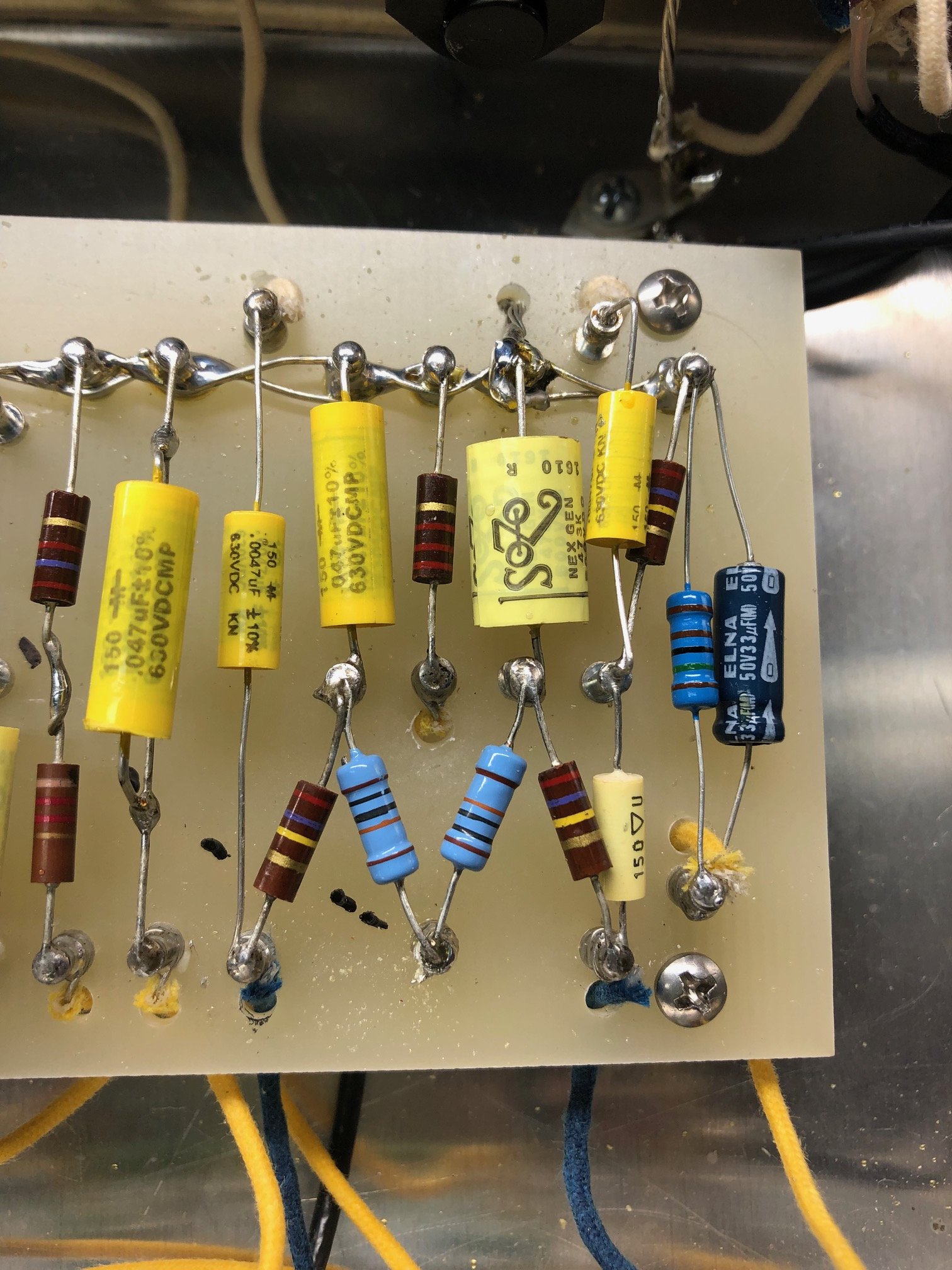

I need some help solving Issues with my new Supro S-6424 build
I started the amp up and recorded the voltages and changes are indicated on the attached schematic.
The channel connected to V1 pin 2 works normally and sounds good.
The channel connected to V1 pin 7 is producing very little gain. ( resolved tone control has to be turned up)
The tremolo circuit is not working. I used a 500K pot with a turn-on switch, and I am not sure if it is connected correctly ( the on-off part).
Also, can someone explain the 100-volt difference in the V1 plate voltages (pin 6 at 145vdc and pin 1
255vdc)?
The handwritten numbers are mine. The printed numbers are Steve Luckey's numbers using a different PT.
I have a series of high-rez photos of the amp if needed.
I have done several hours of troubleshooting without success.

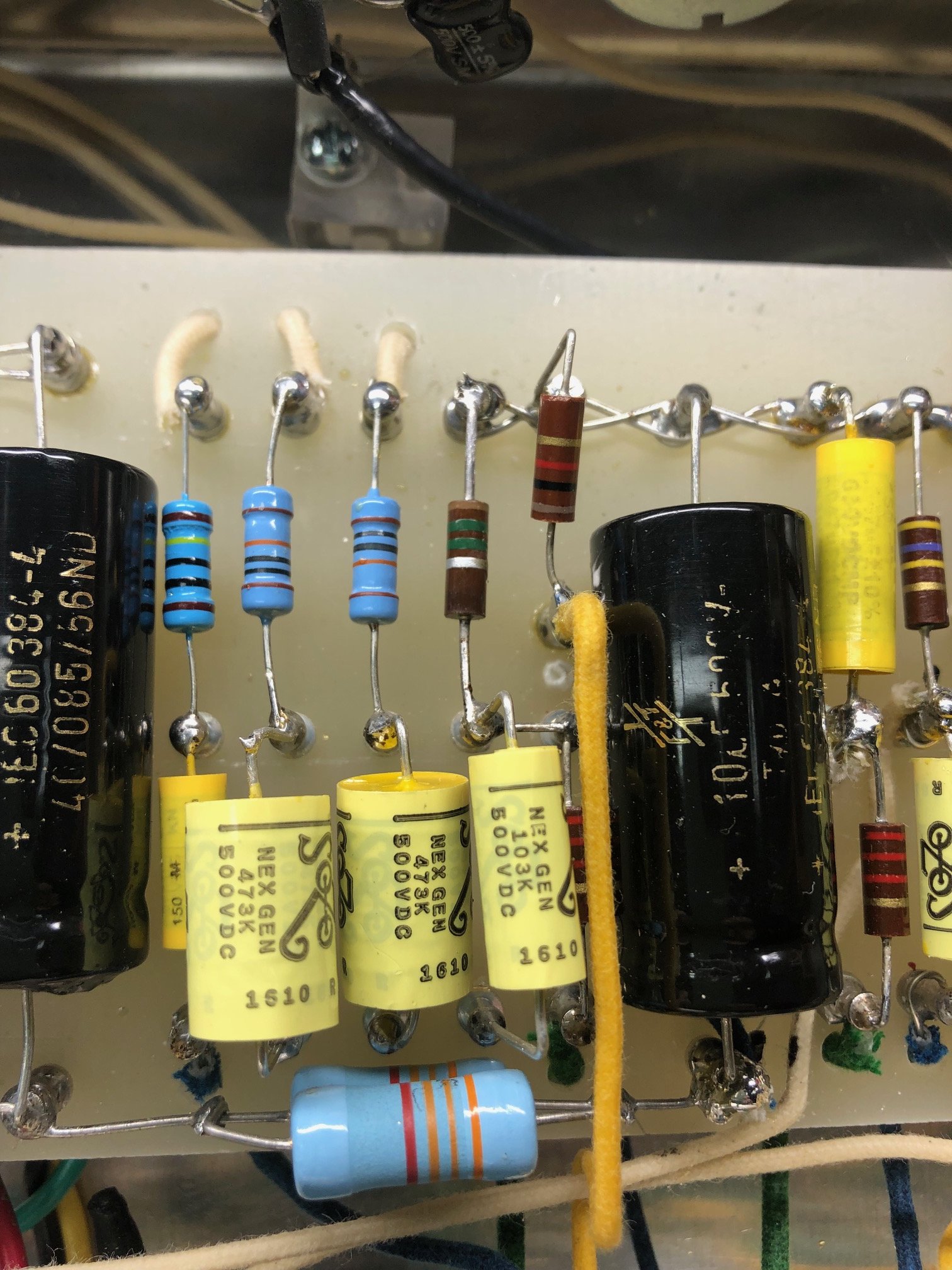

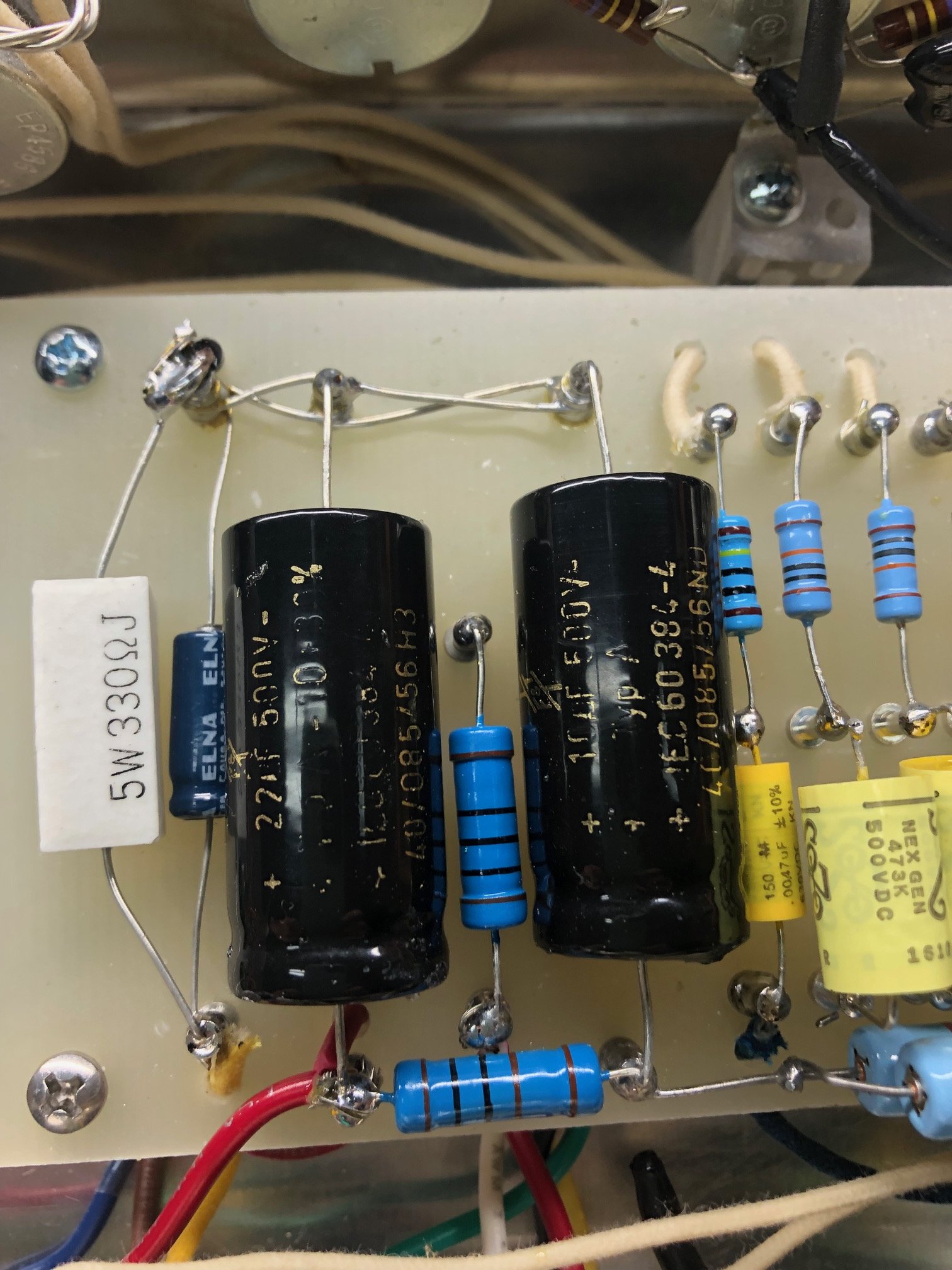

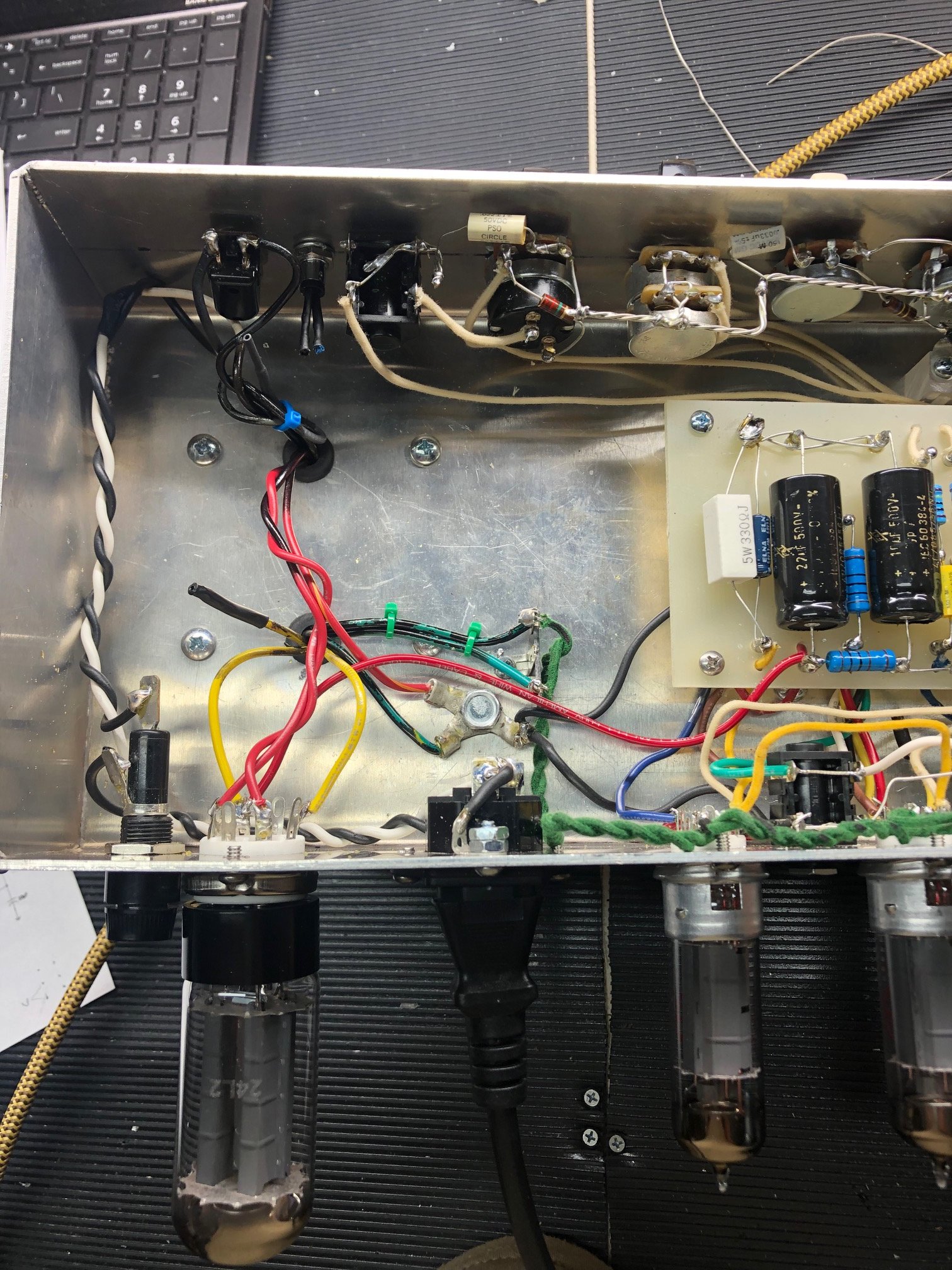

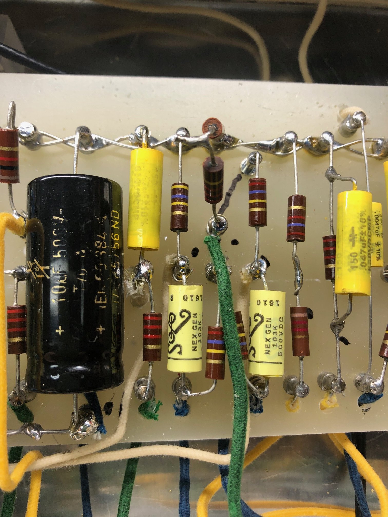

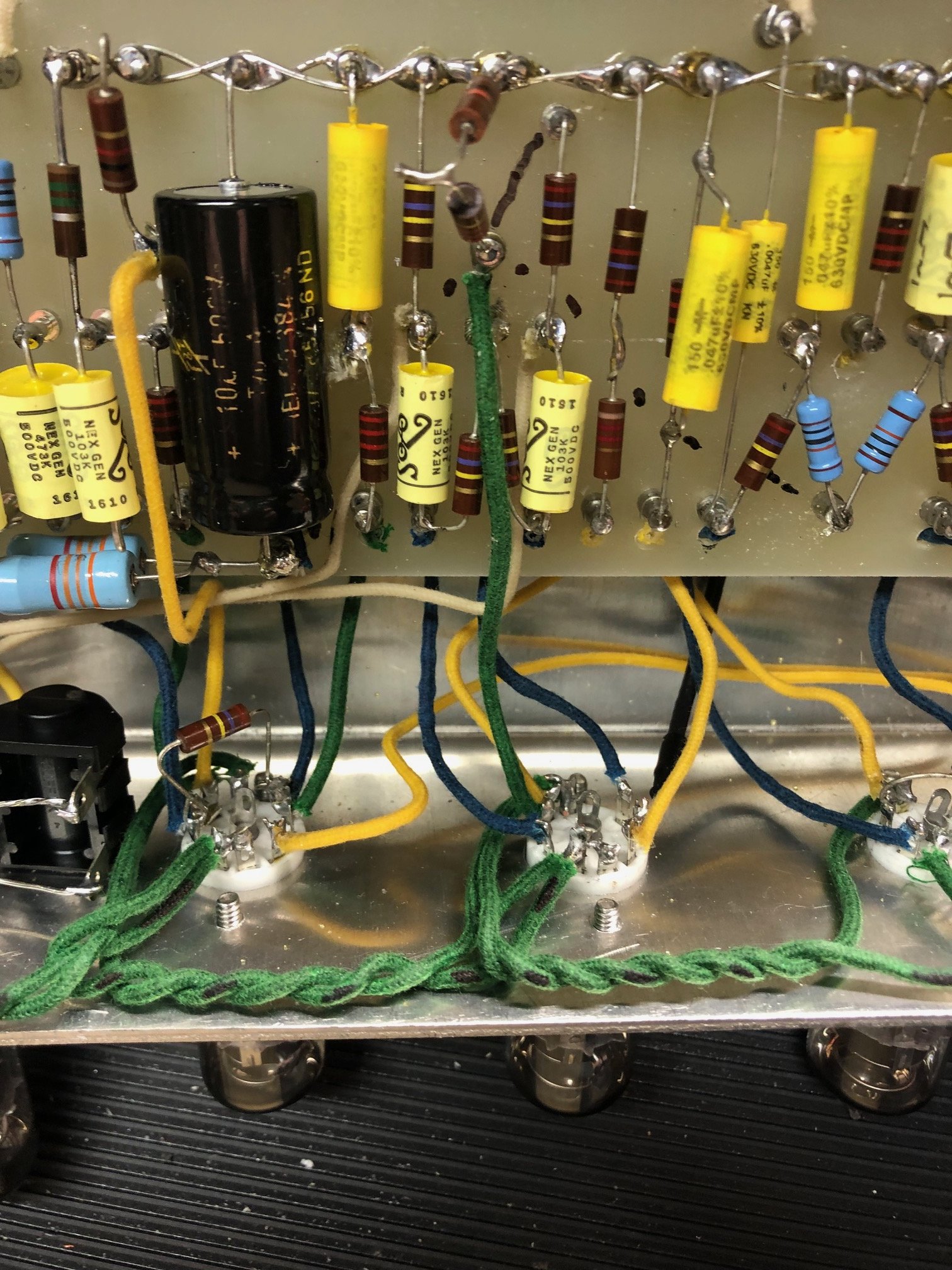

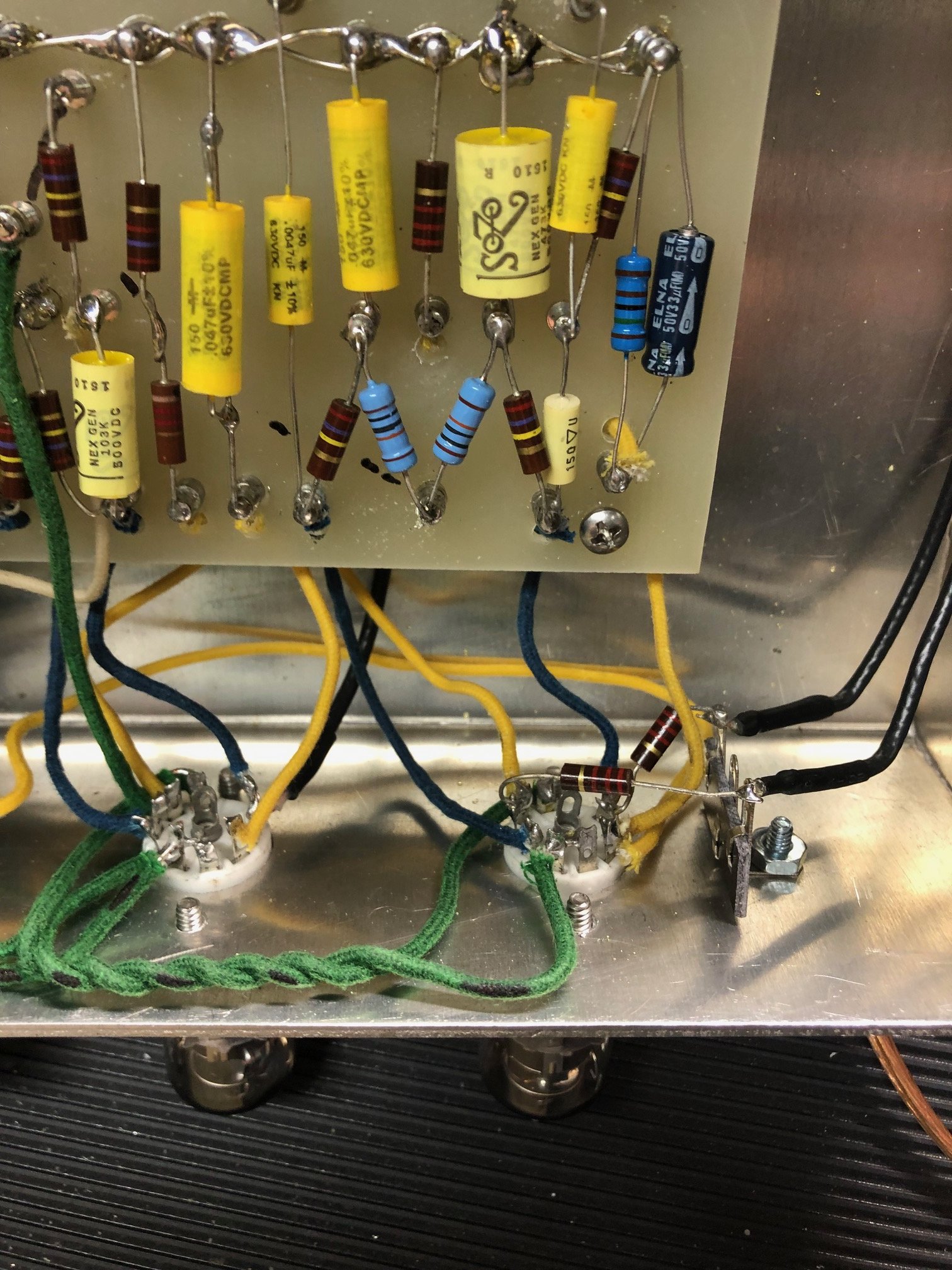

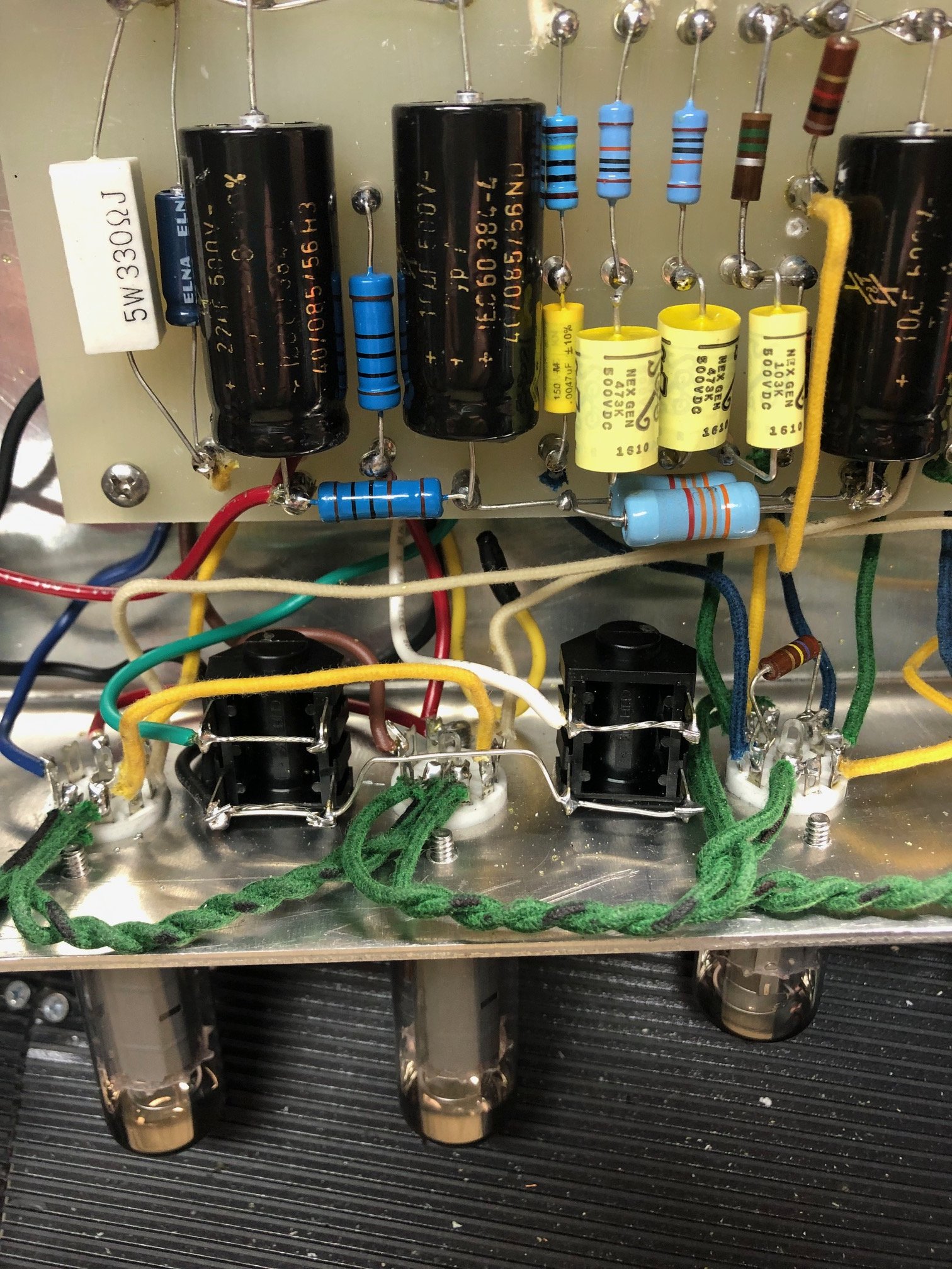

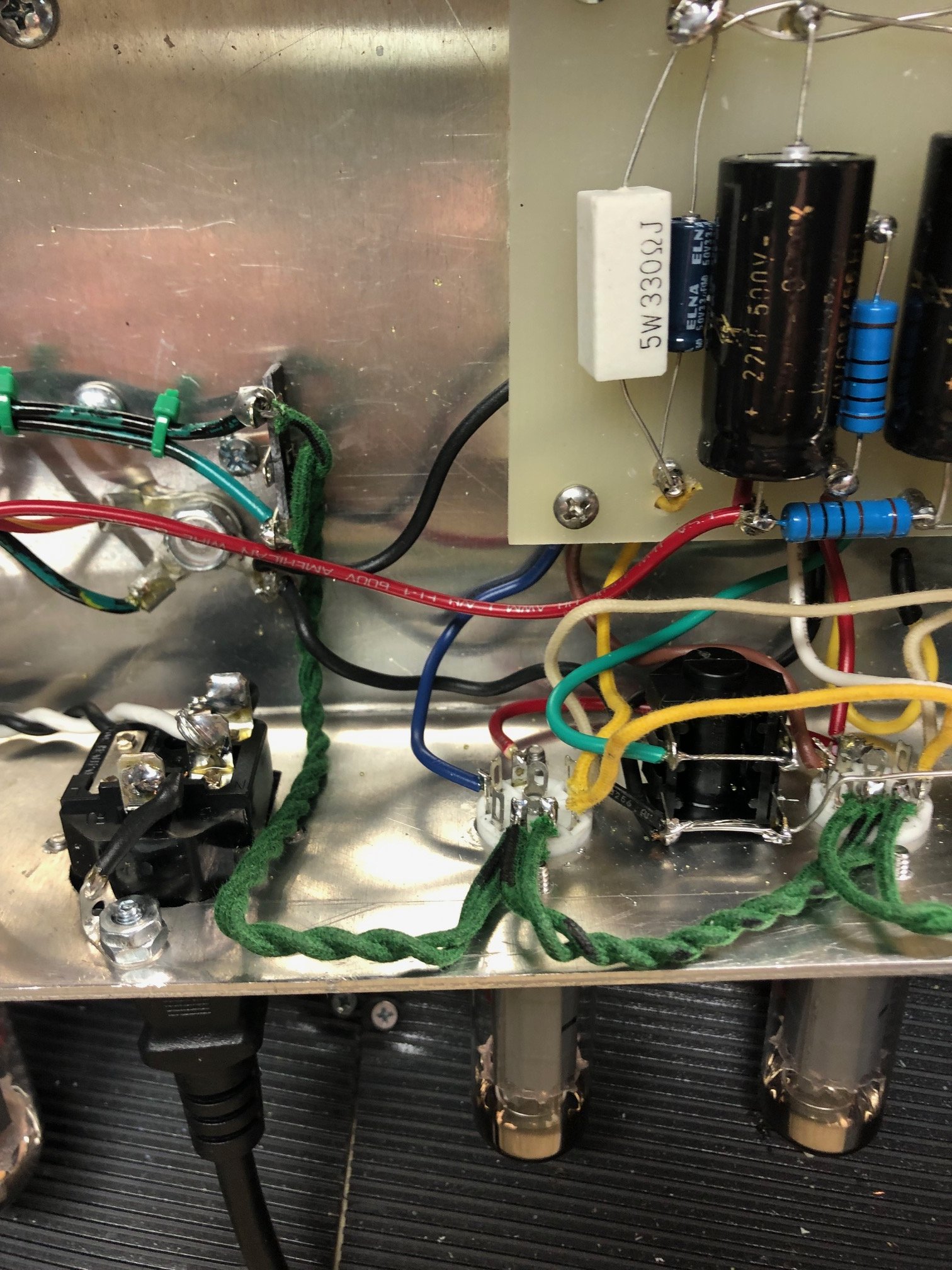

More photos

A phase shift oscillator requires a voltage gain of 29 (from memory) to start oscillation.
The 1.5 meg grid resistor provides bias for the tube when the tube oscillates.
Check the phase shift capacitors values are correct.
Jumper the cathode resistor and try as it might reduce the gain when it starts oscillating.
Regards.

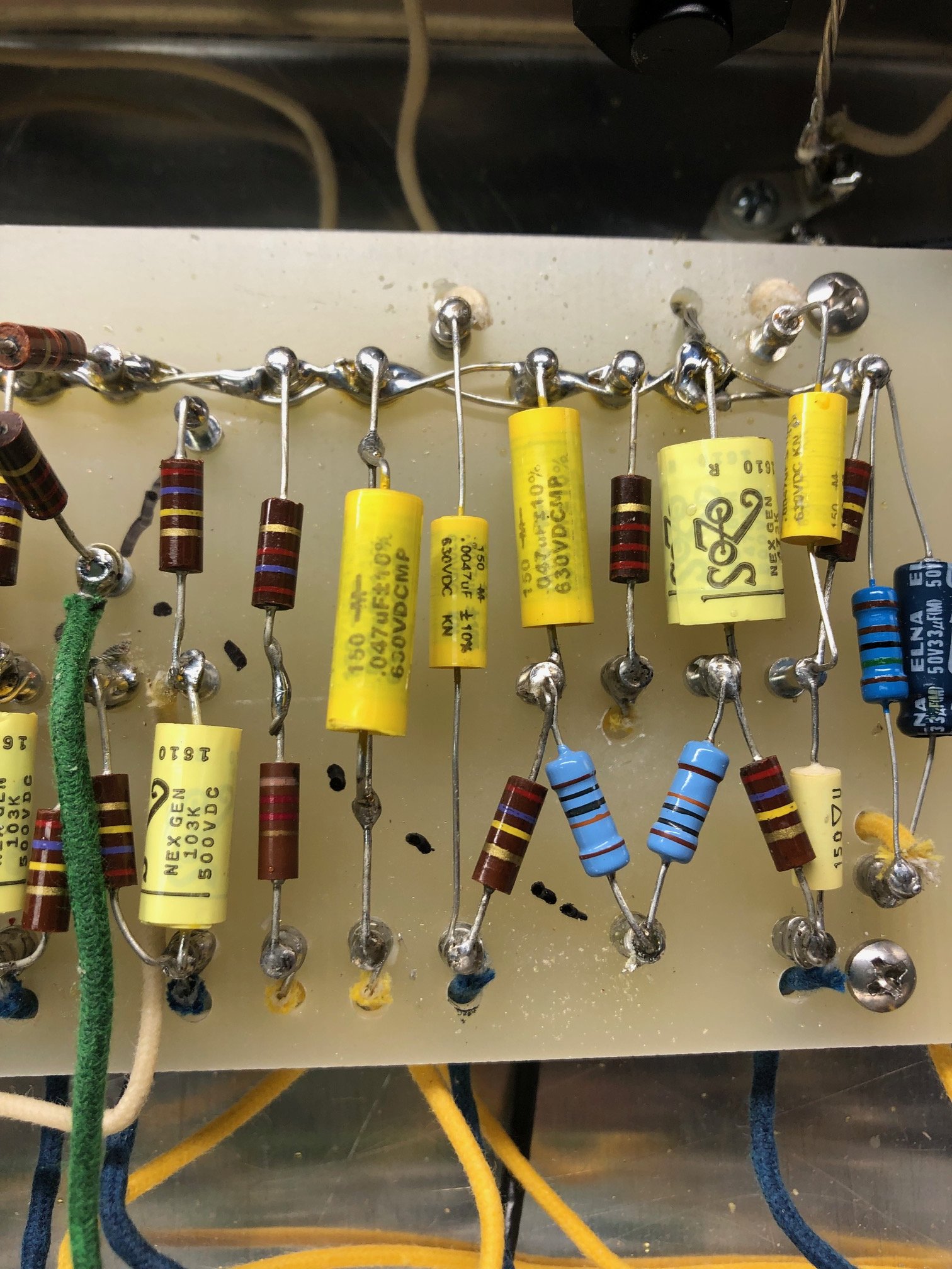

Thank you ever so much! Bad .047 cap.
To add insult to injury, I had left a short jumper wire off. When I saw that, I thought I had solved the issue ( see T2.jpg, .0047 to .047 jumper not there in the photo). Tremolo still would not work. I started checking caps and found the issue based on what you said.
