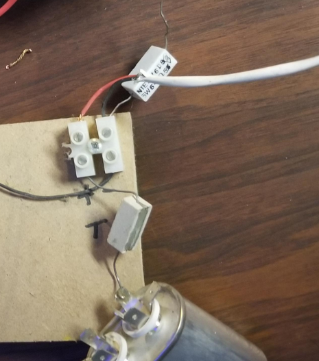

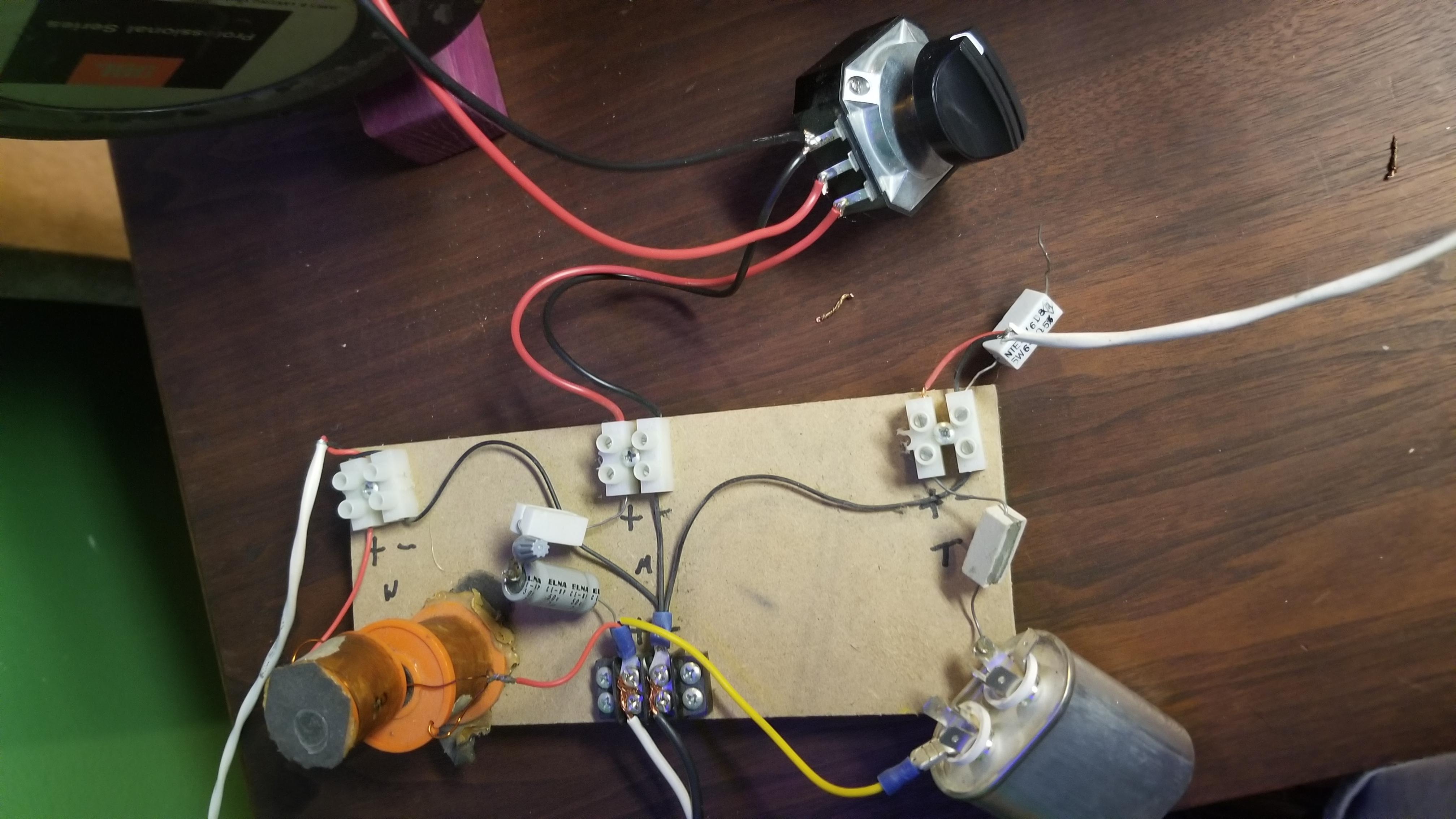

I am very satisfied with these in their current configuration just think it's time to build the crossovers they deserve. I'm not looking to change the components.
I am not going to give up. Third order tweeter xover helps low frequency from harm to the tweeter better than first order. I depends on xover Hz, tweeter design, and SPL output if needed or not.
Your use of resistors to pad down mid/tweeter is a choice, I use/prefer autotransformers for this in my crossovers. But the way you appear to use the resistors bungles up the capacitors value for blocking low frequencies.
in the schematic the caps show as polarized but I've never seen a polarized cap in a crossover.
