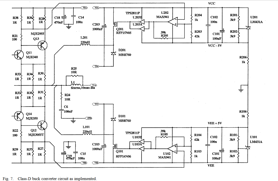

...What do you think about this? Of course, some "internal" delay is needed I suppose...

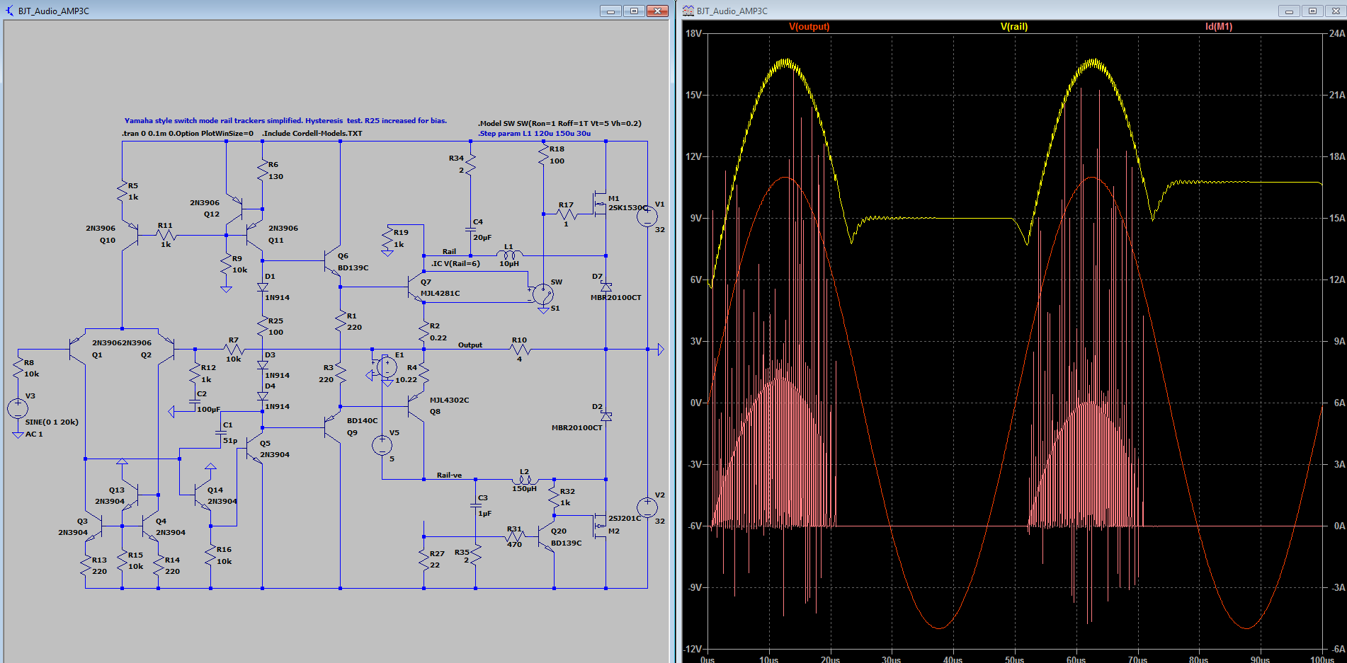

Your explanation is not quite correct for the Yamaha circuit.
That circuit uses some hysteresis in the loop and works fine even with no delay.
The problem is that the hysteresis is not very well defined, seems to depend on the Early effect in the MOSFET driver, if I understand it correctly.
If we eliminate the hysteresis then the self oscillation is determined by the phase shift (and delay) around the loop, like the Putzeys' circuit.
I tried to do a demonstration circuit that uses the well defined hysteresis of the Spice controlled switch, the SW component.
This should show the hysteresis effect very clearly but there is some sort of calculation problem with LTSpice - many anomalous current spikes.
I have seen this before but never worked out the exact cause or the correct fix, maybe needs some parameter set.
The correct behaviour is visible as the sine shaped outline.
You know how to fix this?
In the mean time I will try to do an actual circuit.

Can you explain a bit more? How Early effect causes hysteresis in a circuit?The problem is that the hysteresis is not very well defined, seems to depend on the Early effect in the MOSFET driver
Can you post a ASC file?This should show the hysteresis effect very clearly but there is some sort of calculation problem with LTSpice - many anomalous current spikes.
The correct behavior is visible as the sine shaped outline.
I was mistaken. I will have to study this more.
Sure. The current spikes are from the Schottky diode.
Maybe I should say "thru" the Schottky diode.
Drawn from the capacitance of the FET by the instantaneous closure of the switch I suspect.
I am out of practice with LTSpice but it starts to come back.
Best wishes
David

OK, I did more sims and came to the conclusion that a hysteresis circuit is sub-optimal for a wide band amp.
Not really a surprise, Bruno Putzeys is no fool.
For a sub woofer application like this it works fine, but it looks possible to improve the efficiency and lower the distortion with a power supply based on UcD circuitry rather than Yamaha.
So probably no point to continue in this thread.
Thanks to the OP for the initial circuit schematic and the start of the discussion.

Just by accident I found this article on the web
(PDF) A Class B Switch-Mode Assisted Linear Amplifier
Just by accident I found this article on the web...
Useful find.
I think I had a quick look at this previously but wasn't very interested at the time because I want a serial architecture.
That way I can use the switch Mosfets as protection for the output transistors from short circuits and also protect the speakers from output transistor failures.
All with no extra components or speaker protection relays.
But I should have looked more closely because the circuit is useful to show their implementation of low-side Mosfet drivers and comparators.
So thanks.
