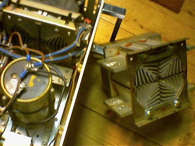

Last picture for those of you that don't know such a cool(ing?)-tunnel. I have another one on stock, but that one is for 8 TO3's.
The four heatsinks are isolated from frame, so you dont need isolators between the transistors and the metal (at least not in the 4 TO version, here it's two TO3's per heatsink).

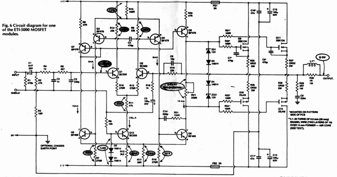

I built my first amp; ETI-5000 in 1983.
-just found a copy of the article, will scan it, if anybody is interested.

Question for all: how far can i get if i use that cooling-tunnel with a quiet fan (or run a normal fan at reduced revs). Any good for a livingroom amp? The papst fan in the amp is not quiet:clown:
Guido,
there is a heatsink excel calculator to download on one of the threads. Rod Elliot has a simpler one at his site.
Depending on the geometry of the heatsink the maximum obtainably with a cooling duct is a reduction of the static heat resistance of 1 : 6.
The parameters to obtain that are:
blank heatsinks, no air gaps in the cooling duct, high air velocity,
no laminair flows but pure turbulent.
With average heatsinks and normal fans it reduces to 1 : 3.
I did fluid flows and heat transfer colleges at Delft polytech, at the time i experimented some with heatsinks, ducts, and vents
for the fun and to see how far i could go with a class A amplifier and a cooling duct.
If you like to estimate it more accurately, there is a graph for thermal resistance versus air velocity here somewhere too.
Some time ago i bought 20 new alloy Papst 30dBA vents for $5
the piece.
With reduced air velocity that vent is hardly noticeable, and lasts a century.

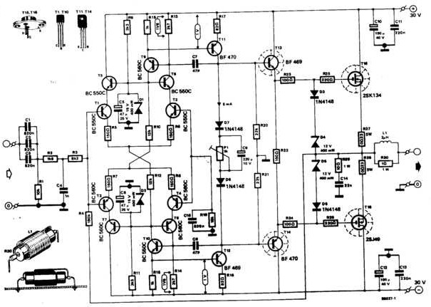

Here is the AXL.
This one i built, using the 135/50.
Intended for 60% class A at 30V or in AB at 45V.
I added two Mosfets, with 1.8A bias at 30V it did 25 watts class A both in 8 and in 4 Ohm like the ML2.
Before building it in a chassis i had it on a wooden panel with dual powersupplies.
Switching from one channel in class A to the second in AB with a relay enabled me to compare.
First time i noticed Mosfets sound cold and hard in AB, warm and soft in class A, by the end of the 80s opamp/mosfet designs made this even more apparent.

jmateus said:
How was the quality compared to the Crescendo?
Sorry for answering this late.
I never liked the Crescendo, when it had just come out i thought about building it for my first diy preamp, but was advised not by my DIY buddy, a professional electronic with absolute hearing and 25 years more age and experience.
The AXL was quite good then i think, later i tried the 1985 RadioBulletin's 20 watt class A, it outperformed the AXL.
The 20-watter was designed by Menno van der Veen, now the transformer guru at Plitron and Amplimo.
The 20 watt class A is easy to find on the web.
I still think they are both worth the build because they were cheap and easy to build, Hitachi Mosfets were the easiest to buy power devices in the '80s.
My friend gave me 2 Toroidal transformers for no charge, in the 1980s i was a poor polytech student.
At the time i had to use autocad R10 to R13 to design PCB's, Xeroxing the layout on transparents or PCB-foil was easier.
The Crescendo i would not recommend, many state that it was notorious to oscillate, in '82 it was one of the few high-power DIY designs.
Its successor seems to be a lot better, after trying the 1st edition i never bothered.
I do not dare recommending it with the JLH on this forum.
But if, like me, you still have some Hitachi 48/49/50/133/134/135
Mosfets, it is fun to try them.

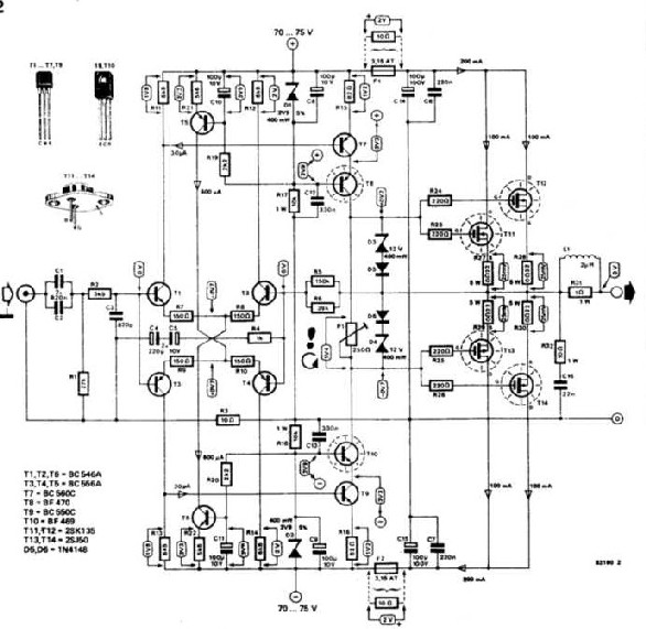

Please help...post mar 85 - AXL with 2SK134/2SJ49
jacco.... please post mar 85 - AXL with 2SK134/2SJ49, schematic and pcb (if possible). I have built my AXL in 1997, and now it has problem with the 100mfd electrolit capacitor. It just blew...and I am afraid there's something wrong with other circuit parts. Unfortunately, I lost my magazine. Please help me out....my mail is ynotthea@yahoo.com
thanks in advance
tony

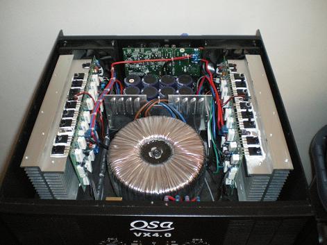

I builld 2007 in chinese Factory 20 pcs. Elektor Crescendo Amp for PA with IRFP9240 /IRFP240 Mosfets.
The Sound from Crescendo is more warm and natural
The mosfet amp is working very stable, but the sound from Class D is more powerful in bass and clear in High Frequency.
