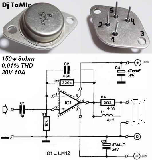

easy amp....
LM12CLK 150W R.M.S 8ohm 0.01%THD low cost 16$

I don't recommend the LM12; it will be difficult finding sockets for it. An LM3886-type solution as recommended earlier is much easier to deal with. A PCB is available at the aforementioned site.
