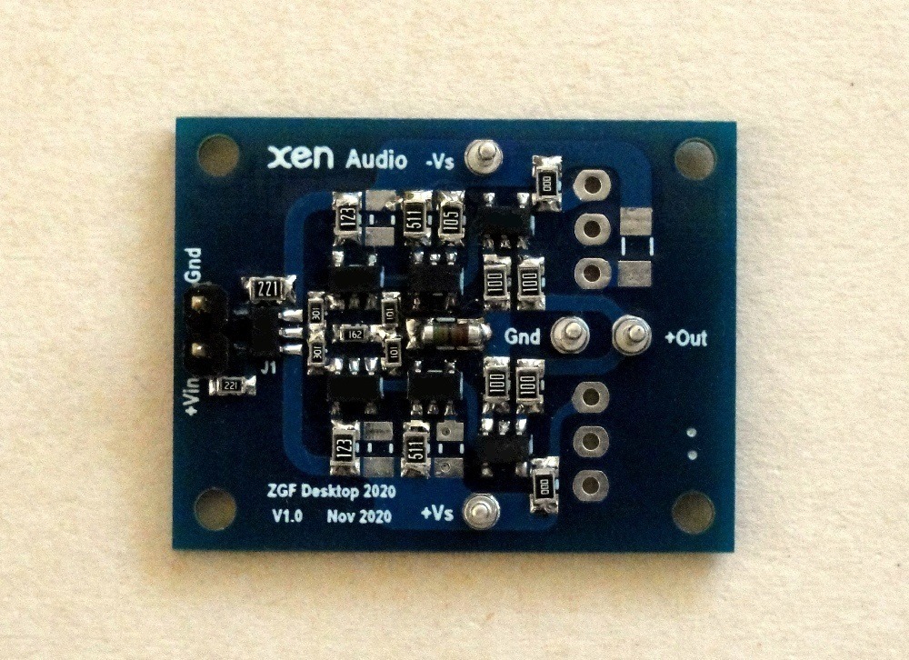

This will be fun.This also makes a pretty decent front end for all those follower output stages we play with, as it will swing about 45 volts
BT
Now we’re talking…This also makes a pretty decent front end for all those follower output stages we play with, as it will swing about 45 volts.
I am so happy to hear this, I just have urgent need for a small good pre!No problems. Mine is just a simple little minimalist circuit with 4 jfets and a bipolar. The board has pinouts for 2sk170 or J113 input devices, but comes with the J113's It should sell for about $10 in the store. Full info at BAF...
Hi Patrick, did you publish this one?I also happen to have one, only one SMD Toshiba dual JFET (still active at Mouser / DK).
Else all low-noise Toshiba SMD BJTs.
Zero global feedback, stable with any gain, very low noise and distortion.
Can drive 32 ohm headphone also by adding 2x TO220 devices.
Probably not as cheap as Nelson's, but no NOS unobtainiums.
Patrick

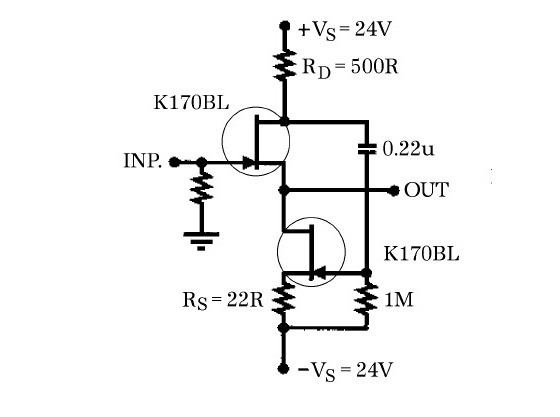

Yes, but what for 2SJ74 at Mouser ??You can build a simple JFET buffer with a single piece of 2SK2145.
Less than 1€ at Mouser.
Patrick
Even White Follower is possible.
