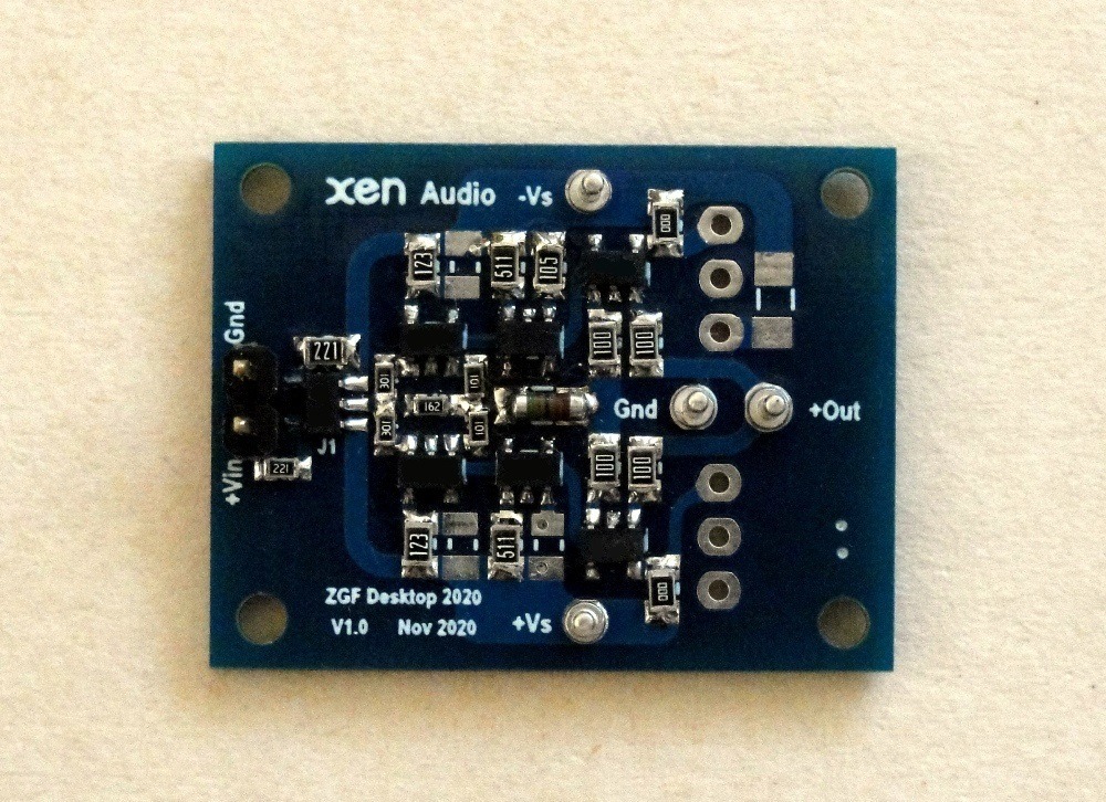

I also happen to have one, only one SMD Toshiba dual JFET (still active at Mouser / DK).
Else all low-noise Toshiba SMD BJTs.
Zero global feedback, stable with any gain, very low noise and distortion.
Can drive 32 ohm headphone also by adding 2x TO220 devices.
Probably not as cheap as Nelson's, but no NOS unobtainiums.

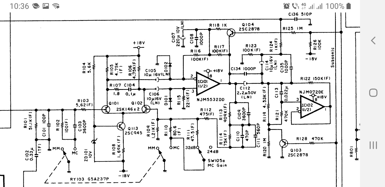

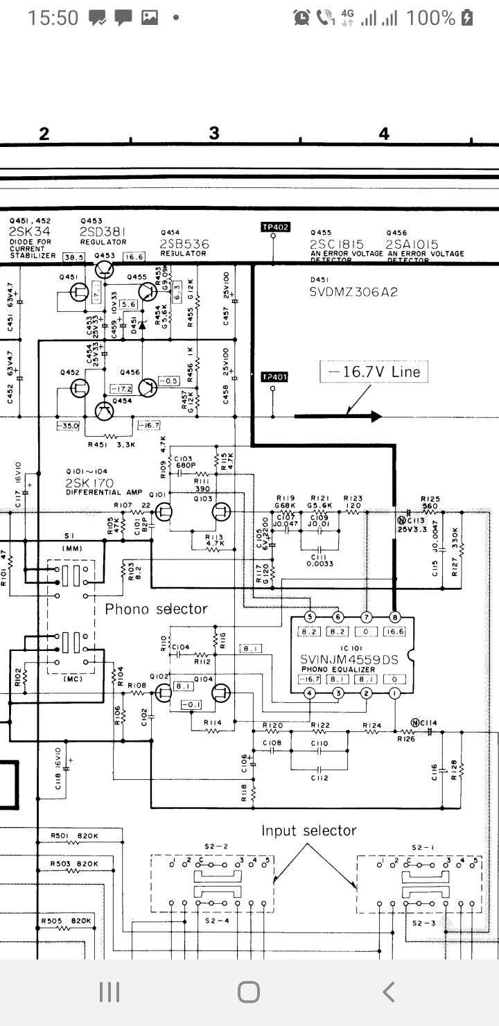

Your tape preamp probably has NAB correction...for vinyl you need RIAA eq correction.
It looks like you need a jfet input phono preamp set for high mc input with the loading capacitor and resistor for mc carts removed and the rc loading for mm carts active.The specs of your cart show a loading of 10k..47k and they say it's unsensitive to capacitive loading which I kinda doubt because of the 5mH cart's inductance so better remove that rc loading for mc carts,leave just the standard 100pF...47k in place.

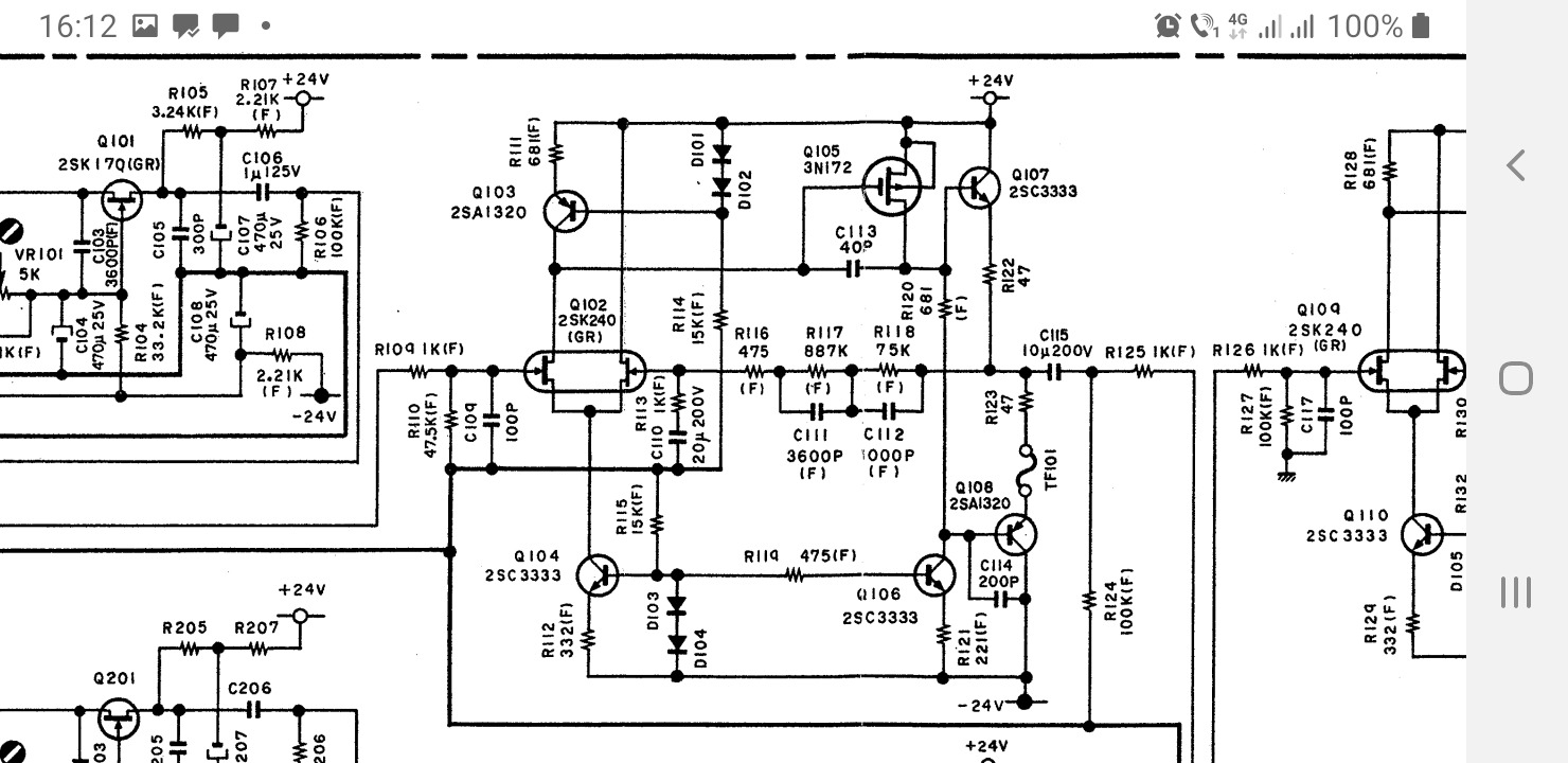

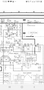

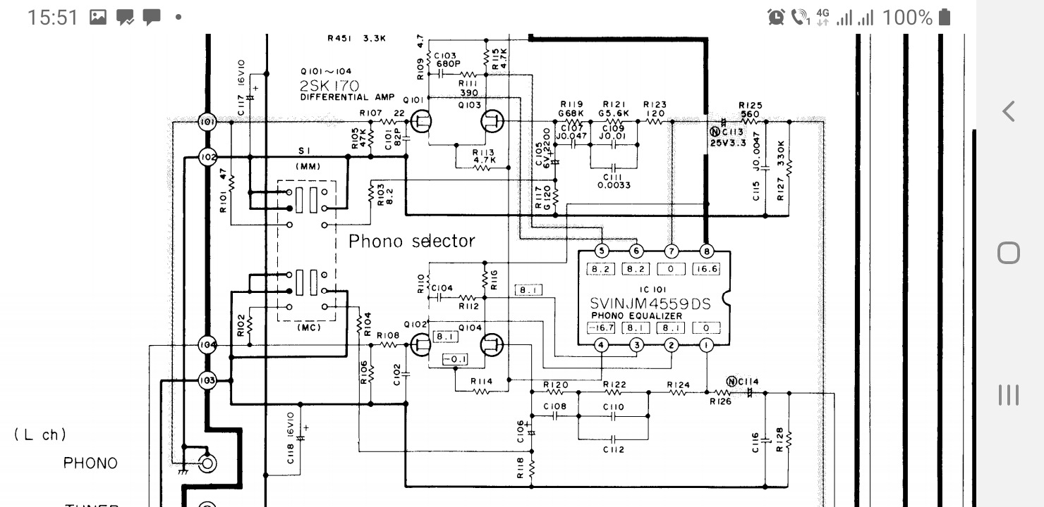

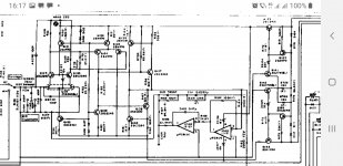

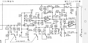

Tons of schematics outhere.Try the first one with C103 and R102 removed.This is the phono input of Nakamichi SR4A. Next two pictures are Technics su v6.Just look for any jfet input mc cart phono preamp schematic and remove the input loading for mc, but use the loading for mm carts instead.

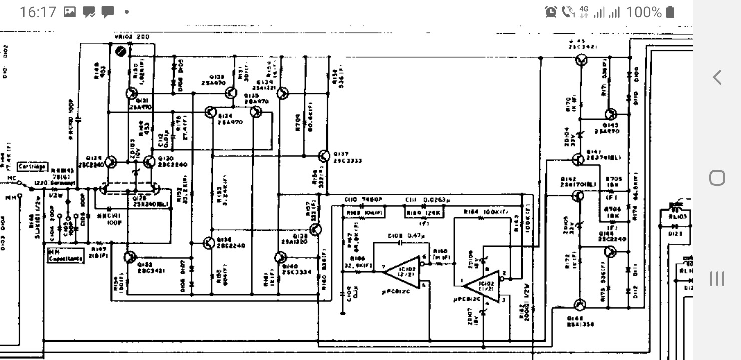

Oh...I didn't realize it's NP corner...I promissed once to stay away from this place cause mortals can't deal with immortals. Then I should probably recommend its own designs from Nakamichi CA5E where you change C110 with 220...2200uF and R113 with 100... 220 ohms.I said once that the CA5 must be a genious design...didn't know at the time it was NP's.
There's also the CA7 mm input stage, but I can't see a clear schematic in my download manual...
I'm sorry @ Nelson Pass! It wasn't in my intention to do any harm :) I'd be really greatful though if I'd be able to see a clear schematic of CA7 model.
