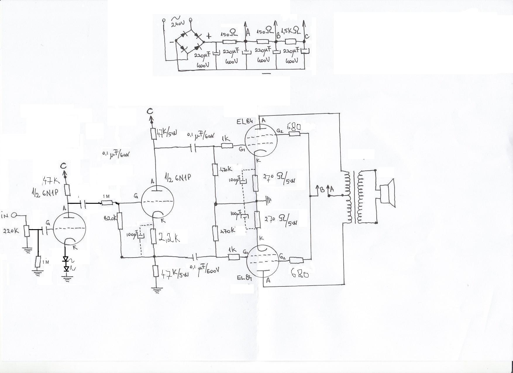

This is the current scheme I use now. I biased the preamp stage with 2 leds. have a total of 3.5V drop. Hope I solve the problem for the distorsion or else I'll try another kind of preamp stage.

I see a couple of problems with that last schematic right off the bat. The 1 Meg grid leak resistor on the input stage is on the wrong side of the input capacitor. There is no ground reference for the tube which is a really bad thing. Also it is too large. According to the data sheet I have the grid circuit resistance should be a maximum of 500K. I would go lower than that to give some wiggle room.
The 1M feeding the cathodyne is not needed, I would remove it. Where did it come from? Also the grid leak resistor of 820K on the cathodyne is too large as mashaffer pointed out. After fixing those things, and you still get distortion at low listening levels, I would try a different speaker or a different sound source.
I put that as a large grid stopper after I red the "Grid-Stoppers and Miller Capacitance" chapter from valvewizzard. I removed it also I adjusted the 820k resistor. I get the same distorsion at more than 2'oclock of the knob from the audio card. The pot from the amp is at max anyway. I wanted to have a clean sound with everything at max. The audio card was pretty expensive and I know it is very good, as well the speakers are Technics with low at 120W(music power) as it is written on the back of it. Maybe Ill wait for the new driver and see then how it performs. Untill then I'll turn down the volume a bit until it is clear. Thank you very much for your help!

Actually, a grid stopper IS a good idea, just not 1M and not on the "wrong" side. Use something like 1k, with the resistor right at the grid pin. The cathodyne grid leak then goes on the "far" side of the stopper.
More serious problem: with a pentode output stage and no feedback, the source impedance is really, really high- if your speaker is not designed for current drive, it will be quite boomy. The bass distortion will also be quite high.
damn! I drew that wrong as well :)) it was on the right side in reality but I have everything on a breadboard and when I drew it it was late night and I didn't pay very much attention. I'll put a 1k resistor just to be sure. After I detached from the details I realized that the sound has been very much improved since the beginning :) and the distorsion is present for all audio range, everything distorts at max level but I will better try with a good speaker. Any suggestions? I am willing to pay max 200$ for one fullrange speaker. I was thinking at a Fostex FE206EN but if you have better ideas please do not hesitate. Thank you very much for all your help, I learnt alot from this, and I am very proud to declare this my very first audio amplifier (and it is on tubes too :D )
