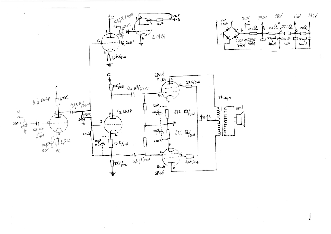

I started from a small scheme of only 1 6n1p tube as phase inverter and 2 el84 output tubes and I ended up with a 9 tube stereo amp 😱
Ok, so I opted for a 6n6p preamp stage, each triode for a channel, next stage is the phase inverting stage, one triode from 6n1p I use for driver of the 2 el84 output tubes, and the other triode for the EM84 meter tube. The input tranny is a toroidal 220V in with 3 secondaries: one of 240V with 400mA for the amp itself and 2 of 6.3 each 6A for the filaments. I opted for a DIY scheme that someone helped me with. The output trannys are made custom from a friend, each 15W output 6k6 impedance for 8 ohm speakers. They are very good built, many dudes used his transformers and were very happy. I attached the scheme below with the details. I must note that I am a beginner, this is my first project and it turned out real nice despite my expectations 😀 The sound is clear and just perfect. The downside are my speakers. They are bi-amped, no internal crossover. So I had to make a bridge to get full range. Problem is that low is 8 ohm and mid+high are 6ohm. Anyway the output transformer is quite cold, sound is clean so I don't worry. Setup was not so expensive, the whole project cost me about 200$ for the electronic components the transformers and the tubes. The case is yet to come thou. Speakers are from an old Technics system with the bass speaker about 17 cm diameter, no real charm but they sound ok. So I don't worry about any damage, if anything is to happen I don't mind much, it's my first project after all 😀
Anyway, I did some measurements and, if at first with only 6n1p as driver and 2 el84 as output tubes the values I got were pretty perfect now when I added the preamp stage and em84 meters everything is kinda mixed up. I am going for 15W output per channel. The electronic components used are among the cheapest possible here, and it's only what I found in local shops. After I finish the whole thing I'm thinking of ordering some quality coupling capacitors and such. And only after that I will go for the final touch, the actual "house" for everything. I will add some measurements below:
anode of el84 has 270V and a current of 44mA.
cathode has 9V
anode of driver 6n1p has 158V on anode and draws 1.1mA. On cathode there are 40.5V
the anode of preamp 6n6p has 110V with 3,7mA current draw. on cathode I got 5.4V.
pins 7-9 for EM84 have 52V and pin 6 has 147V. it's not at brightest but I can see it. the lines are not touching in the middle, they are 1/3 of total lenght, and I only get movement at high audio level. at normal listening power they almost stand still. This would be one of my problems. The other is the power supply stage. Normally it has been designed for something else but I kept upgrading the scheme and now it isn't delivering enough juice. Not that 400mA wouldn't suffice, the are good for both channels and still got some room. But the voltages are not quite right. Between point E and A I had a choke but since I didn't find any I replaced it with a 150ohm resistor. Anyway I have no hum at all so I considered I don't need one. Now I noticed that I got 313V in the first point after the rectifier bridge so I though I could use that. That's why that's the first contact point, before A. Anyway feel free to recommend any adjustment, but mostly I would like to keep the setup this way. Only for bit adjusting of resistors and such so I get the most out of every tube. As I am aware 6n1p performs best at 200V on anode and 50V on cathode. 6n6p is arround 120-140V on anode, the EM84 needs about 250V before the resistors on 7 9 and 6 pins. And the EL84 does good at about 40-45mA current draw on anode. So ...output stage seems ok but I think I could tweak a bit the preamp and driver. As well I would like to fix the EM84. Can it be adjusted so that it moves the same at low and high volume? Thank you very much for reading my problem, home I get some answers here, seems that my dudez are either too busy or too arogant for my noob problems.

hmmmn - the opts are NOT optimal for the EL84. THey should be around 8k a-a.
THe EL84s do not have sufficient voltage across them (anode to cathode) to operate optimally. They are biased at just over -7 volts. They should be closer to -12v.
I don't think your power supply is going to get you there - you are going to need to achieve about 320V at the primary centre tap of the opt with cathode bias, or 305V if you go to fixed bias on the finals (no cathode resistors). In which case your power supply will JUST get there, maybe.
I don't think your voltage amp (6N6p) is capable of delivering the gain required to drive the cathodyne splitter to achieve full voltage swing on the EL84s. It needs to be able to put out at least 50Vpp, preferably more. In any case, at 127V on the anode at idle you are waaaay down in the non-linear area of its operating curves. Its the wrong tube for this front end duty.
I haven't looked at the set-up of the splitter because frankly, I'd ditch it and change topology to a simple 2 stage - ltp to finals.
I know this looks pretty negative but take it as a learning experience! All is not lost, and you can remodel the circuit to acheive close to what you are looking for.
There's 4 main problems in your schematic.
1. No grid leak resistor on pin 6 the 6N6P. Either fit a 500K or something from ground to pin 6, or eliminate the 0.1uF cap.
2. The 220K pot feeding the 6N1P will compromise the 6N1P's phase splitter action and is not required - eliminate it, it has no use. That 220K pot is evil in that position.
3. The other 6N1P half has no anode resistor so cannot generate an output voltage to drive the EM84.
4. The grid bias conditions for each half of the 6N1P cannot be shared, so you need a coupling cap for each to isolate the grid bias conditions for each half 6N1P. That means, the 6N1P driving the EM84 cannot share with the 6N1P driving the amp, they have different bias requirements. Use one cap to drive the lower 6N1P, and another cap to drive the other 6N1P.
I recommend using 6N1P for the first gain stage and the cathodyne phase splitter, it's a really good tube to work with and very forgiving. I would disconnect the EM84 part until you are happy with the amp, then reconnect it and go from there. You are doing a good job for your first amp, if you want to read up on some theory that is user friendly, find the valvewizard site and read up "triode gain stages".
Don't worry about voltages too much, get the circuit right first. The cathode resistors for the output tubes need to be 200 ohm plus. Don't worry about the 5K3 OPT impedance, should be fine.

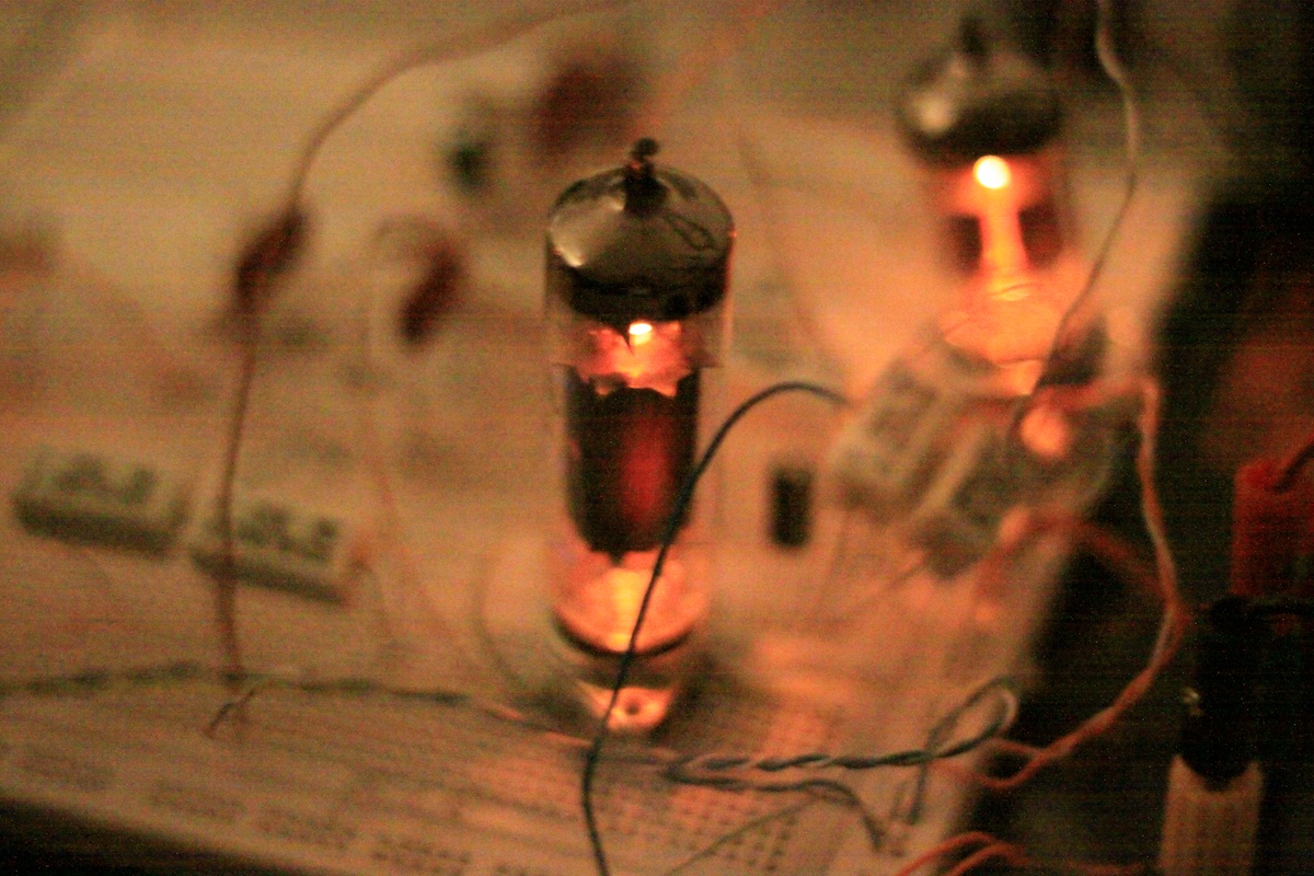

I took apart everything from the breadboard and I made the whole setup again. I attached the scheme. It's only phase inverters for El84 using one triode only from 6n1p for cathodyne phase splitter. I also changed some resistors here and there to tweak it a bit. After all was setup it ran perfect on the first try. I mean, no hum and clear music at low level. Couldn't test more because it's like 4 o'clock in the morning and I got some sensitive neigbours 🙂

So the current is 48mA for one and 49mA for the other (the one with more current has a red spot on the plate, barely noticeable but still it's there, the other one is ok. I attached a photo of the effect)

P.S. the picture of the EL84 tube is actually made in almost dark, there seems to be much more light than actually was, it was made at ISO6400 at F1.8 aperture 😀 so the spot isn't that noticeable as in the picture, it's very faint to the naked eye, the camera makes it look more...bad 🙂

The red-plate of the EL84's is controlled by the size of the EL84 cathode resistor, nothing to do with the cathodyne. With 48mA and 300V you have power dissipation of 300 x 0.048 = 14Watts, that is a bit too much. If you put in a 5W 270 ohm cathode resistor for the EL84 that would make it safe. A bigger value cathode resistor will raise the cathode voltage which means the grid bias voltage will be more negative compared to the cathode, and this will reduce the current through the valve, that is what bias does, it controls the amount of current through the valve by setting a starting point from where current can increase and decrease when music is played.
