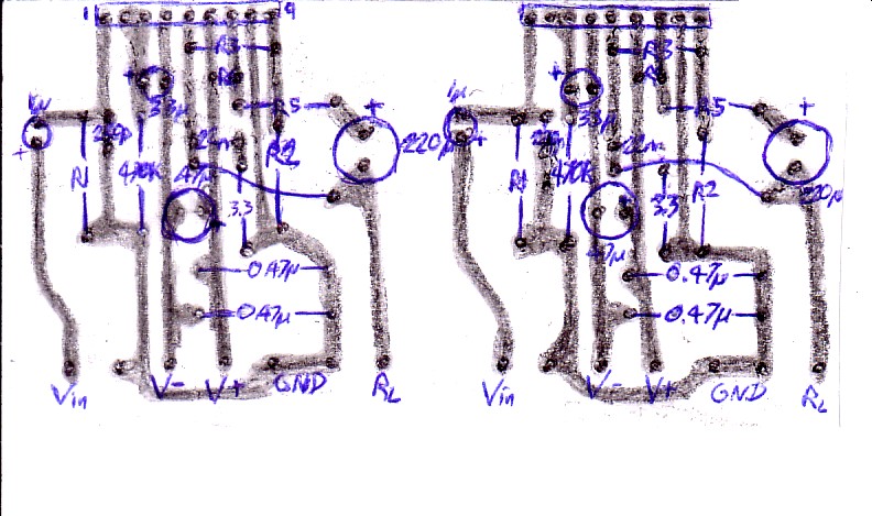

I haven't heard this particular chip in a top flight implementation (I have an old Cambridge Audio amp which uses it but that implementation sucks). Its brother and sister chips with similar internal design sound wonderful when given a decent PSU. Suggest you uprate the PSU you have on those PCBs you're showing...
Why did you choose to build an obsolete unavailable amplifier when there are thousands of available alternatives?
you means I should not make
TDA1514A?
could you devise me some available drawing?
I'm not complaining about TDA1514 *quality* which is good but its *availability*.
Make an LM3886 amp instead.
Good, cheap, lots of PCBs and kits to choose from.
And you can still use the PSU you made for TDA1514, in which case it will put out about the same power.
EDIT: you can probably use the same heatsink too, although with new holes, and of course, same case. Good
I dont like 3886 style, more interesting in PHILIPS TDA1521 and 1541.
I agree that LM3886 sound sucks in comparison to the Philips chip family (I'm playing with TDA8566). I suspect there's a sound technical reason for this - PSRR at higher freqs on the Philips chips smokes the LM.
How is TDA1514 IC's audio?
I hear from firends that's a good IC, so I start to make,
Now I am await for the TDA1514A IC, I buy from webshop.
attach the picture here.
Guaxian - are you feeding ac voltage to these boards separately, then rectifying it with those diodes to get the required dc voltage to those caps?

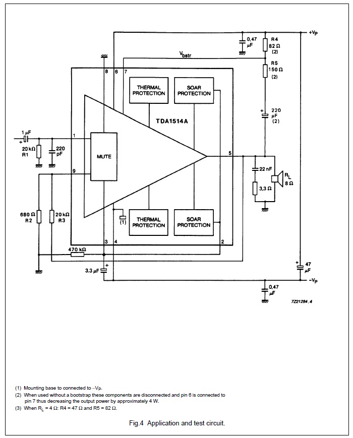

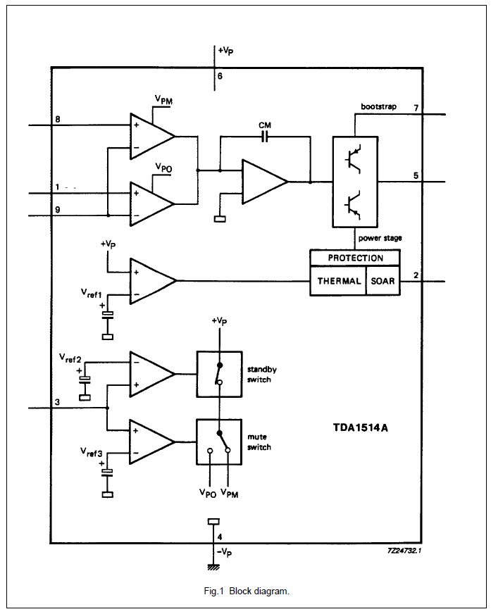

TDA1514A data sheet:
View attachment TDA1514A.pdf
GENERAL DESCRIPTION
The TDA1514A integrated circuit is a hi-fi power amplifier for use as a building block in radio, tv and other audio applications. The high performance of the IC meets the requirements of digital sources (e.g. Compact Disc equipment). The circuit is totally protected, the two output transistors both having thermal and SOAR protection (see Fig.3). The circuit also has a mute function that can be arranged for a period after power-on with a delay time fixed by external components. The device is intended for symmetrical power supplies but an asymmetrical supply may also be used.

TDA1514A block diagram:
TDA1514A app and test circ:
Circuits on the web:

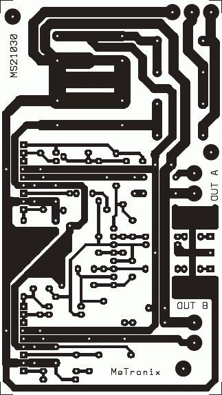

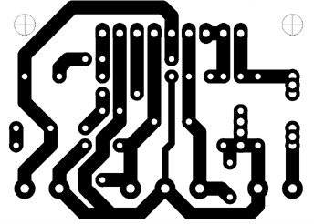

Layouts:
https://sites.google.com/site/amplificatoare/50w-audio-power-amplifier-with-ic-tda1514a
Layout:
50W Amplifier Kit Project based TDA1514A « Audio Amplifier Circuit
Layout:
50W Hi-Fi Stereo Power Amplifier Project with IC TDA1514A | DIY Electronic Easy
Layout:
