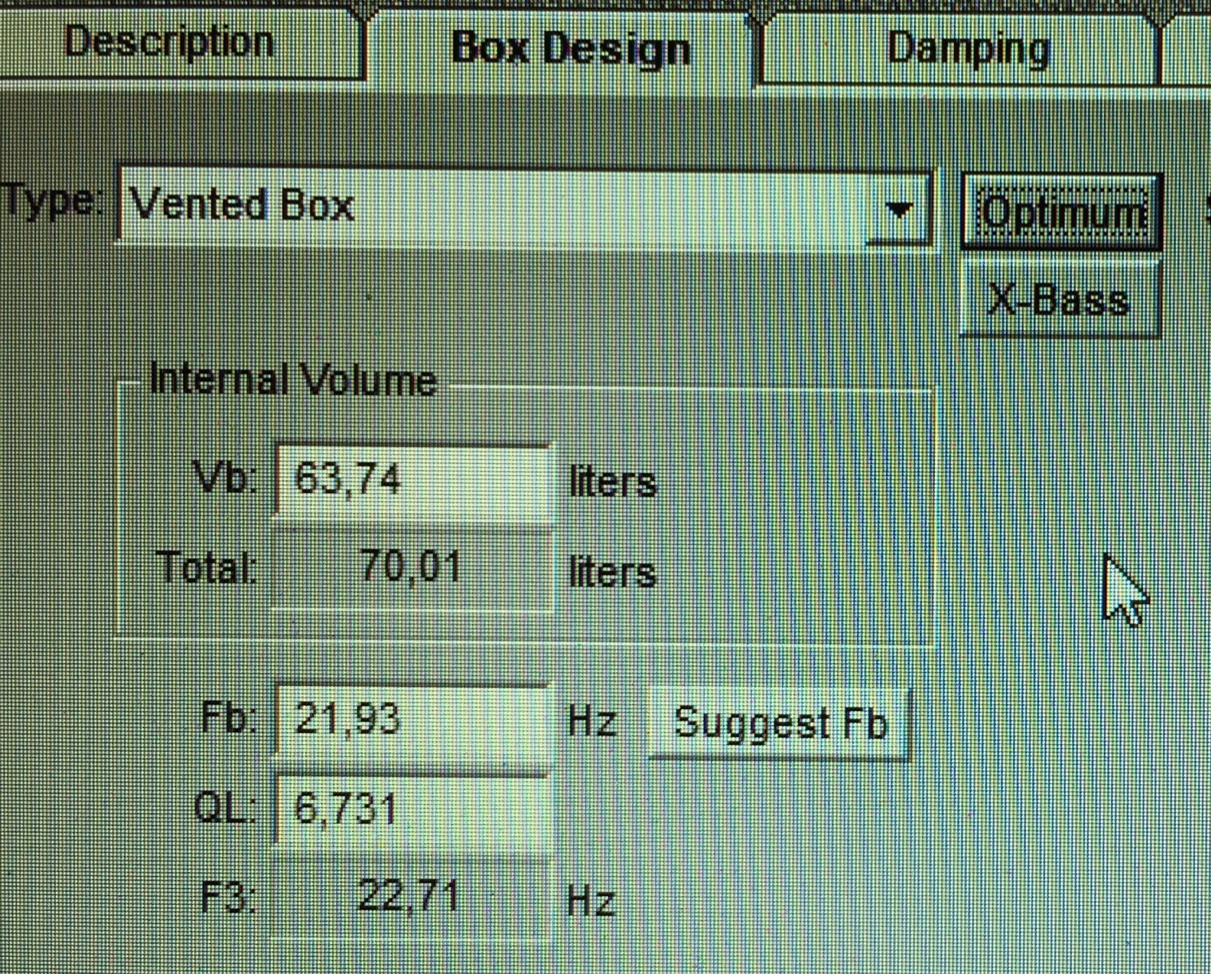

Dayton Audio rss265hf 4-ohm

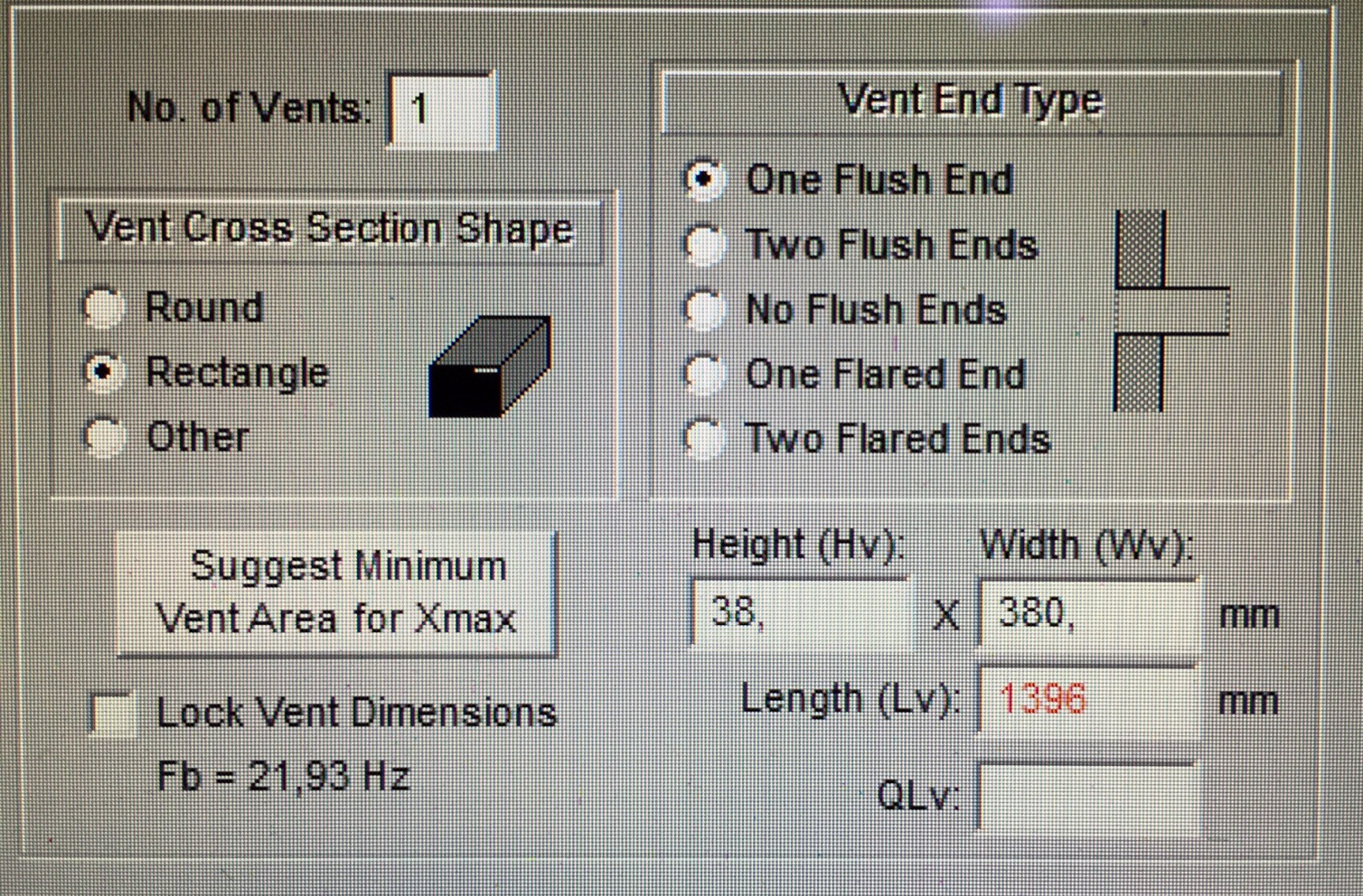

My box is
Net volume (gross minus driver, port, and bracing) 2.5 ft^3.
The port is 1.5"H x 14.5"W x 33.5"L for a tuning of 25Hz and max port velocity of 20 m/s at 22.5Hz.

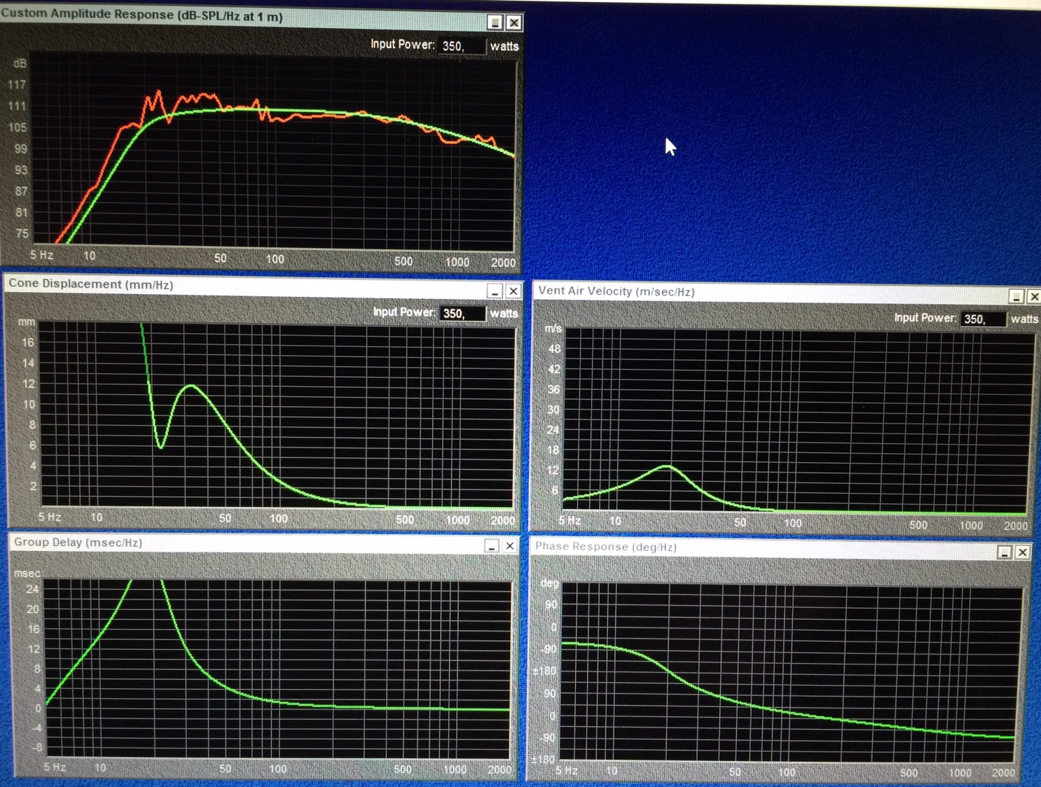

WinISP shows a flat 110dB down to 25Hz and an F3 at 23Hz.
BassBox are mostly the same in calculations and predicted response.
Box should be ~60-65 Liters
Fb ~ 22 Hz
Port length in my calculation is a bit longer ~1400 mm.
Predicted response (in green) mostly the same to WinISD:
In red - response with some roomgain based on default settings.
Keep in mind low reference sensitivity, so for providing ~110 dB around 30-40 Hz this driver must work at its Xmax and Pmax.
