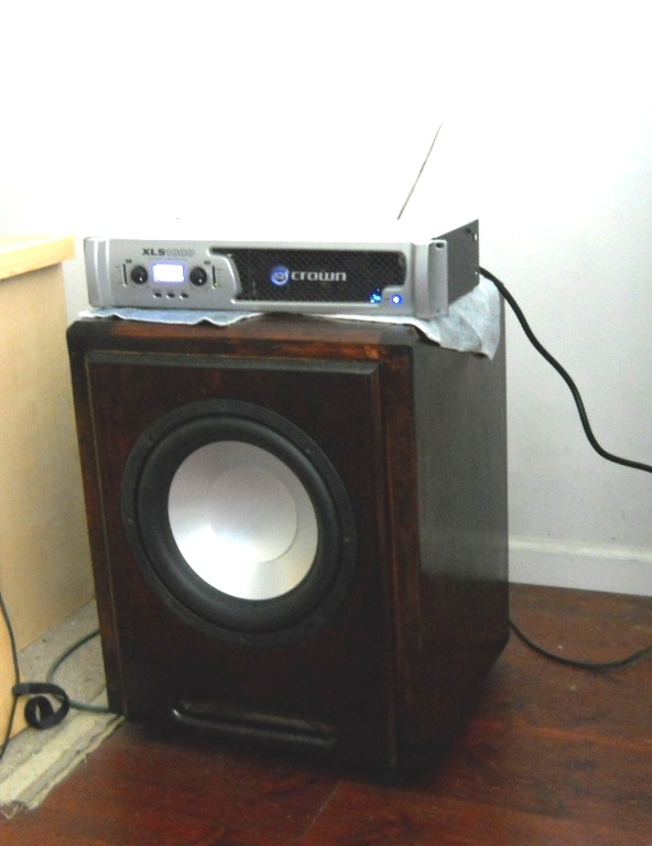

I've heard a mention or two about port things. I built it exactly to calculation (or as close as I possibly could anyways). Is there a way I can properly calculate, or figure out, exactly what my port tuning frequency is, and what it's doing, with my REW? Perhaps stuff my mic in the port and run a sweep from 15-30Hz or something? I honestly can't think of anything else that could be wrong with my box unless the WinISD model is just completely wrong.
AFAIK, the only way to calculate such a high aspect ratio, especially one with the no-no of being > 9:1, is to use the complex wave equation and whatever else is required for its high resistance due to friction loss, so measuring is the most practical way to 'see' what the vent's response, tuning is.
I forgot to mention that the vent's bends are affecting its output, tuning also, so looking forward to some vent only response measurements [mic inside it ~1/4"].
I imagine AkAbak is the only freeware that might can sim it 'close enough'; for sure none of the 'simple' programs can, plus WinISD has vent calculation issues to begin with: Discrepancy between WinISD & HornResponse

If the measurement on the first page is accurate then you might just be used to room modes.
In another room or with an other subwoofer you might have had +20 DB @ 30 Hz and if that's what you like then you will never be satisfied with this sub. A lot of Action scenarios (explosions and so forth) are between ~30 and ~ 50 Hz. That's where your output actually goes down.
Also it is just a 10" driver with 12 mm Xmax. The only thing that counts for low output volume is volume displacement. And that driver is physically restricted by is diameter/membrane surface and its linear excursion.
In my opinion your expectations regarding the subwoofers output power where to high (especially for your large room). I would recommend at least 12" if not 15". And when designing your subwoofer keep the room gain/room influence (modes) in mind. Those two can ruin the best designed subwoofers.

I am not sure if you responded to Brian Steele. I had the same problem with my sub trying to drive it with a Crown XLS1000. The amp was expecting a 1.4v signal and I was pushing .775. I had to get a little direct box that converts the signal and now I can make it punch me in the chest (slight exaggeration).
I'm thinking we need impedance measurements of this so we can see exactly what the port is doing. Ie what is it tuned to and is it being lossy or not.
If all you're doing is testing, or listening, to the sub on its own then amp gain, etc, has very little to do with anything.
As has been said before, the tuning frequency of the port corresponds to the frequency that the driver will move the least. At this point the air velocity through the port will be high. For the kind of SPLs we're talking about here the port should be blowing a small gale.

IF you want to measure tuning frequency, just do a low level sweep with the mic nearly touching the woofer. Unless the port is very lossy, you will get a notch at the tuning frequency. This is actually preferred to impedance measurements.

I lugged it upstairs, got it hooked up to my computer, and fiddled with the DSP a bit (using the software). It sounds a HECK of a lot better in my computer room than it did downstairs. I must've literally had it in the worst possible place downstairs because it's night and day difference.
To my ears, playing sine waves and such, it plays 25Hz with ease. 23Hz is very strong too. It's rolling off a decent bit around 20Hz and drops fairly steep after that (to be expected). It makes my house's floorboards and deck rumble quite easily as well. It's not quite as punchy as I would hope, but it's not in its final position, nor is it eq-ed at all, but it is pretty close in the 'stock' configuration.
I haven't had enough time to get a port sweep or impedance graph just yet, but I do still plan to upload those just for fun. I'm curious about learning how to read impedance graphs and such on a sub. More to come in the next couple days!
