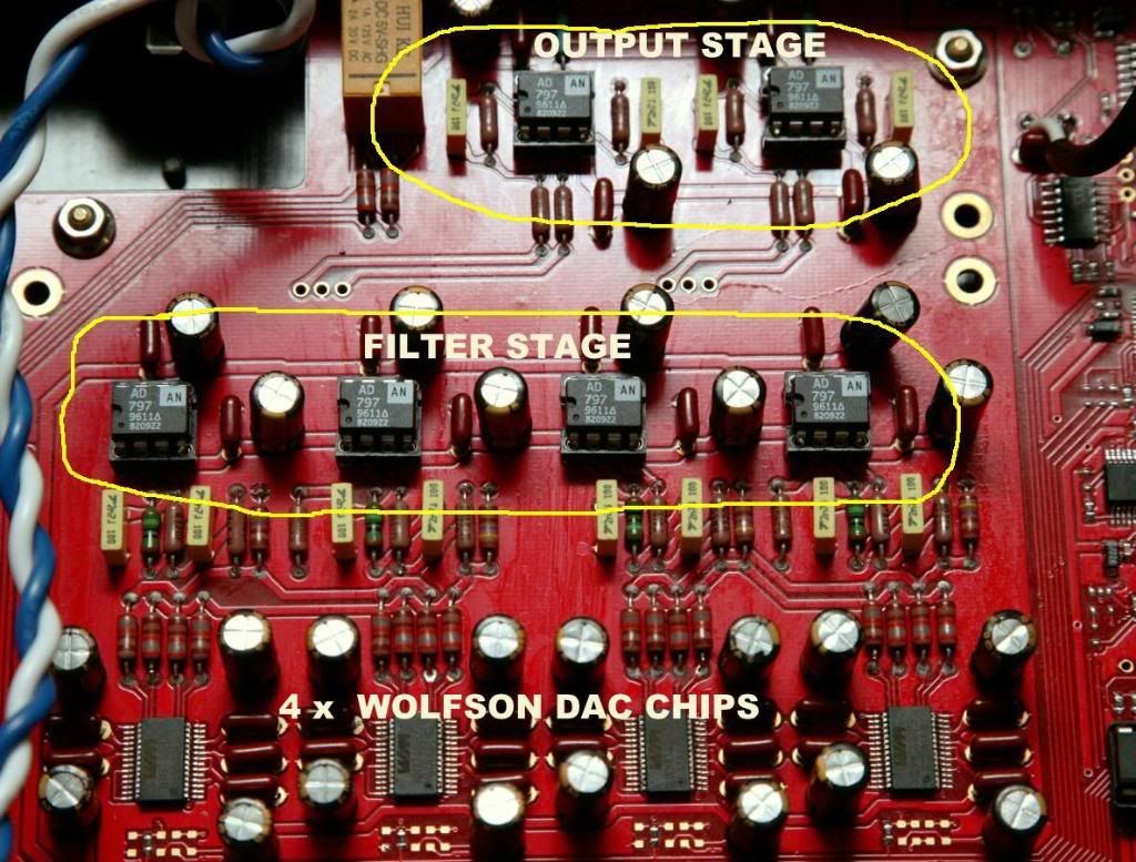

Hi Lordearl,
You can try the ad797 to replace the four IC's near the WM8740 chips, It seems to me that the ad797 is very good at extracting details from the source, But not very good or not as good as the opa627 or the stock opa134 at driving linestage.
I just recently found this out when I replaced the two output stage ad797 with the stock opa134, The combination is more dynamically effortless than using the ad797 alone.
So now I just bought a pair of opa627 to be placed in the output stage, I've yet to receive them. With the four ad797 in the filter stage, This combination should be interesting, I'll report back when i take a good listen at it. 🙂
ahh interesting, I didn't realise that they perform different tasks...
can you circle which one is which on one of your pictures?
I have a few other singles I could try....

I have just followed Marchel's lead and ordered some different opamps for the output stage. I'm trying 2x BUF634 - should be very interesting given that they are unity gain stable.
OK here's an update -
DON'T TRY THE BUF634 in the output stage - it gives no sound at all! The unit powers up fine, but other than that, it doesn't do anything!
The buf634 is not suitable substitute for our opamps, Cause it's pin connection is not totally identical to ours, I think it does not have a (-) inverting input.

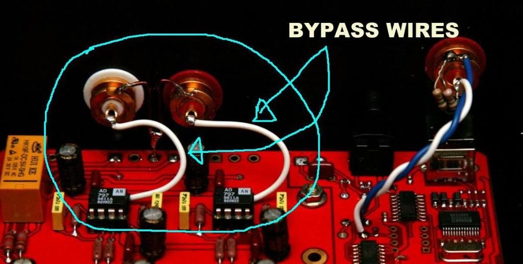

Since this device is prepared for balanced output. You may get an improvement in sound quality, by omitting the output stage completely.
I mean the holes are allready in the board. Just connect the positive and the gnd to the output RCA's and forget the negative. That way you get a much shorter signal path.
I don't have this dac, but this exact "trick" does work on the Cambridge DacMagic. It does sound better on the balanced output, because it doesn't have to go through that extra output buffer opamp.
It's just an idea 😛

but without both poles you arent getting balanced output, there is no possible way that could improve on just taking it from anywhere. thats a rather confusing suggestion, the 'output buffer' is also combining the 2 poles, so is summing the output, meaning you get most of the dynamic range of the balanced output. doing it your way you only take half the balanced out, so would actually suffer from LESSER quality output, the dynamic range and THD would be significantly impacted
I don't know exactly how this dac is build, but very often the balanced output has double the output of the single ended. So taking the pos. and gnd gives you enough output. But that can be different here, i don't know.
But I doubt that adding extra opamps will improve quality. It might give a higher output voltage, but that is not a quality in it self. Many modern systems have way too much gain, so unless you use your dac without a preamp, you don't need that extra voltage.
But again, as I said earlier. It's just an idea, and it works on my DacMagic.
No hard feelings. ;-)
enough yes, but no difference at all to using the + from before the last opamps, again, its not balanced....unless its balanced......
half a balanced output is simply a whole single ended output. but in this case the last opamps combine the +/- outputs as a summing stage as well as a line driver/buffer. so by skipping this step you miss a LARGE amount of the performance
I dont think you know what is going on here, in fact the last stage includes the output setting resistors, so the output will be hotter without it, but we arent talking about loudness, without the summing stage, there is the above mentioned DNR and THD performance missing, but also you miss out on ALL the CMMR which cancels a large amount of the noise (more loss in dynamic range and more self noise
but is there any similarity at all between the 2 circuits? I doubt it, this circuit is actually quite novel, but regardless if you simply take half the balanced output as your SE output in your dac magic, you are doing the same thing and skipping on the performance of a differential IV conversion stage, which is realized when the 2 poles are summed in the last opamp.But again, as I said earlier. It's just an idea, and it works on my DacMagic.
I repeat; half a balanced output has nothing at al in common with a balanced signal
sure absolutely, I dont even own one of these dacs 😉, no problem man, i'm glad you like the sound of your system and the subjective gains in sound quality from this mod. It sounds to me like you need to do some reading, as i'm not sure you quite understand the concepts you are playing with; no offense intended, but you will get more out of purposeful mods specific to the circuit you are modding, you cannot apply a blanket mod and expect to gain improvement (other than 'subjective' improvement) in a completely different circuit.
I know its rather fashionable here in some circles to think that no opamp is a good opamp and I actually prefer discrete circuits in general too, but you cant just take away an important part of the circuit like that without replacing it with something that achieves the same goal and get the same or better results. that and there are some things that are just far easier to achieve with an opamp; low output impedance being one of them.
peace
