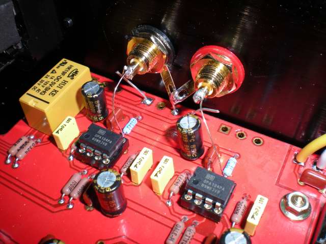

Bypass mute relay
Hello all,
Here a simple and cheap tweak with a very noticeable improvement.
I bypassed the 10 ohm output resistors and the muting relay contacts.
This is done by cutting the output wires from the PCB to the RCA connectors, and soldering a piece of wire from the 10 ohm resistor (on the opamp side) to the RCA connectors. See picture attached.
This results in more low-end extension. The tonal balance is now constant when changing volume (Using USB, Foobar with ASIO driver, no DSP's). The music seems more 'direct' and involved. I really like this DAC, still with the standard opamps.
I'm sure there is a technical reason to design that 10 ohm resistor in the output path, but I decided I don't need it. Leaving out the muting relay makes no difference in my system.

Hello SCATEO,
After you bypassed the relay, Do you hear any noise coming from the speaker every time you change disc or turn off the digital source?
Same as paul_peraic says; some minor nuisance noises when switching the DAC on/off while the amp is on. No hard klicks or plops or anything distructive. No other noises when starting/stopping/pausing etc. Even during PC re-boot with DAC and amp on, there are no noises.
Seems to me that the relais contacts deteriorate the signals from the opamps and the 10 ohm resistor is coloring the tonal balance? Anyway, with both of them out of the way it all sounds very balanced, especially in the lowest octave. Very noticeable improvement in dynamics and low-end pressure.
