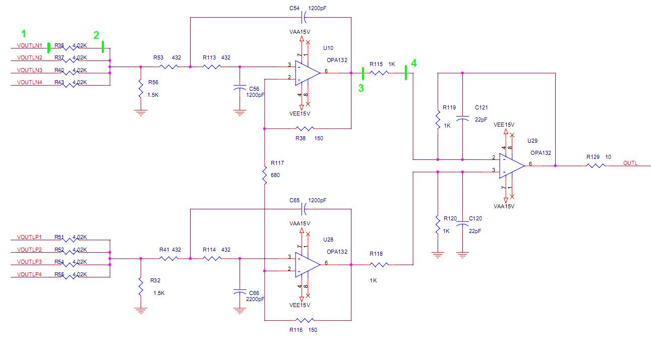

i am ready to install the little Onectic OPT´s on this dac....should i just attach them to the dac chip outputs (right before the resistor? of after) ?
there is not much information on how to install this transfos...and i am afraid i can fry them...

Hi:
D/A is working under PWM feature.
So your D/A output should be a PWM carry frequency filter.
D/A working function block will like D/A+filter+buffer.
So yr Better connect OPT to OP buffer output.
Btw need take card Otp impedance must be matching.
Normal OP output close 600ohm so Your OTP first-pole must close 600ohm.
Pls take care what's stage your will connect to D/A output.
That's depend on OTP second pole impedence.
If connect to Tube Amplifier that's will be High impedence.
If connect to Transister Amplifier Impedence just 75ohm.
mm...so you are recomending to use what i have marked as point 3 in the schematic?.....i will try this weekend and report.
thank you.
thank you.
Hi:
Attach Modify circuit for your reference.
Connect U29-pin6 to OPT First pole.
Second pole Output tag OUT just connect output RCA connector.
OPT Two side Ground just connect D/A Ground together.
Aster

..i was hoping to use the dac chip output for the opt's and skipping all the opamps. I have checked audiodesignguide and i saw a dual mono using transfos....why can i not do the same?
Hi:
No Better just your like or not.
This is DIY.
If yr direct connect to codec chip and yu better have a nice impendece matching.
your have to check DAC L+/L- output imp. value and close to your OPT Imp. .
If match not good your will loss signal too.
Btw after check wm8741 spec. diff.-out min load about 2K.

yes for direct connection you will need to load the primary with 2k+ it should reflect the same impedance as the next stage, so whatever the input impedance of your amp is, you should try and match this as loading on the primary of the tx. the onetics are 600:600 if its the same as mine, so load with same on both sides as the input impedance of your amp will be reflected to the primaries. its a funny old world in this area, so may be totally incorrect.
one thing i definitely agree on, what would be the point of using tx on the output after the opamp and buffer? the whole point of that mod is avoiding the output stage opamps, galvanic isolation is minimal, especially if you use balanced out; so you would just be adding another component for no reason and rolling off the top end for nothing
