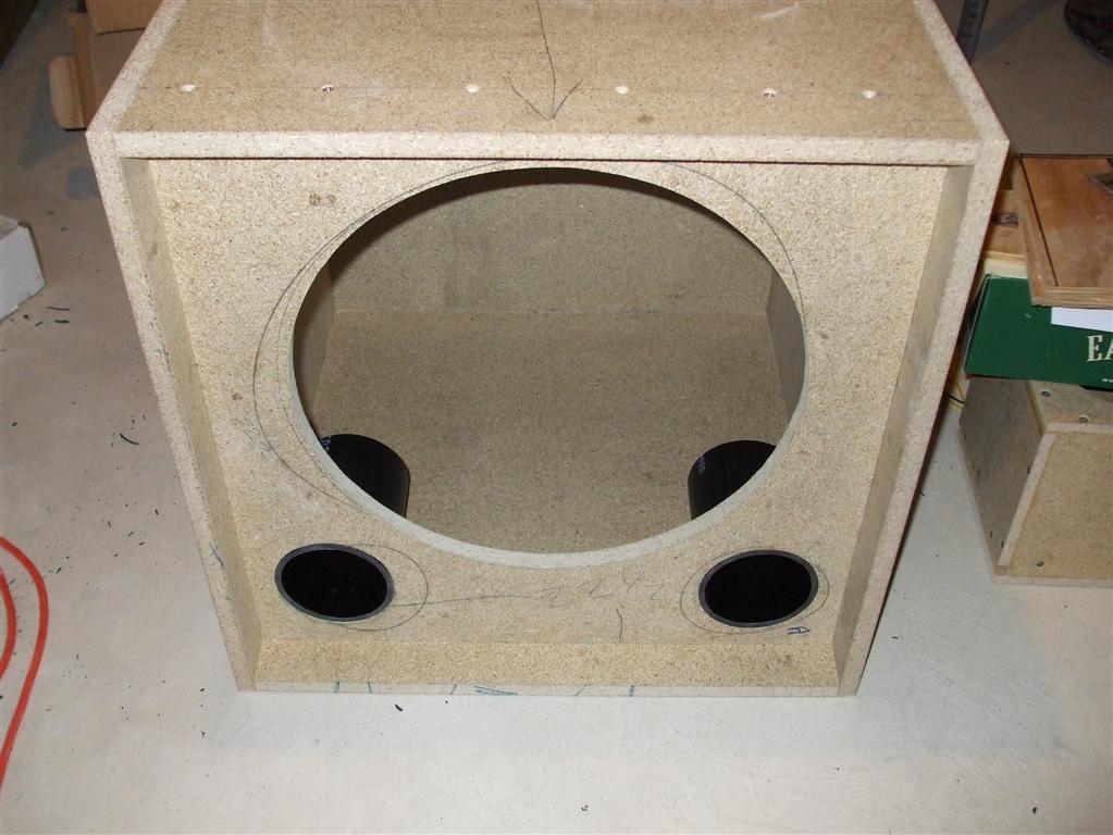

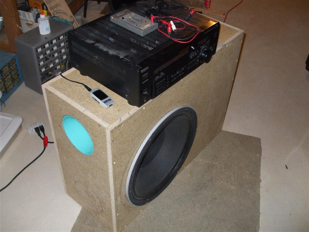

I had a chance to build a couple of enclosures to test this speaker. One is a 6.6 cubic ft. 24" cube with two 4" diameter ports 6" long (34hz). The other enclosure is 4.72 cubic ft. 24" tall, 13" wide, with 33" depth. One 6" port 10" long in front (34hz). Speaker in the side.
The cube box is ungodly loud. @.@ 100w rattles everything in the livingroom. It would be great for sound reinforcement but lacks deap bass. It's very "punchy" and kick drums slam your chest. I ran out of 4" pipe to try longer ports.
The second enclosure is sort of strange. If I use a shorter 4" long port (44hz) the deep bass extends lower then with the 10" port (34hz). I'm not sure why. I haven't had a chance to drive it hard yet. The kids went to bed.
