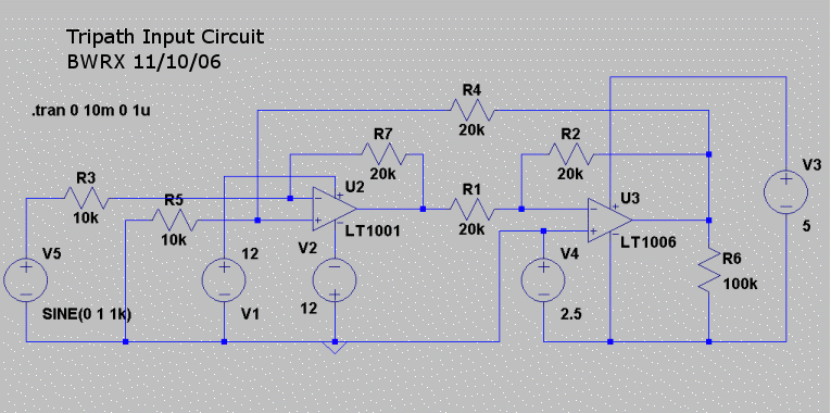

Basically just wire the inputs without any caps, but instead of connecting the input ground to analog ground; connect it to the biascap pin. Then you just need to make sure the analog ground and your source ground are isolated and that the source has no DC.
By connecting the source's ground to the biascap pin you can potentially introduce a lot more noise into the input stage. Also, as was stated, the power supply for your source, your amp, or both must be floating. I still wouldn't be comfortable doing it this way because unbalanced input bias currents on the input opamps could cause noise, DC offset, etc. I had thought about bypassing the whole input stage all together a while ago but never really did anything about it. It would have been nice if Tripath had made the input opamp stage more accessible, but it is apparently tightly integrated with the other proprietary 5V digital/analog signal processing circuitry in the chip. It would be better yet if they made their chips to run off of split supply rails so they could safely do away with input coupling caps!

The next step would be to not use the on chip opamps at all and run the signal from the OPA2134 right into the feedback pin attached to the output of the internal buffer opamp. I'd be willing to bet you'd get even more improvement.
But he's going to have to do something with those onboard opamps. There are still powered up. Don't want them adding noise or other junk to the input bus.
What do you think? Tie them to ground?
That's an excellent point, Michael. Seems I hadn't fully thought that one through.
If the inverting inputs are tied to ground with the non inverting inputs sitting at 2.5V then it will cause the output of the opamps to swing to the positive rail IF there is no feedback loop.
Since we have access to the inverting and output terminals of the internal opamps they could be wired up for unity gain (short inverting input to the output) and then you can feed the signal into the feedback pin through a resistor to sum the audio signal with the DC bias. That will cause the internal opamps to act as a DC buffer where the outputs will sit at the DC bias on the non inverting input. You'd still have that 2.5V bias and that should effectively take them out of the equation (I think).
Edit: that may not work well. I can't see a good way of bypassing the internal opamps besides wiring it up for unity gain and using the external opamp with gain. Or maybe including the internal opamp inside the feedback loop of the external opamp circuit.
I thought about this a little more and came up with a circuit that puts a feedback loop around the internal opamp. Think differential amplifier with the internal opamp used as an inverting stage inside the feedback loop. The values shown in the schematic will give you a gain of 1V/V. Simply move the input voltage source to the noninerting input for a gain of -1V/V.
U3, V3, V4, and R6 are just for simulation purposes and would be part of the chip.
Also note that the 5V supply for the internal opamp is floating, as well as the 2.5V DC bias with respect to the external opamp ground. Either the amp's supply needs to be floating or the preamp/source supply needs to be floating. I would float the amp supply.
