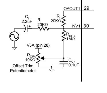

I've been looking at the DC trim circuit for the TA2024C but I'm a bit confused and I think it's Tripaths fault. It says to connect one end of the trim pot to "V5A(pin 28)", but V5A on the chip is pin 9 not 28.
The circuit also needs a ground point but I'm not sure if that point would be power ground or my new input ground point at the biascap.

Looks like you caught a big mistake on the Tripath sheet. Yes, it should be pin 9 NOT pin 28. 28 is a a speaker output! They must have pulled that note of a sheet for another chip and forgot to change the numbers.
I've used this offset null circuit many times, it works great. The Trends TA-10 has it too, minus a few bits.

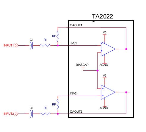

It seems Tripath needs to proof their files a little better. They made another mistake in the datasheets that show how to bridge their amps. You can see in the attached pic that RI goes into the OAOUT2 side of RF when its supposed to go to the INV2 side; just like it does on INPUT1. This caused me a bit of a headache when I was trying to bridge an AMP1-B.
So whats your guess as to where I should ground the DC trim circuit now; power ground or signal ground? Also, I only have 50k trim pots, no 10k. Will it still work?

I think the null offset circuit is going to be connected to analog ground, as it would be normally. Just gotta try it and see.
the figure you showed is the normal TA2022 input stage. That attached is the bridged configuration in TA2022 datasheet.
Congratulations for your experiment. Any hope to have a schematic for a TA2022 without input caps?
You're correct it is the normal input not bridged that I posted, but the drawing is still wrong as I explained(?).
I'm not very good at drawing up schematics, but you really don't need one it's so simple.
Basically just wire the inputs without any caps, but instead of connecting the input ground to analog ground; connect it to the biascap pin. Then you just need to make sure the analog ground and your source ground are isolated and that the source has no DC.
