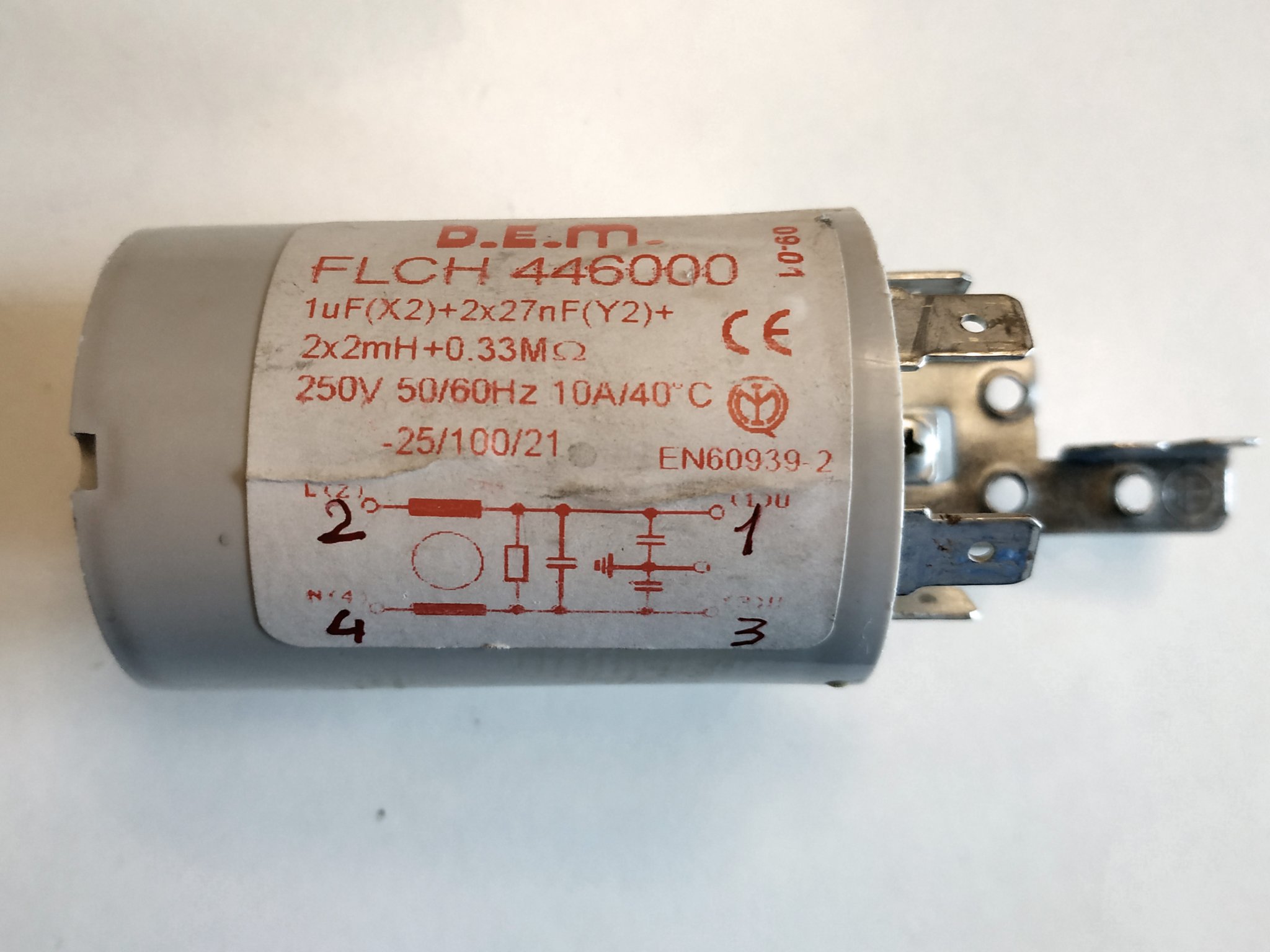

Hi, I have electrical disturbances when I operate the motorized window shutters, the initial cue of the motors causes bad noises in the various home hi-fi systems. The general electrical panel has a dedicated line for the motorized shutters, and on that line I would like to put a capacitor/inductor that I recovered from a washing machine, could it work? Is 1-3 IN and 2-4 OUT okay? I attach image

It is already provided on the metal part of the capacitorYes thats ok but I would add the earth line too between the two capacitors.
The electrical system is new like the shutter motors, they are already groundedAlso try connecting the motor housing to Earth.

How big is that breaker? 8Amps? 32Amps?electrical panel has a dedicated line for the motorized shutters
Are there any specs for the shutter motor?
That filter is rated 10 Amps. If you try to suck more than that it may overheat and burn.
Is the shutter motor system properly grounded? It probably should not be putting a big POP on the line, and may need a ground (PE, green/yellow/bare) wire to divert the surge.

That is an RF filter... what you need is a snubber: a combination of a capacitor and resistor connected in series. The capacitor conducts the RF noise; the resistor burns that energy and dissipates it in a form of heat.
The root cause is most likely:
1. The back EMF at the moment inductive load, i.e. the AC motor (with the commutator/brushes) - is turned ON, and in particular OFF.
2. The commutator ON/OFF switching that happens at all times while the rotor is spinning.
3. Sometimes even the limit switches are part of the same, cheap control START/STOP circuit (sitting at mains volatge), in which case they (the limit switches) must also be treated with the snubber combination - just a different capacotor values... the reissitor could be chosen to burn as much of that energy as possible.
The above should be done by someone who installs this type of equipment - usualy a licenced electrician that understands the issue.

The line switch is 10A, the shutter motors are 250W. There is a noise only at the start of the drive, like a pop, then there is no noise during the descent of the shutter
Put a snubber at the entire supply to the unit.

I assume the shutter motors are wired directly to your panel, this is not a good place for DIY solutions, contact the shutter manufacturer. Do these motors have the CE mark? The EU has pretty strict EMI regulations and they are probably in violation of the rules, it is possible that they have a motor retrofit to address the noise problem. You may need to consult an electrician as well, DIY on permanently installed mains wiring may not be a good idea.
