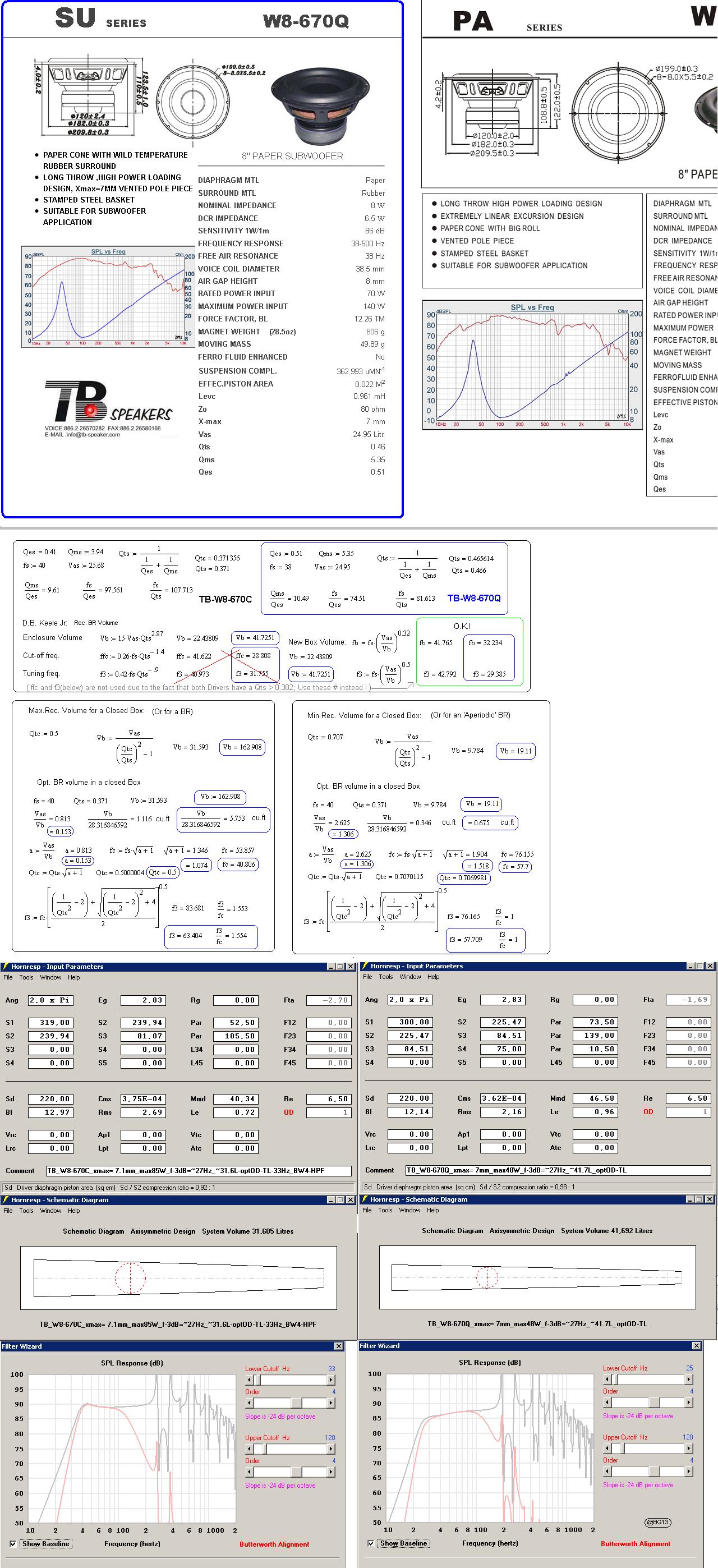

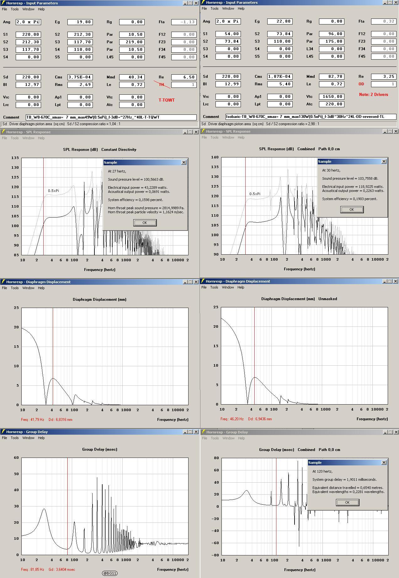

they did agree that they supplied W8-670C drivers for Z-560
Note: Normally people confuse this bass driver as used in Z-680, Z-2200 & Z-2300 with the Tang Band W8-670Q model.
Though both units look near identical, Z-2300’s bass driver is different from the W8-670Q in the rear section.
It became absolutely certain when my friend’s Z-2300 bass driver went dead and I have to personally contact TangBand via email to ask the model of the driver used in Z-2300 & its price. I also send them the above pictures of the driver to help them identify. To my surprise, they replied after inspecting the pictures sent to them, that this bass driver do not belong to them or in any way represent one of their models. But they did agree that they supplied W8-670C drivers for Z-560. So, you see Z-680, Z-2200 & Z-2300 are not TangBands. Prior, I was also the victim of this case.
