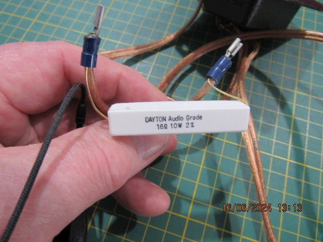

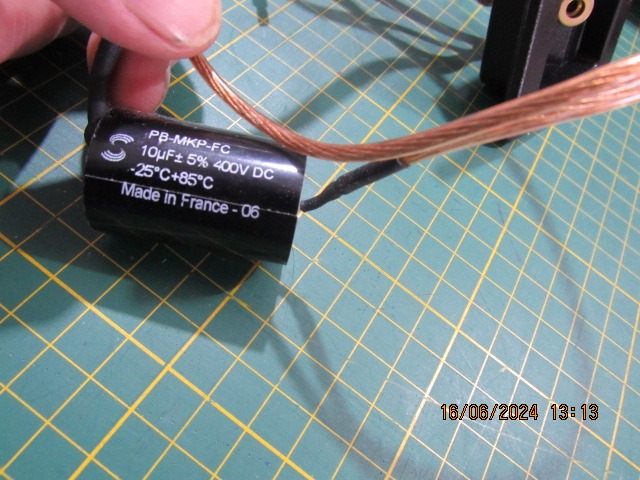

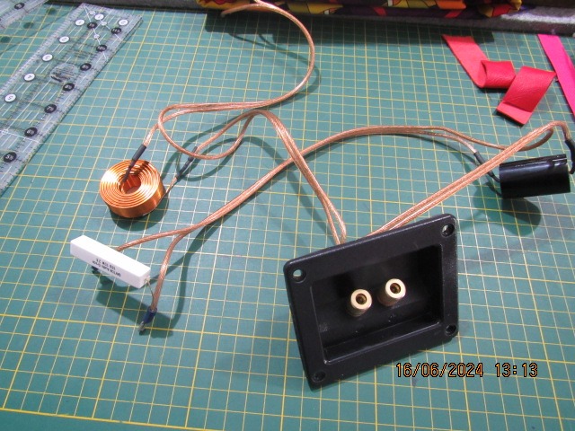

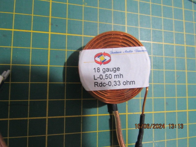

Nope Just a cap on the tweeter and a small coil on the woofer.
BUT
Good quality cap and coil
So not the Eminence XO
Eminence Alpha10A and the Peerless [ Denmark] DX 25TG-05-04
Tweeter has a 16R bypass resistor soldered on to it
