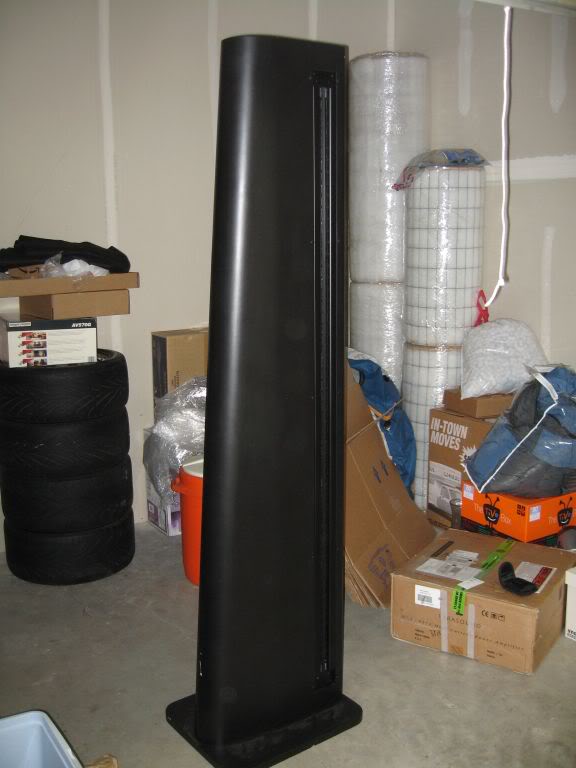

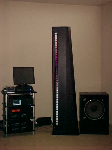

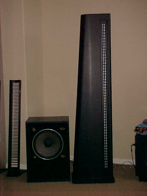

If anyone is interested I've got this pair of BG75's in an airfoil shaped baffle. The baffle was machined on a large bed CNC. I used them full range, crossed at 300Hz to a small JBL commercial cinema cab. The airfoil shaped baffle is the way to go. They sound great! And image superbly. I need to reduce my inventory of toys. If anyone is interested in them send me a private message.

Carl? Did you use the CNC to machine the airfoil's radial component? That had to be,
"One Big Damned CNC". I think the largest travel I ever had in "X" was 68" in a custom, "Cincinnati Milacron".
Machining Airfoil Baffles
Yea, it was a commercial large bed CNC. I supplied two blocks of glued up MDF, an engineered drawing and bag of $$.
The latter was the least fun of the three.

Um, I think there is some confusion here. Aren't those the speakers that I sold you? In fact isn't that a picture of my storage unit? I know I built those tube traps in the background and those are the tires from my 944 🙂
I didn't build the speakers myself. I purchased them from a gentleman in Canada who apparently had them made.

I have owned three iterations of RD75 type speakers:
1) Original Wisdom Audio Dipoles using RD75 drivers
2) Newer Wisdom Audio Dipoles using the 6-turn driver and some passive components that they called the Smart Ribbons. I suspect this is a modified "pro" driver.
3) The black airfoil speakers that Carl Huff posted above. I didn't have room for them anymore and sold them to Carl.
They all sounded pretty similar. I think that (3) imaged the nicest but (2) played louder.
These speakers can do a lot of things amazingly well. However they also have some compromises and which I'm not certain are worth it or not. They sure are fun to play with though.
One thing I love about them is that the SPL doesn't really change as you move about the room.
A modern version with perhaps less resonance would be sweet!

"...they also have some compromises..."
Is resonance the biggest compromise? What are the others?
The systems I used all crossed over around 140hz to woofers and the transition always felt a bit unnatural to me. Also this limits the output of the drivers and they would get a bit distorted at louder volumes.
I'd love to try them crossed at 600hz to an array of traditional drivers to see if this helps.
Baffle diffraction also comes into play. I bet these drivers would shine in an infinite baffle situation with plenty of room behind them to absorb the rear wave.
