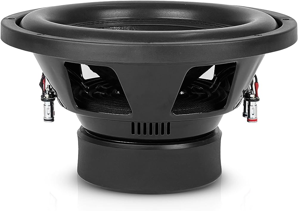

PS- you would be better off just buying a 90$ "real" woofer (below) and powering it with a used "real" subwoofer (outboard or DIY) amp.
That 12" below really can handle a "real" 200W amp.

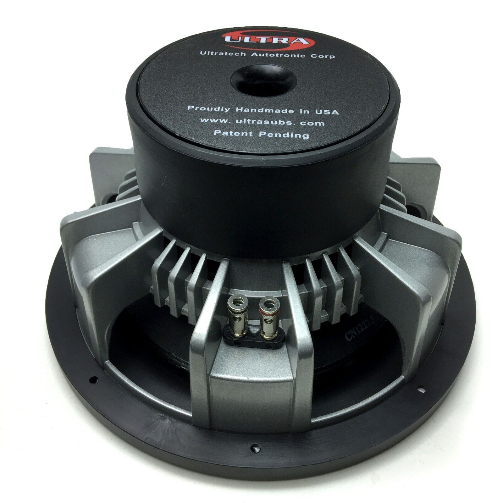

I just bought one of these (below) for 100$ - The Skar above sounded real good but they mis-represented the cutout and outside diameter specs
(don't fit the box). I'm returning the Skar. Glad I did , this one ("ULTRA -below) can go lower than most car subs and is 90db efficient. 35mm Xmax is an added benefit (for just 100$). link - https://www.ebay.com/itm/133555744366? they have 6 left and It specs out nice to my 2.4 cu ft. box !
I've had it with all these Chinese drivers... "proudly made in the USA" - yeah !
I did find the original PDF for this "real" driver. I did not mean to pick on your SVS driver .... but they must really tweak it (ELF + class D) to ,make it do
what the Ultra will do natively.

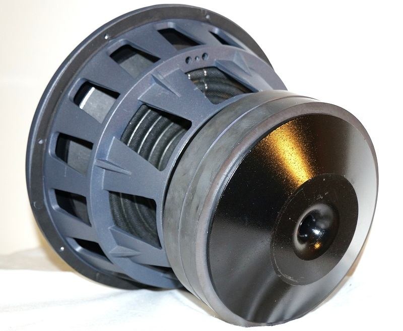

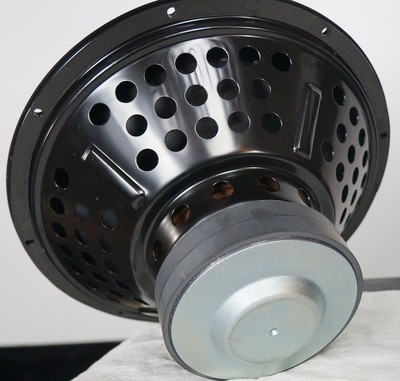

A closer look , SVS1000 (below 1) - 35mm VC , no vented pole piece .
With such a small diameter spider .... 25mm Xmax ?? I was right , a proprietary DSP software to
control the excursion. So you are paying for the DSP "magic" that makes this woofer perform like
the "ULTRA" , even as it isn't. So without the magic DSP , it would perform like a $129 Polk.

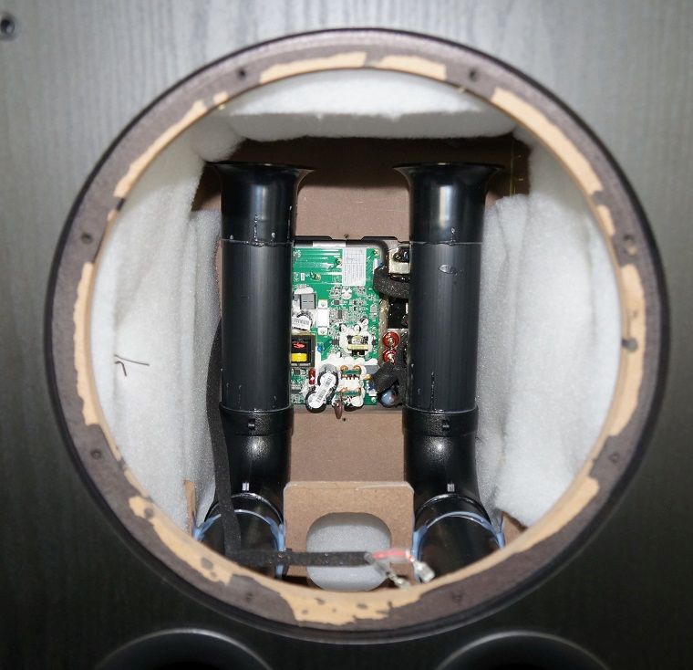

Ohhh , 2 75mm sewer pipes (below 2) and the magic DSP. I don't see how 25mm Xmax would not have port noise
with just 75cm squared (port area). I had a polk with (single) 75cm and it had port noise at full volume.
Not "picking" on this unit , but I am TRULY amazed at this level of scam aimed at the consumer.

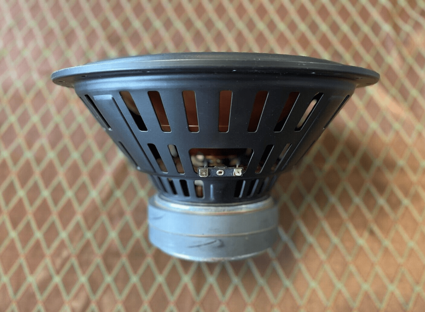

Even the MDF is crazy thin , bet the SVS woofer would break the front panel if dropped. I found a Klipsch 12" (below 3) that
had the woofer INSIDE the cabinet after being dropped - the woofer still worked ( same 35mm VC and no venting).

the SVS and Klipsch driver
both look like vented spiders.
assume the normal 8 to 12mm xmax
which is over rated using peak to peak at 24mm
36 mm likely peak to peak as well = 18mm
but yah never know.
Klipsch won't do much over 25mm before it get real noisy (free air). VC started venting warm air @ 125W. I ran the Skar for
2 hours at 225W (20mm P-P) , no smell , just slightly warm air at the pole vent. The Skar is also a scam power rating , over-rated at 1KW.
But , the Skar sounded real nice in the ported box , I was amazed at 90$. I break these woofers in before I "box" em , monitor temp.

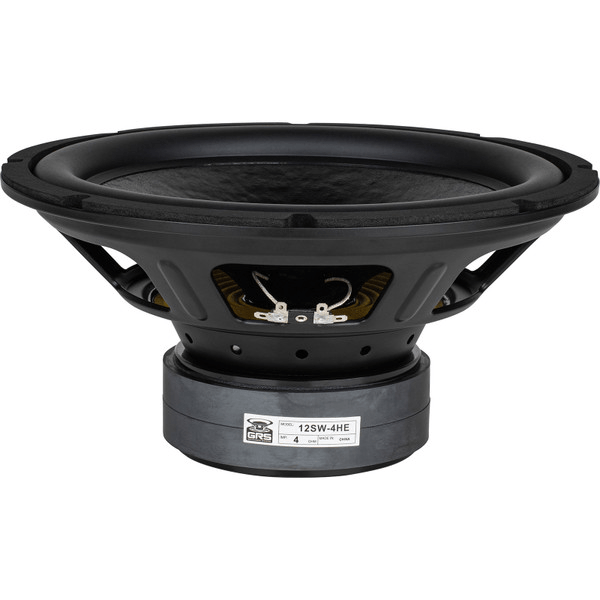

One of my favorites is about same magnet and vented spider.
Goes very deep actually and upper detail above 120 Hz is still
good.
Oh yeah , the GRS ! Well made in China (still). I have the 8" version of that - 10 years
and still going.

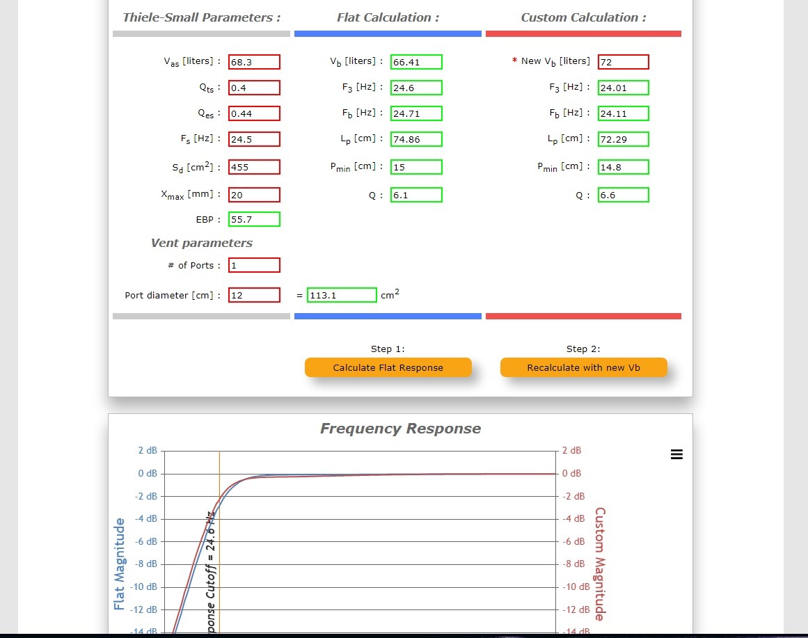

I want to move up to the >30mm Xmax drivers. I did not like most of the auto 12" offerings with crappy SPL/1W (83db). My box has 150CM/2
port area tuned to 25hz. I should have no port noise with even 40mm.

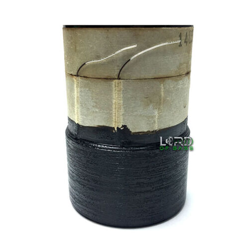

"Lord of bass" even sells the cone,basket, and coil for that "ultra" 12".
