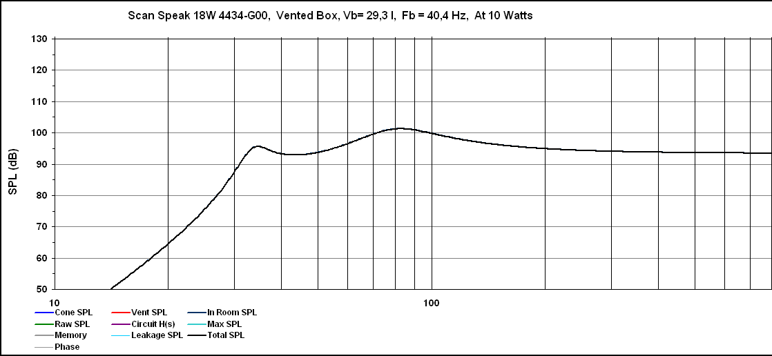

Your calcs look flawed to me, using winisd I get 60 and 101 litres
60 Litres (2 cubic feet) closed box for a 6" Qts 0.38 reflex driver? Don't you smell a rat? That's huge! 😀
29.7 L disregards stuffing. That would make it even smaller. 😎
Reflex tuning is a moveable feast, of course. My calculation tunes it to the Fs of the driver IIRC. But admittedly it's a simplistic calculation.
Reflex = 71.2 L (I don't have to think about that with a Qts of 0.38!)
Well, I guess it's down to personal preference 😉

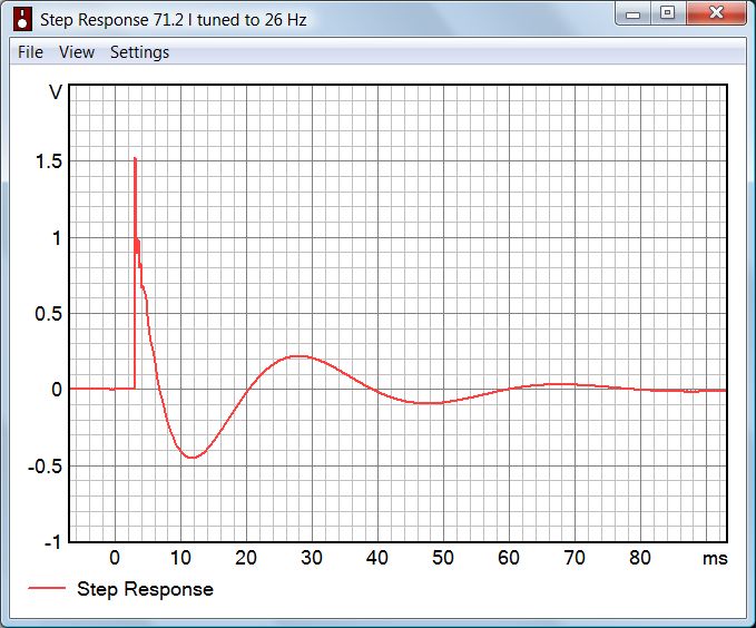

With 71.2L and Fb = Fs = 26Hz you'd get the following:

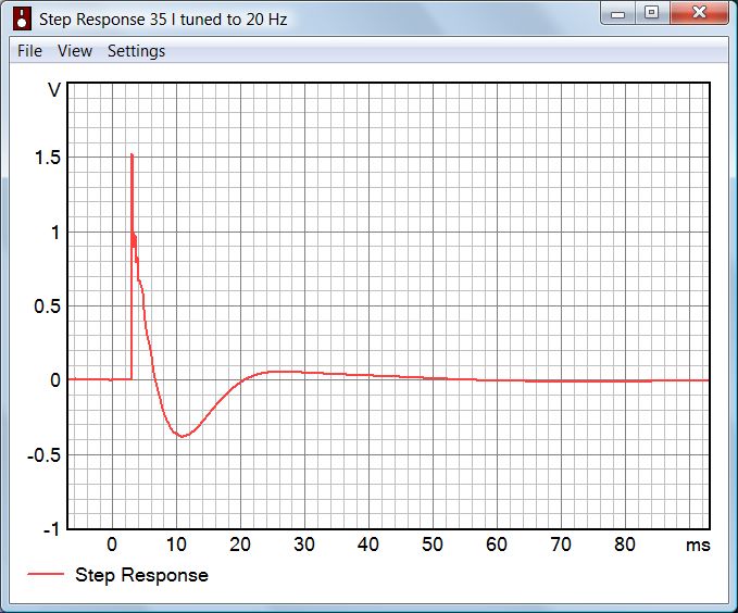

I would personally prefer a 35L box tuned to 20Hz:
Marco

You completely overlook that your 71.2 l Butterworth alignment is boomy while the step response of Marco's 35 l alignment is very good. A proper aligned small box is superior to a large vented box, but a misaligned small box also can be worse. I agree with speaker dave that many commercial designs belong to the latter category.
I'd be a bit careful with the conclusions drawn from the previous simulations (showing dramatically changing response). You can't look at change in compliance or change in Bl at high peak excursion and simply enter those numbers back into your model. Those are really just the instantaneous values at the peak of an excursion cycle. They would have to be put into a sophisticated distortion model where they would certainly impact excursion and distortion but wouldn't really shift the static response curve as shown.
As parameters do change with excursion, the vented box which reduces excursion (at least at some frequencies) can be advantageous.

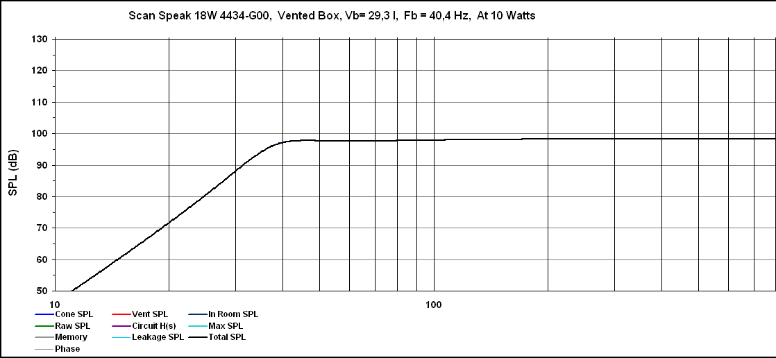

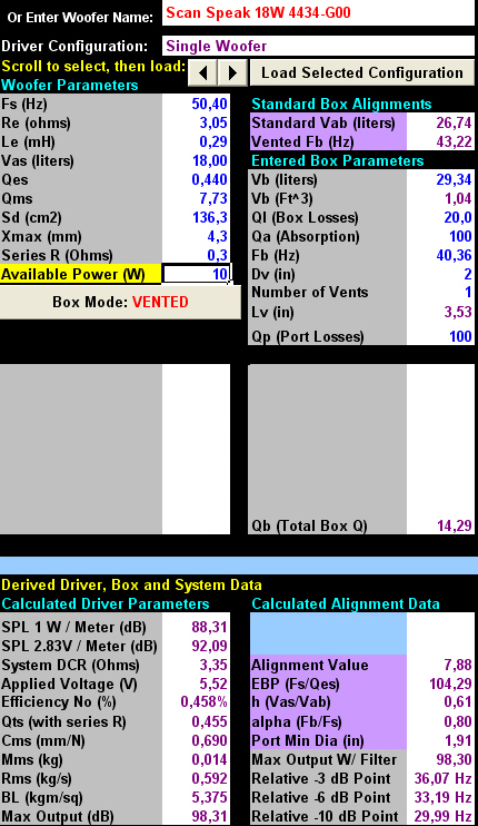

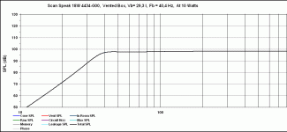

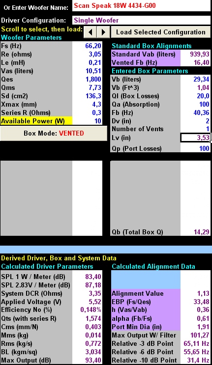

I gave my best to simulate it based on Marco's suggestion
that Cms drops to 0,4 and Bl to 3.
Fs was calculated based on new Cms and the same Mms.
Vas was converted from Cms. In order to get to Bl=3,
Qes was increased until I got it. Does not look as severe as
Marcos first simulation at 7 mm excursion.
