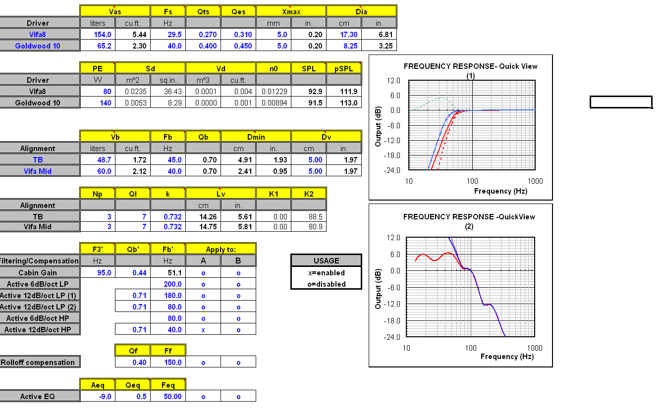

Here's the first cut of a simulator for the 2X 8" Vifa sub design I mentioned earlier on today, compared to a design with 2 X 10" Goldwood 10". The Vifa is the solid red, and the GW is blue. Would the Vifa design be better served by a slotted port?
Same here. Why not find a driver that's better suited to a vented enclosure with multiple long vents. It doesn't necessarily have to be "Onken" tuning, as per the spread sheet.

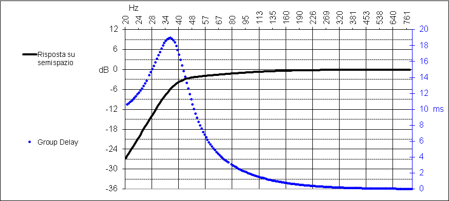

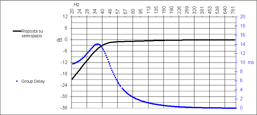

This is actually interesting, so I dug up some large-signal measurements ("Klippel") for a highly regarded mid-woofer typical of the ones employed in many "high-end" speakers today: the ScanSpeak 18W-4434g00: http://www.scan-speak.dk/datasheet/pdf/18w-4434g00.pdf
Measurements here: Scanspeak 18w/4434g00 Klippel Results
And then I went and simulated it in a reasonably optimized 30L / 40Hz Bass-Reflex box.
This is the result using the published (small signal) T/S parameters:
And THIS is the result when the same speaker in the same box is pushed to produce a 98dB peak at 3m (which corresponds to an 80dB mean listening level if one assumes an audiophile recording with a 18dB crest factor):
Not pretty, uh?
Little wonder that Bass-Reflex boxes get a bad rep!

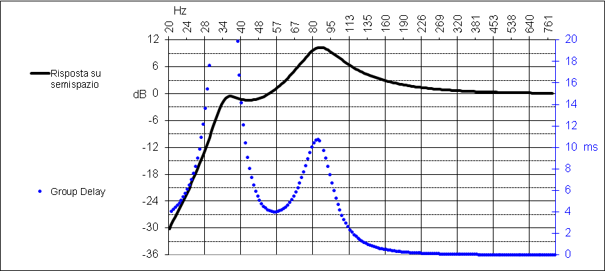

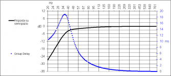

Now let's repeat the simulations for a REAL high quality Woofer, shall we? 😉
JBL 1501AL (15" AlNiCo magnet, underhung voice coil...), used in the flagship "Everest" system: JBL Master Reference Monitor - Page 33
Small-signal simulation in 120L / 35 Hz Bass-Reflex box:
...and at 98dB @ 3m:
For all intents and purposes, indistinguishable.
Meditate, folks, meditate...
