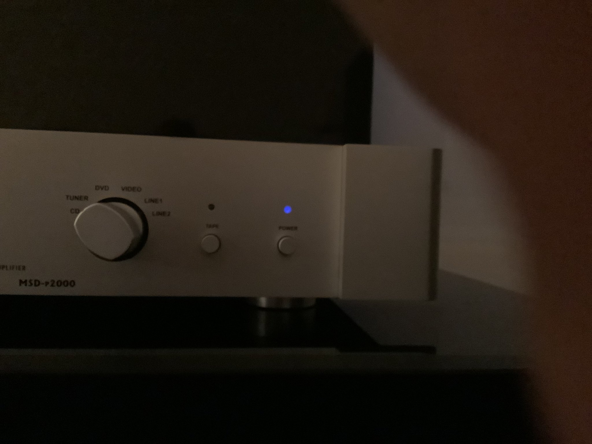

I hate blue LEDs, my solution
Yes, I know, yet another quick blue LED bantering. Personally, I never had a issue with the color, only with the point source of light and it's brightness/undiffused look. My remedy was quick, easy and didn't involve math or resistors. Hot Glue! Whereas I don't typically indulge in hacks of any sort, this qualifies as one. The good news is it's totally reversible. In my case, the LED is lit dimly when the unit is off and on brightly when on. Now, when the unit is off, it's off (can't see it) and when on, a soft blue glow.
I removed the LED by pushing from the front with a plastic tool while pulling on it from the interior of the chassis. Then I put a small piece of scotch tape on the faceplate to cover the hole. This served as a barrier for the hot glue and gave a nice flat surface. Fill the void the LED use to reside in with hot glue, encircle the face of the LED with glue and stick the two together. Hold in place for 20 seconds or so and you're done. For all the data dinks that lurk around this forum, I'd say the negative offset from original position of the LED to the new is 3/16" or slightly less.
Best wishes to all this Christmas season.
Stay safe.

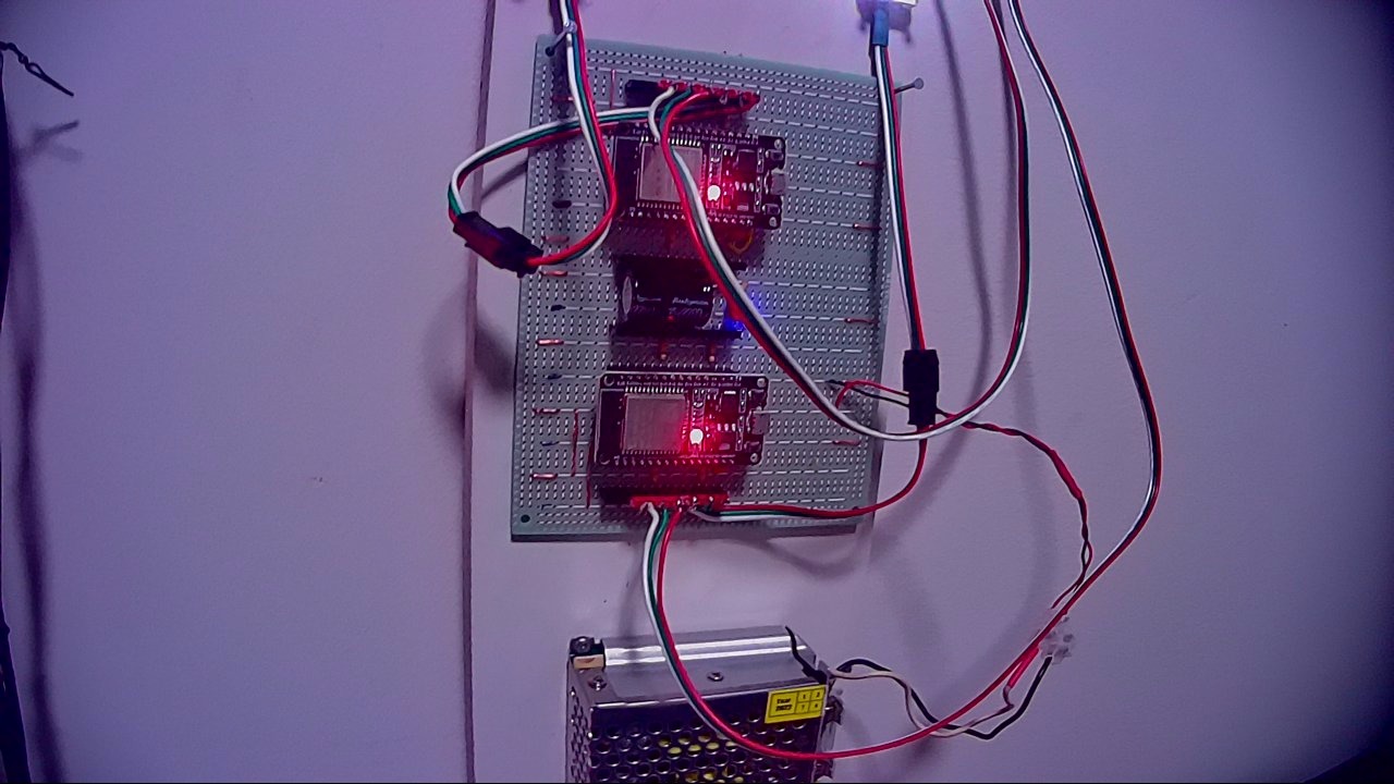

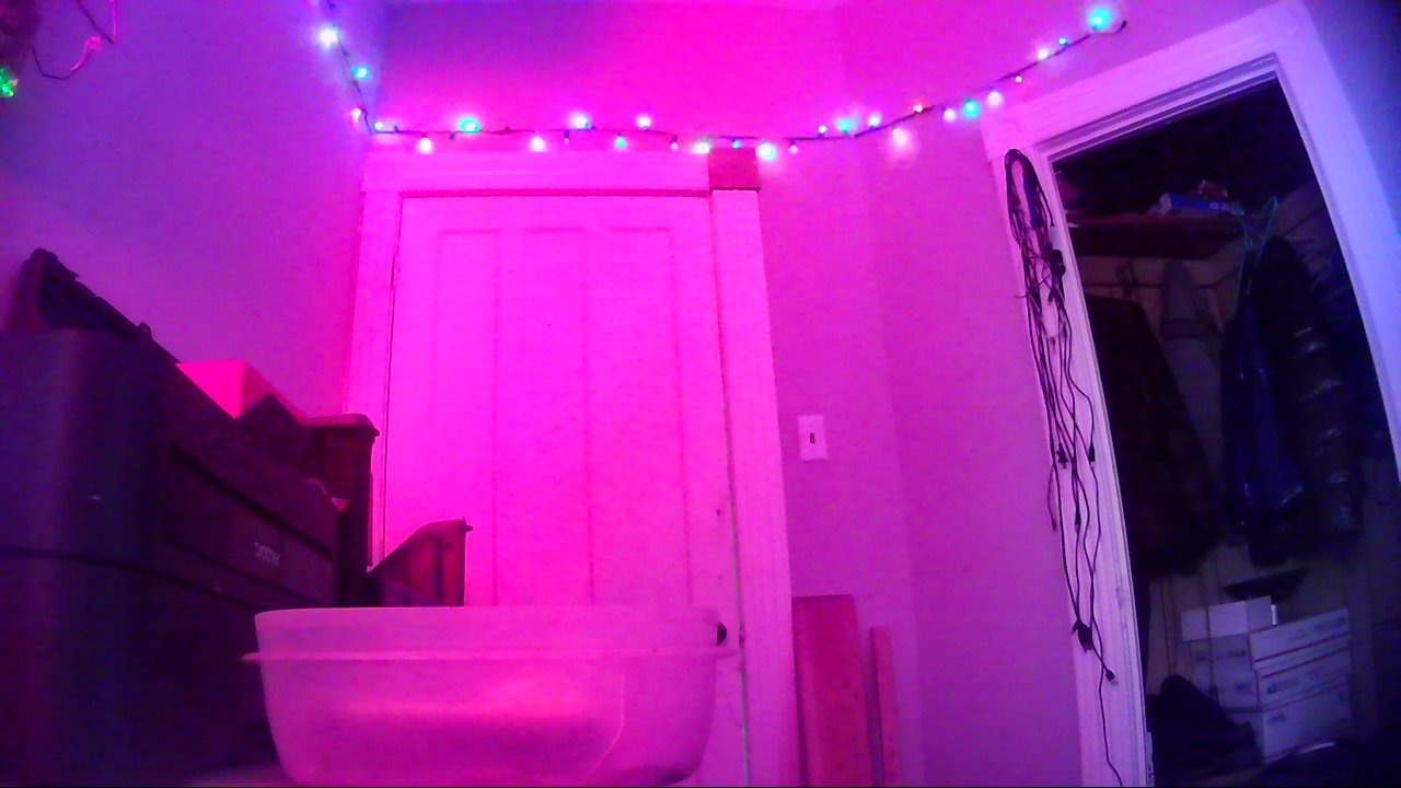

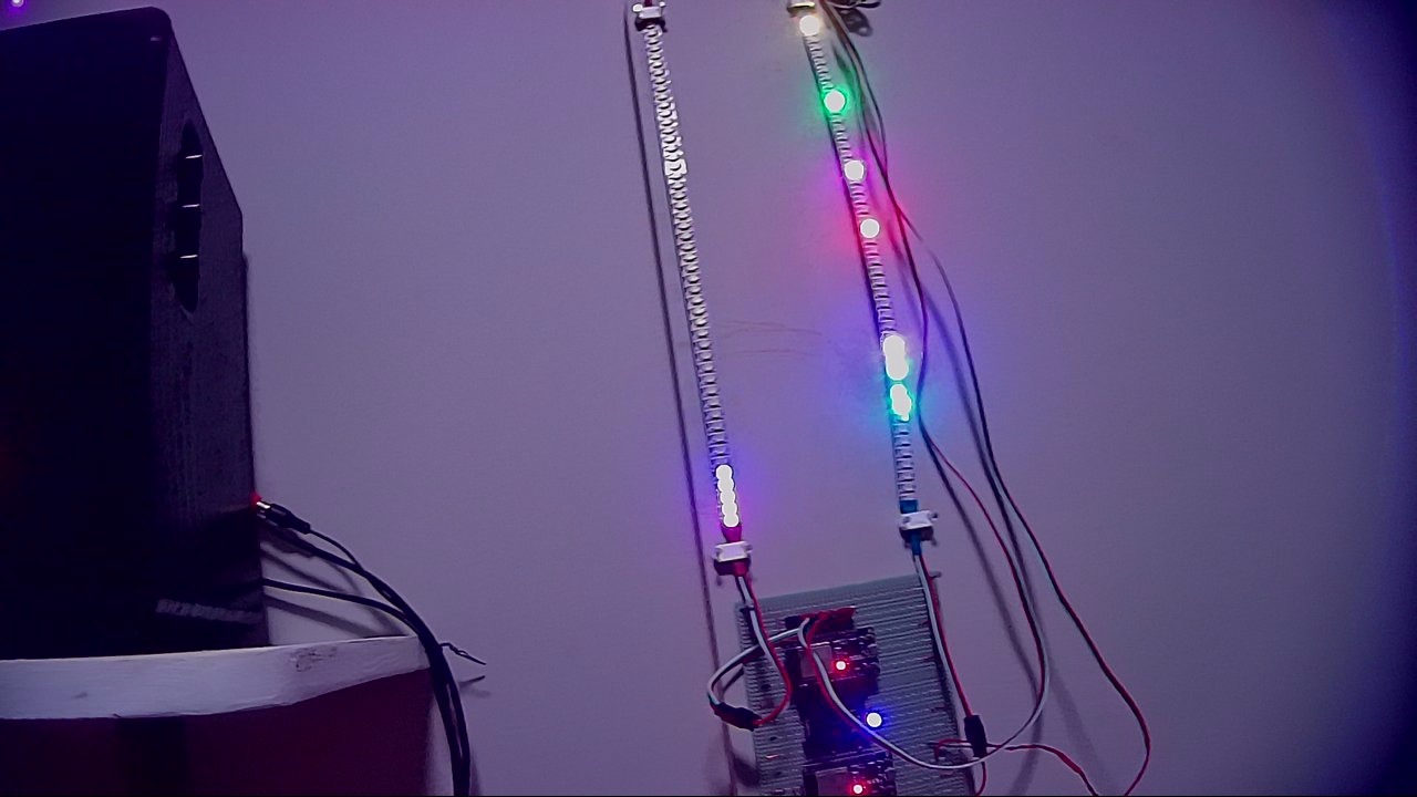

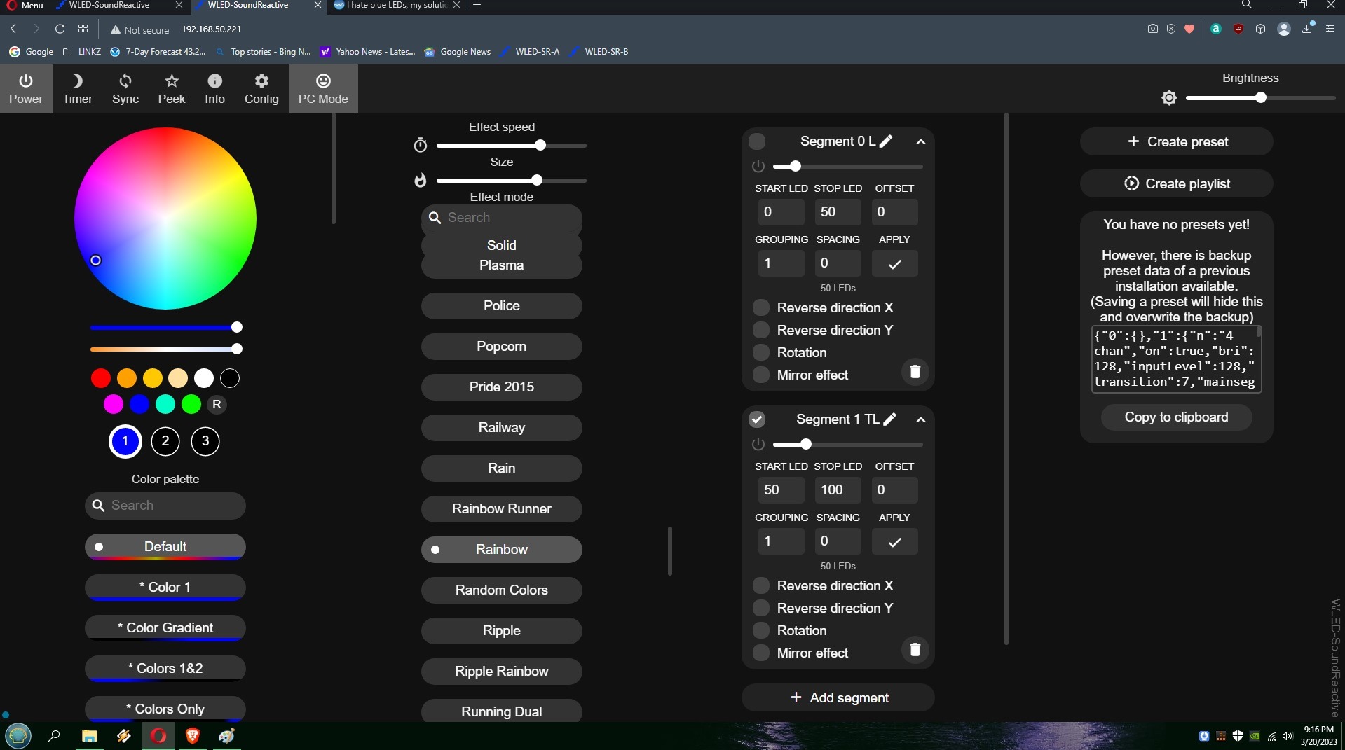

Yeah , red/blue is nice. Many shades of pink to violet. I use dual ESP32s's with WLED SR on 600 rgb's. The chasing and colors are cool , but I use
Mic's and a buffered LM324 input for the worlds most advanced VU meter.... hehe. I use 3 channels on each ESP , 1 channel on each for L/R.
Web interface to match my PC music collection. Phone app controlled , too.
OS
I can burn through 6000mA @5V LED current , Had to actually buy a 10A china supply. WS8211/12b led's can be programmed right at the chip to limit ...
10mA , in my case. Can't wait for the Xmas tree - next year.
