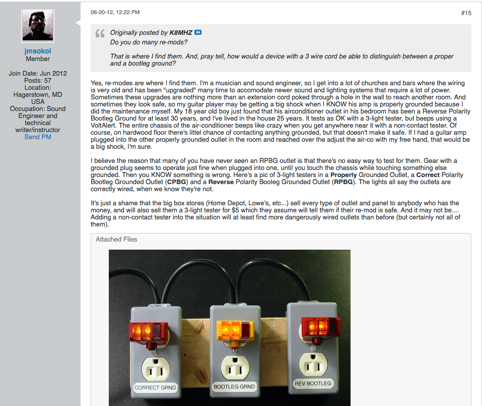

Unfortunately, Mr. Miyagi would also have to say "Three-wire cord no can defense!" against a RPBG (reverse polarity bootleg ground) grounded 3-wire outlet. RPBG are most common in remodels of buildings converting two wire installations (common in wiring installed before 1965) two "grounded" three-pin outlets.
This type of miswire could easily be done by anyone "before they had their morning coffee" as evident in post #19 in this thread where "wiseoldtech" forgot that "it's the little guy that gets you".
A RPBG will test "OK" with a 3 light plug in tester, and even with a VOM.
Testing for a RPBG can be done with a non-contact voltage tester (NCVT). When this tester is used on a properly wired outlet, you’ll hear a beep or see a light only when its tip is inserted in the “hot slot” of an outlet. However, when this type of tester gets near the front or ground contact of an RPBG miswired outlet, it typically beeps/lights from inches away, because the internal ground strap in the outlet will be biased to 120V, which provides a large electrified surface area.
Failures in Outlet Testing Exposed | Electrical Construction & Maintenance (EC&M) Magazine
As a sound engineer, in the "old days" I always used the fingers of one hand to test for potential voltage between a guitar ground (strings) and PA ground (microphone Pin 1/ case), but a NCVT can save you from that tingle when outlets are mis-wired, or the "death cap" has started to dry up.
The bottom line is don't assume a 3-wire plug on your guitar amp will keep you safe, always test between the amp chassis/guitar strings and any thing else you might make contact with.
