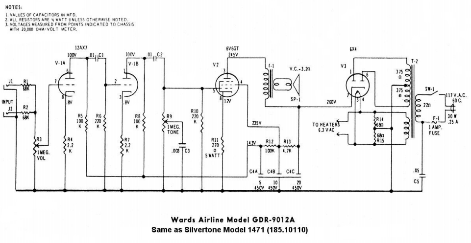

It's an Airline/Wards 62-9021A. I just got it today and love the tone of this. However when I went to adjust the mic I put in front of it ZZZZAAAPPP. I got shocked.
Attached is the schematic:
Link to PDF: http://www.silvertoneworld.net/schematics/silvertone_1471.pdf
It has 2 transformers and the original 2 pronged power cable that I am aware I should change. I am comfortable with a soldering iron. I tend to learn tube amp stuff every couple years and then completely forget it all.
So I am humbly posting here to see if any of you very generous and kind folks can start my on my journey to making this safer to use. I have a little one at home now and I'm so worried she's going to wander into my studio and get hurt.
Thank you so much!

Try reversing the power plug in the wall socket. If the shock problem is gone,
remove or replace the C5 capacitor connected from the AC line to the chassis.
It should be an X rated capacitor.

Start by removing C5 the so called "death cap" which is probably responsible for the shock you received. Next install a 3 wire power cord and ground the chassis.
If you then have a ground loop issue take a look on the Rane website for their ground loop app notes which will detail several solutions.

Thanks! Do I need to replace it or is it fine if it's just totally gone?
Side note: as a note decays I can hear what sounds like a tremelo effect when it's very quiet. Is that something I need to address?
Is there a guide you'd recommend that can explain how to do the 3 wire power cord?

I would completely remove it for safety. Others will soon chime in with some more practical considerations.
I'd also recommend at minimum replacing the multi-section electrolytic cap in the power supply. (and soon unless it's been replaced already)

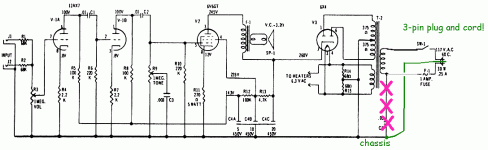

Power wiring: I'd recommend rewiring..
Black > fuse F1 > SW1 > transformer lead.
White: Other transformer lead.
Green or Green/Yellow: crimped ring terminal bolted directly to the chassis.
Use a suitable grommet and strain relief to secure the new power cord.

Attached shows the minimum change to reduce potentially lethal shock.
Since we now have a 60:40 chance of knowing Hot from Neutral, Kevin's plan to put switch and fuse "properly" is a wise choice, though not essential for playing. (It reduces fuse-change hazard, but IMHO you should *always* pull the plug before playing with the fuse.)

Let’s examine the schematic for the Silvertone (Sears) 1448 guitar amp which borrows its design from an old radio. Look at the schematic:Error 404 - Page not found
Follow the line which represents a wire from the bottom prong of the power plug on the right side of the schematic diagram. It goes to the switch, then goes along the bottom to the left to a pair of components, resistor R5, and capacitor C3 (AKA, the DEATH CAP). From there it connects directly to the metal chassis, which is connected directly to the input jack. The only thing separating your guitar from the wall outlet is a cheap capacitor made of paper, which is now 60+ years old. Would you trust your life to a 60 year old piece of paper? I wouldn’t, and neither should you....that’s why it’s called the DEATH CAP.
Note that this particular amp has a small transformer to isolate the heater circuit of the input tube. This mitigates another common failure and possible path for power line current to flow to the input jack. It is possible and not uncommon for a short circuit to develop between the heater in a tube and its cathode. In a typical transformerless design, such a short would put power line current directly on the input jack, and thus the guitar cable. My obvious question here is that if you were willing to put a small transformer in this amp to eliminate one possible shock hazard, why wouldn’t you put a larger transformer in the amp and fix ALL of them?
So, how to we fix a transformerless amp? There is only one way....put a transformer in it! Fortunately for small amps such as this a small transformer that costs under $20 and a 3 wire power cord are all that’s needed. There are transformers made for this purpose called isolation transformers. They come in various power sizes, and you must choose one that will work with the power line voltage in your area. The schematic here shows 117 volts / 40 watts right next to the power plug on the diagram. That means that we need a transformer capable of 40 watts or more that works on a US spec 120 volt power line voltage. Here the Triad N-68X will work and it’s $15.81 at Mouser. A larger amp will require a larger transformer.
Once an isolation transformer has been installed in this Silvertone, the buzzing sound can be fixed by replacing the three section cap, C5 it has surely dried out inside, and many of the other caps are probably dead or dying.
Thanks. Is it important to know which of the wires on the transformer are what? I couldn't figure out how to tell them apart.
Also, I wired the switch in series with the fuse like kevin suggested. BUt your diagram is different.
No. Same as an old-style lamp-plug with two equal blades: it works either way round. US-only market power transformers are usually two black wires.
Kevin's plan for fuse and switch *may* reduce the hazard of fuse-changing *if* the H and N leads are for-sure right. In my last kitchen, 60% were wrong. His fine plan with my miswired kitchen would often leave the part-open fuse-hold HOT. My policy is to UN-PLUG before messing with a fuse-cap. This is indeed what we are supposed to do with "plug connected appliances", which do not have to follow special rules for permanently wired loads.
Thanks so much! I've got everything wired up and it sound great! No shocks and hopefully no dead kid because lord knows my wife would REALLY complain when she sees a new guitar or amp if that happened.

C5 isn't needed if a polarized 2 conductor cord is used - remove it.
Just make sure the wide blade of the cord's plug is wired to SW1, the switch.
I just tested. It's not. I'm not sure who to trust. You or Kevin.Just make sure the wide blade of the cord's plug is wired to SW1, the switch.
