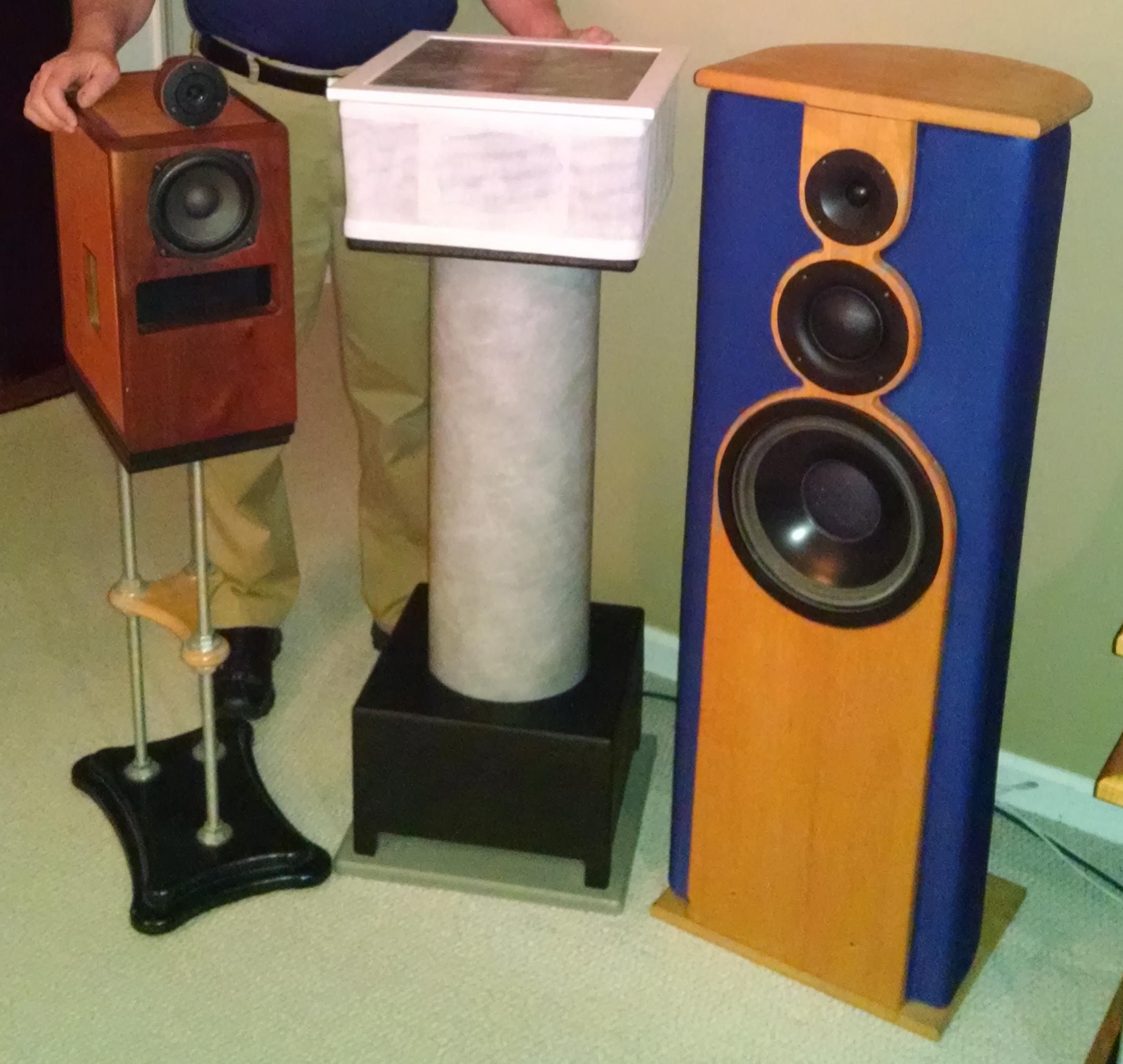

I just recently finished refoaming the woofers in my main speakers that I designed and built 28 years ago! I'd never attempted a refoaming before and was extremely trepidatious about it because the woofers I was about to operate on are no longer made. I used the Simply Speakers kit, kept their YouTube demonstration running while working on it, and everything turned out fine. This has given me the confidence to try refoaming another couple of pairs of vintage woofers that I have lying around and I'm sure the process will be much easier having worked through it already.
These particular speakers are some of the first that I designed from scratch. I designed a 3-way aperiodic damped cabinet that employed MDF plus 12" Schedule 40 PVC pipe cut in half lengthwise. The face and end caps were made from solid rock maple that was left unfinished in order to hasten the color change from almost white to honey. The rest of the cabinet was wrapped in navy blue lycra over 1/2" foam sheet. I get compliments on the look of the speakers even today.
Components used were the Vifa H25TG05 horn-loaded tweeter (still available today as part of the Tymphany family but apparently now with a titanium diaphragm rather than the doped silk of the original), the Vifa D75MX 3" dome midrange (now marketed as the ScanSpeak Discovery D7608/9200-10), and the mighty Madisound 10208 10" woofer (sadly no longer made). Each tweeter and midrange driver had its own isolation chamber to reduce backwave interference and each woofer cabinet employed 2 Dynaudio Variovents (no longer made, I think) for the aperiodic damping.
The crossovers were designed and built by Madisound from the cabinet and driver specs I provided. (30 years on and I still suck at crossover design; hence my newfound appreciation for full range drivers.) My cost for all of the drivers plus crossovers, gold binding cups, Variovents, and shipping was $274.75 in 1988 US dollars ($557.94 in 2016 USD). Even back then these speakers were being favorably compared to commercially available units selling for $2500 or more ($5000 in 2016 USD).
My long-winded point is that you can invest a relatively modest amount of money and time to get a comparable 10x return on your investment. All of this plus the satisfaction of designing, building, or even just assembling something with your own hands. For what it's worth I'm attaching a photo that includes the aforementioned speaker. It's the one on the right and the curve of the top cap mimics the curvature of the PVC pipe that comprises the back of the speaker. The other two are different quarter wavelength transmission lines that were built in the early 1990s.
