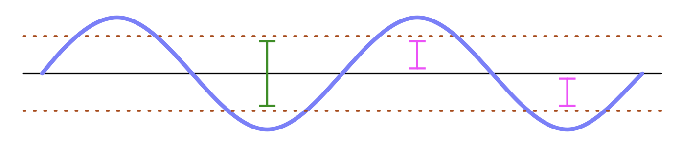

Power dissipated in a Class AB output stage:
That's from: https://neurochrome.com/pages/thermal-design
In the equation for the power supplied by the power supply I do include the bias current, but you can ignore that for simplicity:
Still only three variables (and some constants). That's from here: https://neurochrome.com/pages/power-supply-design
But, more energy is being delivered to the load, so the net power consumed from the supply remains somewhat close to constant starting at ~15W output power.
Really? So the amp delivers more power to the load but somehow the power it draws from the power supply remains constant from ~15 W output power. Fascinating. Where do you suggest the power that's delivered to the load comes from?
