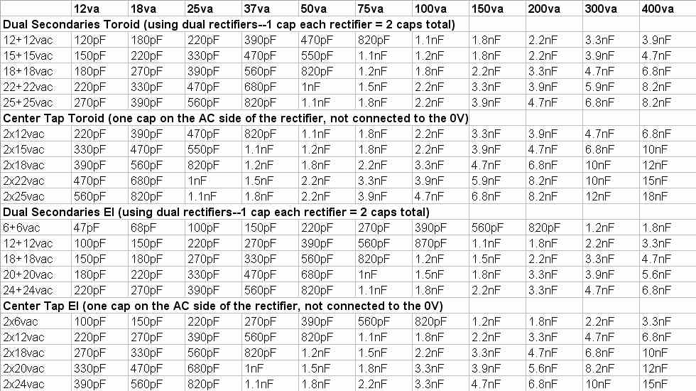

In a closely related topic, here is the capacitor chart to accommodate various size inductors so that they perform with less ringing. In this chart, the inductors are power transformers, not voice coils. This chart can do 1 cap at the ac side of the rectifier or 1 cap of that same value paralleled to each of 4 diodes (as seen in radio).
Unfortunately, if the capacitive effect is wrong then the inductor's ringing may worsen. So, its necessary to be specific in order for this sort of thing to work.
