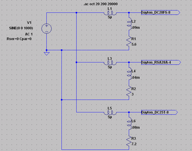

It's an easy problem. You have a voltage divider with the upper arm looking like 3 milliohms and (if you're nutty enough to space your wires 50cm apart) 5uH. The lower arm will typically look like 5 ohms in series with 25uH (taking a typical value for a dome tweeter). I think you can do the RMS sums.
While you're punching keys, try using a realistic inductance and series resistance value for 12 gauge zip cord. This is so far into insignificance, you might as well worry about the north-south alignment.

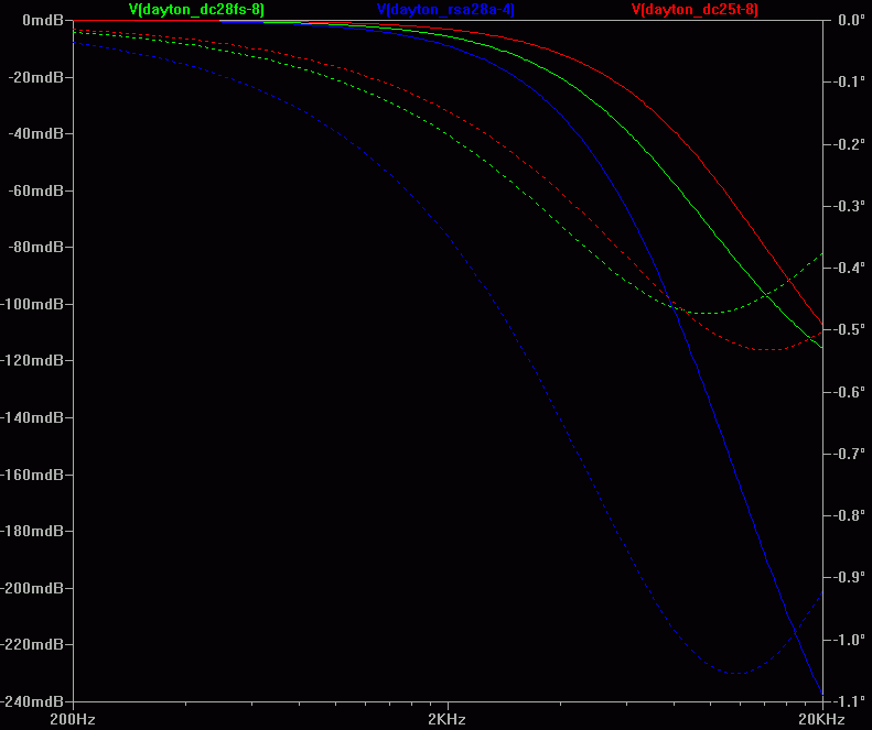

Oh you wacky hair-shirt guys, when Spice is a free download and doesn't require a slide rule? Results for three Dayton tweeters, because they're popular and well documented. One 4-ohm model for excitement. Speaker cable resistance and amp damping factor ignored as scaling factors moving the curves and down uniformly. Of course, this is only applicable to bi/tri-amp devotees.
Hey, I'm old school. I figure this stuff out with pencil and paper.
Now, since you have your Spice box out, try inserting the parameters for 4 meters of good old 12AWG zipcord (which is a far less oddball approach than 50cm spacing). 1.5uH, 26m ohm. Noting, of course, that even the Crazy Eddie approach doesn't show anything significant.

Thanks, that corresponds pretty well to my guesstimate, i.e., 67% of ****-all, as Tim de Paravicini would say.

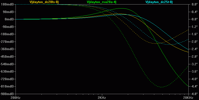

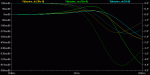

For final fun, here are the same tweeters driven by the pathological cable but this time first-order crossed over with a single cap, looking at voltage at the crossover input. Now the speaker cable interacts with the complex driver/cap impedance. Note the obvious bump at the crossover frequency and keep in mind this appears, within the limits of the other driver impedance, across all the drivers.
Nice one, rdf. So with the pathological wire, we have 0.1dB, edging toward barely audible. And I mean "barely." EQ via wire. With zip cord, the relative deviation should work the same way as before, i.e, dropping the EQ by about half?
More like a half dB over a couple octaves. No claim of smoking guns, I've just hated simplifying assumptions since my EE profs instructed to get within a factor of ten and finalize on the bench. Into a low impedance, high order multi-way the RLC of the ubiquitous 16 gauge recommendation could reach audibility on complex impedance alone, without the help of magic and the spirit world. That last post was to suggest it's worth a look.
Edit: it occurs to me now I first simulated this on punch cards!
??? 100mdb= .1db

Peaks a little over 100 mdB at 3kHz, down around 400 mdB by 6 kHz, so I was in error. Around half a dB in a single octave. Almost 1 dB down in two, not that I put much weight is such a simplistic analysis.
