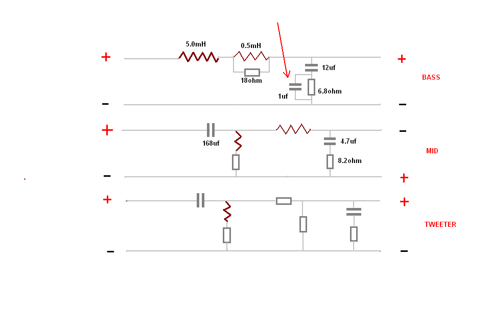

Fredex, surely the effects come from the speaker, thus explaining why it is larger on the speaker side, Point is you can now see differences measured on either side of the cable that were not the case with a resistive load. Now it is possible to see that different cables produce different results.
This put a big question on the normal 'measured into 8 Ohm' specifications of amplifiers.

Look at the 1uf bypass cap (red arrow)
It makes quite a difference
Some might know how much signal is attenuated where its active
