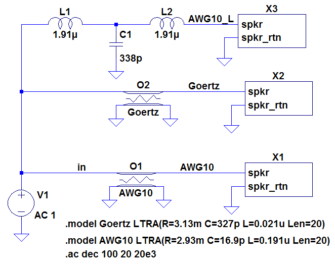

A while back I did a SPICE simulation to see what kind of frequency response differences would occur for different cables with a "typical" loudspeaker as a load. I looked at the data from the audioholics.com article I posted earlier and found two cables that were at the extremes of L and C. One was some Goertz cable and the other was simple AWG10 zip cord. The data for the two cables were as follows:
Goertz:
L=0.021 uH/ft
C=327 pF/ft (!)
R=3.13 mOhm/ft
AWG10:
L=0.191 uH/ft
C=16.9 pF/ft
R=2.93 mOhm/ft
To model the cable, I used the LTRA model, which implements the Telegrapher's equations directly, assuming R, L, C and G are independent of frequency. For the speaker model, I used the one from Stereophile. I assumed a cable length of 20 ft. Below is a plot of the two cases, scaled to be both equal to 0 dB at 20 Hz:
The differences look pretty small to me. There was supposedly an Audio Critic article that showed similar computations, but with much larger differences. Does anyone know where that is, and if there's enough information given to duplicate it?
The LTspice simulation file that generated this is attached below. It's a zip file, as the Stereophile speaker load is in its own subcircuit, requiring separate files.
Andy C,
If you modify the voltage source to look more like a real power amp's output (output resistance of a few tenths of an ohm at higher frequencies; quite a bit more for non-FB SETs and the like) you get on the order of a half dB difference or more at HF.
edt: oop, sorry I was confusing phase and mag curves. Though now that I think of it, I dont' see why differences appear when all are driven from the same point.
edit again: ah, the scales are changing. Never mind!
Looks like a little over a tenth dB with 0.2 ohm source resistances in each separate line. Not huge, true
I just re-ran it in an attempt to crudely model a solid-state amp. I assumed its output impedance would be dominated that of its parallel R-L network. I assumed 2 uH in parallel with 4 Ohms. This gave a bit less than 0.12 dB difference worst case. I guess if one were to model a SET, the differences would be much bigger, but I haven't tried it.

Andrew,
To be sure, even if your amp had a perfect, flat, zero Zout output stage, you would still have the effects from cable parameters on whatever the speaker 'sees'.

For those who don't have LTspice, I've posted below the schematic used to generate the graphs shown in my earlier post. The "amplifier" was modeled as an ideal voltage source, so the effect that's plotted is only an interaction between cable and speaker effects. The speaker model, shown as a box, is identical to what Stereophile uses in their amplifier reviews.
