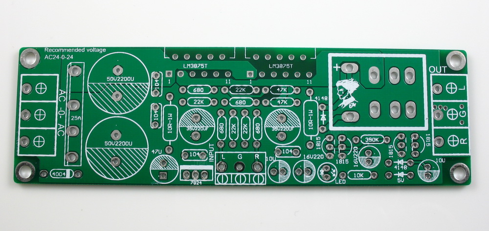

Just got my board, based on the info in this thread, should be a simple build. Board is of very nice quality.
One question: It seems there is a difference opinion on the need to remove/keep the bridge rectifier if inputting DC ...

Not necessary to bypass the rectifier. Run the external DC source to the AC input. You loose a few diode forward voltage drops, minor loss, great convenience.

By the way, in order to use an external power supply board you don't use the onboard rectifier and you need to jumper holes 1 and 3 for the rectifier and connect the +V power supply to pin 1. This powers the +V rail and the soft start circuit. Connect -V to hole 4 for the rectifier.
Of course, both can be correct, any thoughts on a best practice?

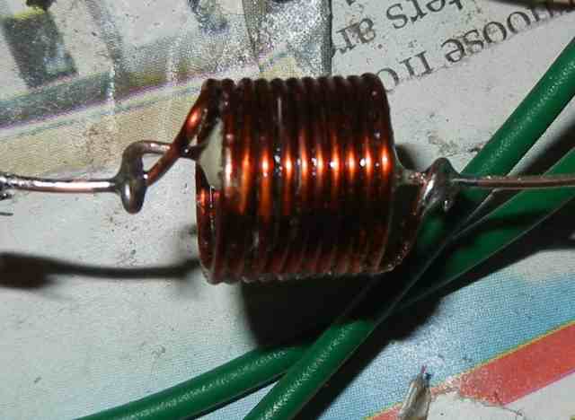

The amp sounds very good but I felt it's a bit too sharp at times. I added the inductor (0.7uH) and 10 ohms parallel resistor in series with the speaker. On a quick listen I think it eliminates that occasional sizzle. Not sure if that's the mind playing tricks but I feel it sounds better.

The coil is a 0.9mm enamel wire wound 11 turns on a 9 mm former ( ball point pen casing !) . It's just about 10 mm long . I placed the 10 ohm 1 watt resistor inside the coil and soldered the coil leads to it.
Just in case anyone wants to know how I actually wound the coil.
I took a ball pen casing ( 9mm dia) and removed it's end cap. Wrapped four layers of plastic sheet on it ( regular outer plastic wrapping from a box) . Then wound the coil on it and dropped instant glue on it. Held it for a short while till it set and then after it was fully set ( about 15 minutes) I slid it off the former. The plastic sheet sticks to it but can be easily removed. I had an enamel remover liquid which I used to remove the insulation. Easy but very corrosive liquid. I accidentally spilled a drop on my hand and it burned it though I washed it immediately. It now has a brown mark like a regular 'fire' burn ! If you use such a thing , be VERY careful. Safest is to just scrape off the insulation with a sharp knife!

How do the speaker connections work?
Dear all;
A quesiton: Typically, there are 4 connectors for the speakers.
On this board, it comes with a Left-Ground-right set of connectors. How do I wire the "classic" Red-Black Red-Black speaker binding posts?

You need to join the ground of the speakers together and then attach it to the board. You could solder them directly. If you have a dedicated supply and case , you could do that.
The input is dc coupled and you can also by pass the NFB capacitor. There is a relay protection and so it should be safe...I think.

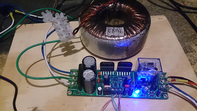

Pretty simple build
This was a very straight forward build.
Glowing blue LED, and stereo output on the first go.
Based on garage speakers, sounds much better than the 12V class D that I have been running as a shop amp.
Next step get it in a case. Big decision is should I go integrated with my cheapo E-bay tube buffer, or wait a bit till I get around to building a real tube pre-amp by hand. Integration will be side by side, not a single build.

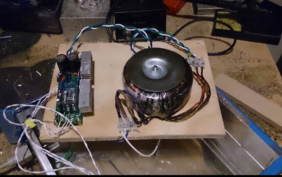

got mine all built and in a chassis
Next question, how much hum is normal/acceptable.
With my ear on the speaker, the hum is quite audible. By about 1/2 a meter away, can't hear a thing.
Is this OK, or a grounding issue??
