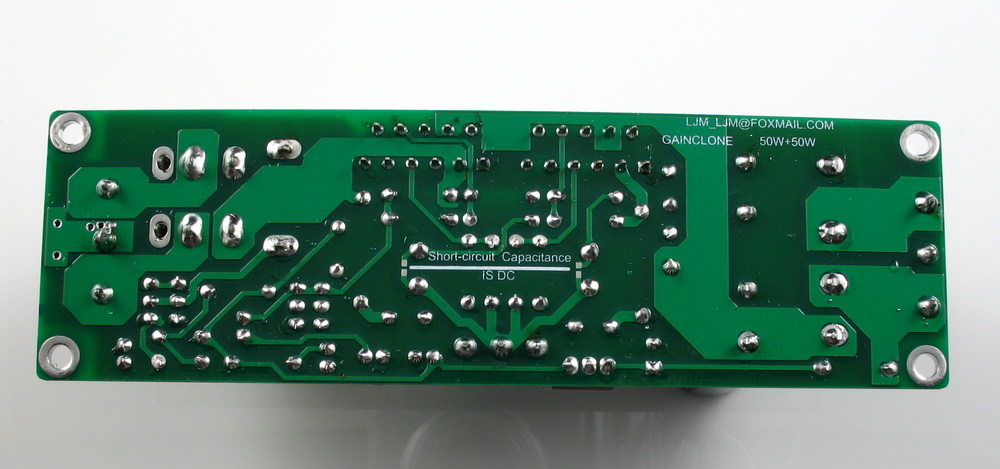

Backside of the PCB, DC location, said the short here, the negative feedback using DC.
I've just seen your kit and I have a question. What is this DC jumper in the backside of the board? What does it do? Is it important?
RGDS
This was a very good design, better ones I saw were often for one channel only. But after combining two boards into stereo amplifier, most are not better design any more.
I wish I can find LM3886 board having better design, so far none. But LM3875s are more expensive and have less output power.

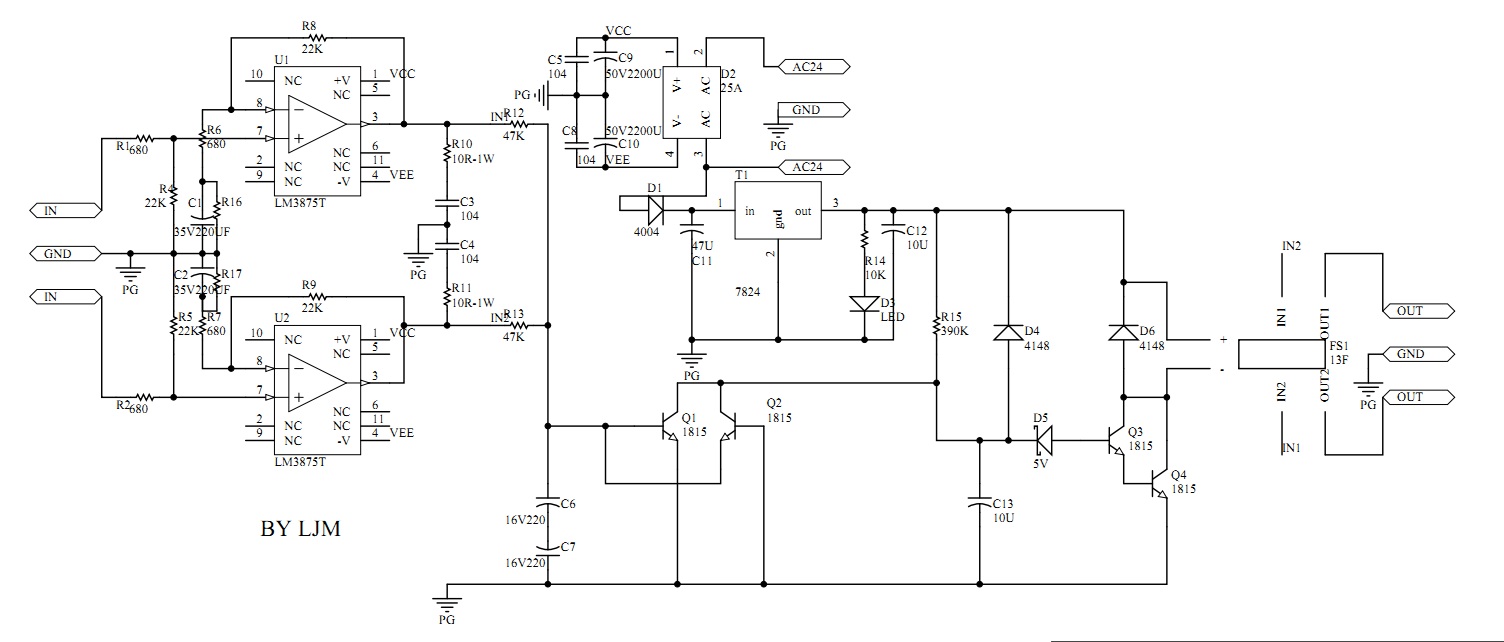

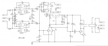

According to ljm_ljm schematic ( View attachment 339310 ), is it possible to add a switch to these points ( View attachment 339311 ) to "SWITCH" between DC coupling and Capacitive coupling?
Thanks, Pemo
Is a convenient shortened C1 C2 way.
I think the tin, will be more stable than pin.
Don't be in general.
It will bring higher DC output.
Although the voltage is still very low.
Hi ljm!
I'm a newb and I have a couple of dumb questions. While I do understand some of the basic things in the circuit, I don't understand this:
1. Why would we need Q1, Q2 followed by a Darlington pair Q3, Q4 when the IC itself is quite capable of giving out several watts?
2. If there was nothing else (the transistor circuit part) to be used after the ICs, we would have outputs (L/R) right after R12 and R13, right? Then how do we get L/R channels after they have been shorted out and fed into Q1?
Again, I think my questions are kindergarten level stuff, so please point me in the right direction here. If there is anything I could read-up which in turn would help me figure out the things here, please let me know.
Thanks in advance! :)
Aashish
Good questions Aashish. I'd also like to know how the L/R channels are regenerated after being connected together after the 47k resistors. It seems a bit of an odd arrangement. Maybe someone can explain what going on for us mere mortals?
