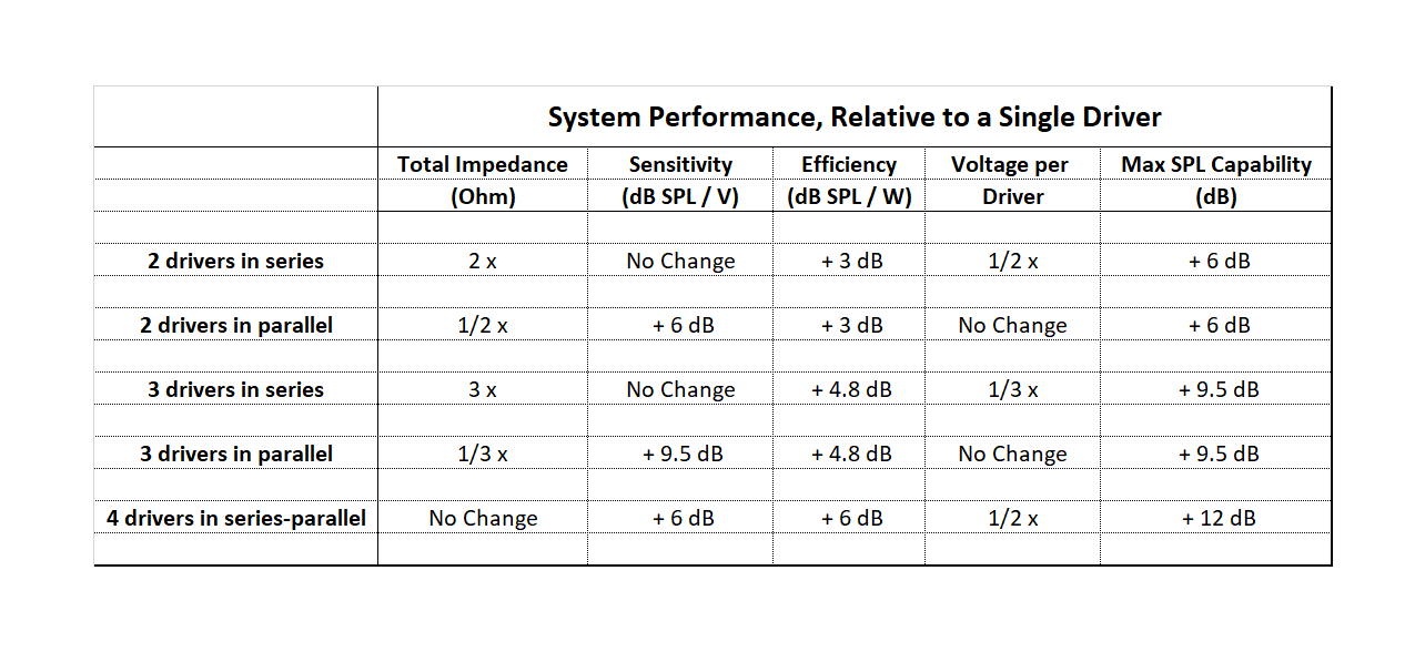

@BKr0n, don't mistake sensitivity with efficiency.
Take a single woofer as our baseline. We'll use an infinite baffle to avoid complicating the situation with changes in the box loading. We'll use a fixed voltage from the amp - no touching the volume knob here!
Add a 2nd, identical, woofer in series. SPL stays the same, but current & power drop 50%, because the impedance doubles. Same SPL at the same voltage = same sensitivity. Because power is only half, however, the 2nd woofer provides a 3dB efficiency improvement.
Now, change the woofers' wiring to parallel. Impedance becomes 1/4 the series connection's (half the baseline's), so current & power increase by 4x (double the baseline). 6dB more SPL at the same voltage = 6dB higher sensitivity. Compared to the series connection, the efficiency does not change, because that extra 6dB SPL requires 6dB more power.

Not quite correct, this. Coherent identical sources add up to +6dB. Radiation impedance is a funny thing.Add a 2nd, identical, woofer in series. SPL stays the same, but current & power drop 50%, because the impedance doubles. Same SPL at the same voltage = same sensitivity. Because power is only half, however, the 2nd woofer provides a 3dB efficiency improvement.
3dB from the 2 sources and 3dB from half th impedance.

No, actually two identical and coherent sources (loudspeaker units) closely spaced will double the sound pressure level at some distance. So +6dB with the same current through each of the two voice coils as with one coil (in parallel the total current doubles).
In series the current halves, (Impedance doubles) but since both sources still are coherent, half that total current will lead to the same SPL as that of one source. That is to say, as long as you can argue sources are coherent, which likely is the case at low frequencies with wavelengths being bigger than the speaker system as a whole.

2 drivers run in parallel give 6 dB increase. +3dB from having 2 drivers and 3dB due to the halving of the impedance.
2 drivers run in series give0 dB increase. +3dB from having 2 drivers and -3dB due to the doubling of the impedance.

Both or neither, depending how you look at it, I guess. Whatever EQ you run, the speaker/amp combination needs to be able to reach the SPL you require. There are WAY too many variables to tie that down to only one.So in the case of a Linkwitz Transform, would that be more related to efficiency or sensitivity?
E.G., put 4x E150HEs in 20L & connect in series, and the amp probably clips at its maximum voltage before approaching any current/power limits. Change to parallel, and it's probably the other way around. Swap to 2S2P in a 200L box, and the woofers probably bottom before the amp gives up. Etc.
Spend an hour in VituixCAD's enclosure tool. Try different #s of drivers with different wiring. Change Vb & BR tuning frequency (watch the max-SPL line here!). Play with EQ options. Most of the time, you can put the cursor over a parameter, then watch the graphs while spinning the mouse wheel. That's going to help you understand the interactions a LOT better than anything I can write.

Halving impedance leads to more SPL with a voltage source, because if the voltage stays constant into a lower impedance then current necessarily increases. Same voltage but double the current leads to a doubling of power, which is 10log10(2) = 3dB more output. Then the benefits of improved radiation impedance comes on top of this, yielding 6dB increase in total.
The loudspeaker system has in other words become 3dB (or 100%) more efficient, and 6dB more voltage sensitive.
If the drivers are connected in series rather than parallel to each other, then impedance doubles, which means current halves. This way we lose 3dB sensitivity, but gain 3dB from improved radiation impedance. The end result is a system that has become 3dB more efficient, but with equal voltage sensitivity as the single driver case.

Hopefully this adds some clarity rather than confusion. I understand what @markbakk and @planet10 are saying, and I think perhaps they are talking past each other.
The simple case of 2 drivers in series, close enough to be coherent, there is a + 3 dB increase in efficiency because the surface area has doubled. The voltage seen by each driver is reduced by half. The net result is no change in sensitivity, but + 3 dB in efficiency.

Yes, thanks. A table's definitely better than paragraphs of text here. If I'd only realized how much debate would follow...Hopefully this adds some clarity rather than confusion.
