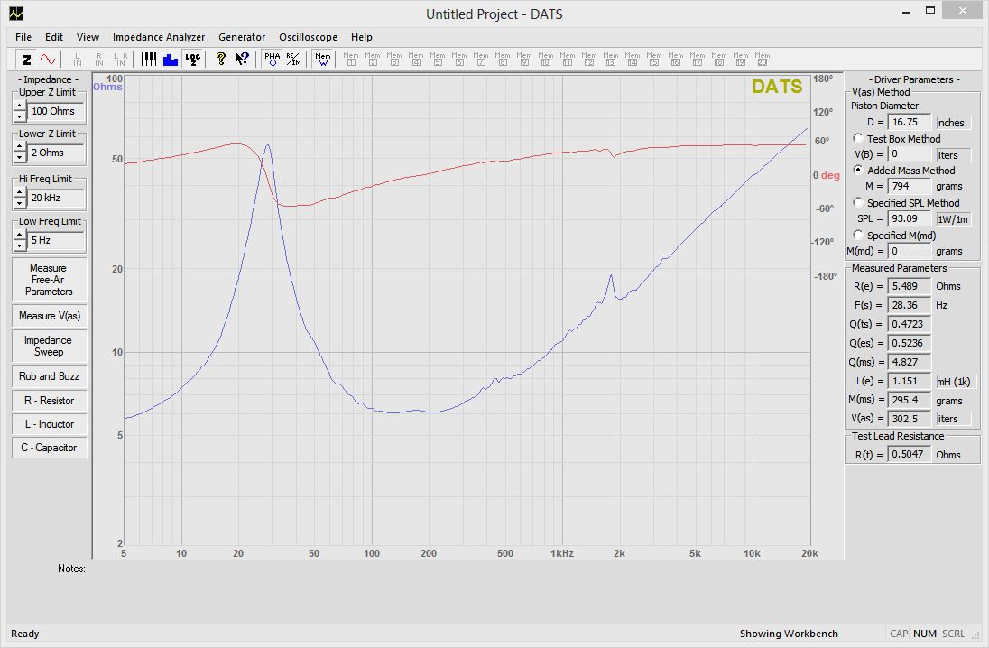

It is that was about 5-6 years ago. I have DATS3 but I still need a scale to measure VAS.unless it came with them.......🙁

Here isIt is that was about 5-6 years ago. I have DATS3 but I still need a scale to measure VAS.
Again, comparing specs using a Margolis/Small max flat BR for reference, the 2241 calcs a ~66.98 L/45.76 Hz alignment Vs the APX-1841-8R's ~617.27 L/22.31 Hz, so a very poor fit in the MP418's tiny box, though presume it can be DSP'd to work well enough.
In short, Qts' dominates until Vas is quite high, so either have to find a tiny Vas and/or low Qts' or some balance between the two along with an Fs within ~0.707*Fb to give you some port fine-tuning flexibility.

Thanks, you usually give out formula equation and such etc.
So, fb=70Hz and fs=0.707X70=49.5Hz
The measurement shown it measures down to ~50Hz and fairly flat to 100Hz which I am now cross.
In my situation getting a re-cone or buy another one wouldn't be an economic sense.
