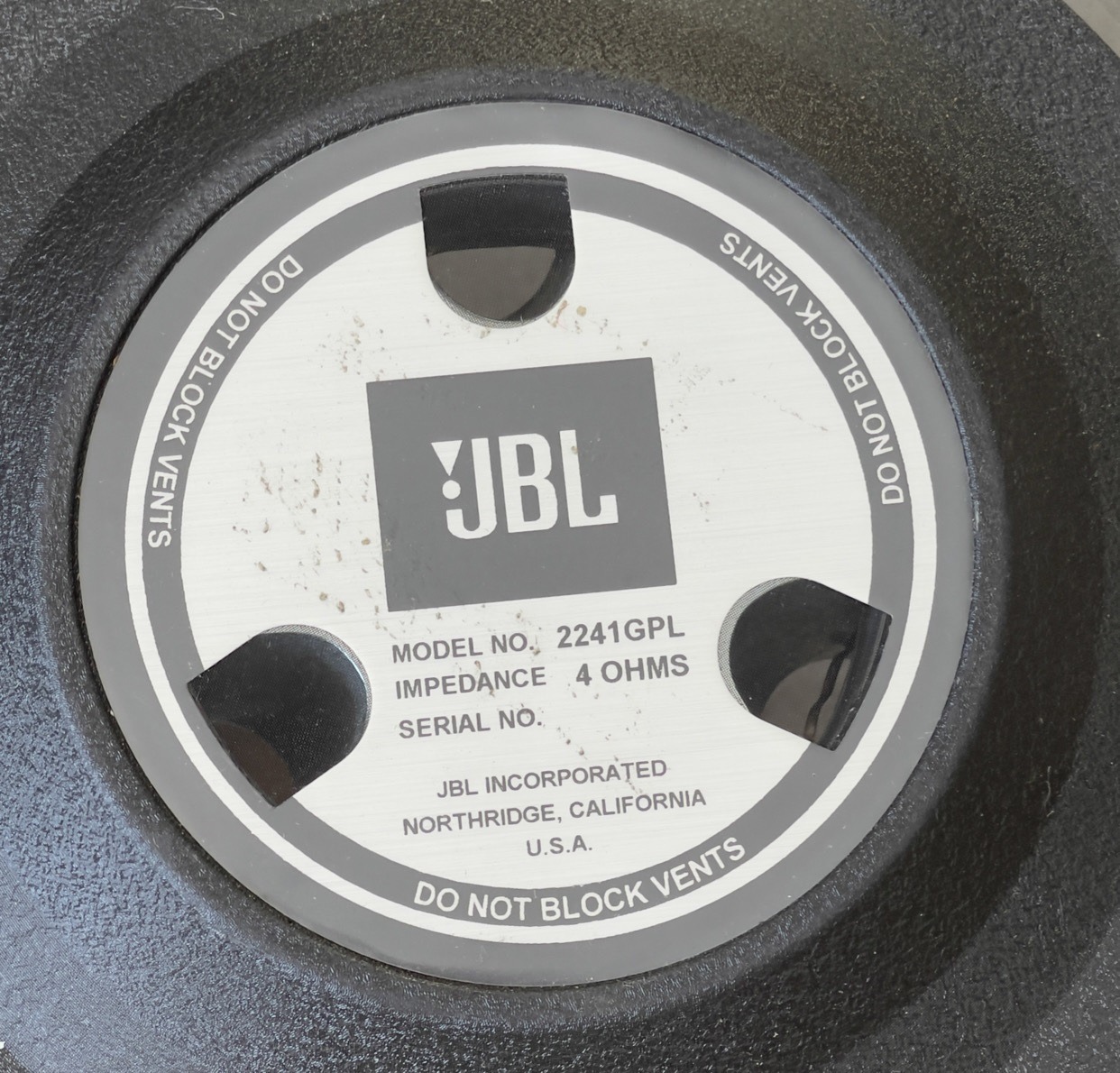

I blew up my beloved JBL mpro 418s driver

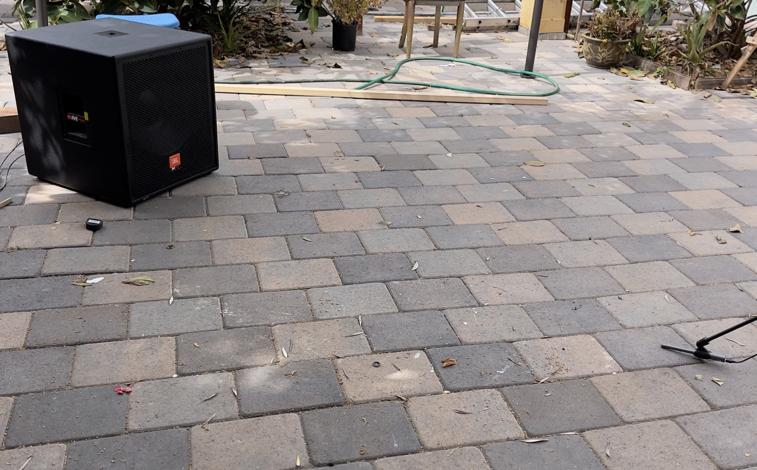

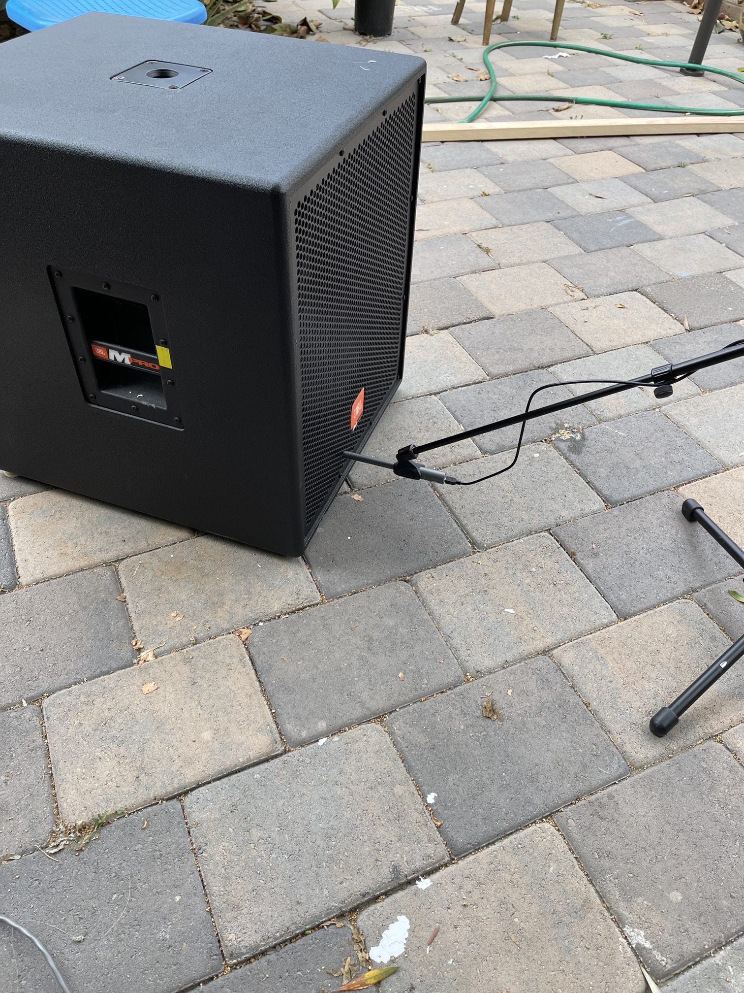

I was planning to take the measurement outside, but the weather was not corporate. There was no bracing on the box but will see whether it's needed. I want to keep it light as possible.

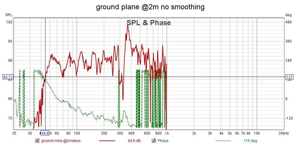

I did a measurement outside not ideal conditions but best as I can get.
The outcome disappointed thought I could get to 40Hz for PA application.
The new driver/recone 2241G is rather expensive for what it is.
I want to modify the cab for better suit with the driver. It's one way to learn:)

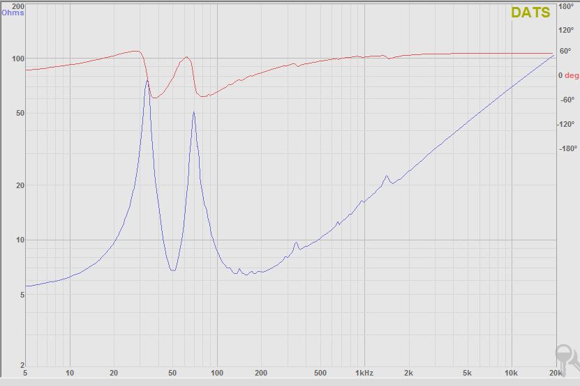

there is oscillating issue at 360Hz where it's also showed in imp sweep.

The box determines the tuning frequency of the system so it has to change if you want usable response to 40hz. Were you driving the 2241 at full power below the current box tuning? If so that may be why it failed. There are recone kits available for this driver both original and aftermarket that start at about $100, this can be a DIY project with the assembled version of the kit.
If you bridge the Yamaha you should have plenty of voltage swing to drive the B&C, but you still need a different/modifed box to get reliable output at 40hz.

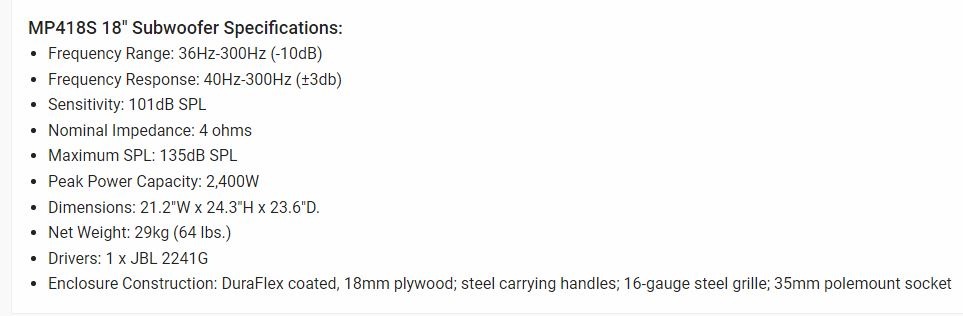

The JBL was spec 40Hz +-3dB. I wouldn't attempt to recone as I have no idea how to proceed and the chance of failure is rather high.
The amp was clipping for sure. There were some music bass notes playing a little longer than I thought so it's maybe it don't know ?

The "oscillating issue at 360Hz" is the port resonance, not really an issue as it would not be excited when crossed over in the 100Hz range as usual. The spec of 40Hz +/-3dB obviously is not true with a 50Hz Fb.
Presently, the cabinet alignment is near "flat", tuning lower in the same small box will roll off the low end.
Lowering the Fb to 40Hz by extending the port(s) would trade more 40Hz for less 50-60Hz.

I was not setting the Drive Rack correctly now I believe; Wish I could examine the voice coil it's long gone now.
