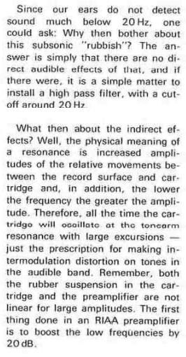

You look at B&K paper, yet seem to ignore paper's implications, starting with the title.
Could you possibly give me some clue as to what you are talking about?

Would a heavier arm with low compliance cartridge somewhat solve low frequency problem ? Would that be a part of the reason why people like Denon DL103 cartridge ? A digital RIAA Preamp with precise control over filtering noise and out of phase low frequency signals is possible. Isn't it ? May be that's why (I guess Mr. Jan. I think it was some other thread I dont remember. Pardon me if I am wrong) liked the sound of Laser turntable.
They only track better. The subsonic content is still to be found intact at the cartridge output.
Whether arm/cart resonance is well damped or not is a matter of specific implementation.

OK. I understand it somewhat. I guess record offcenter would also be somewhat contributing to subsonic content.They only track better. The subsonic content is still to be found intact at the cartridge output.
A little abstract thinking from my side. Would a two preamplifier be possible for low frequency range and high frequency range separately to have better control of filtering at both ends ? Also would like to know what is typical frequency range of surface noise of vinyl LP ?
