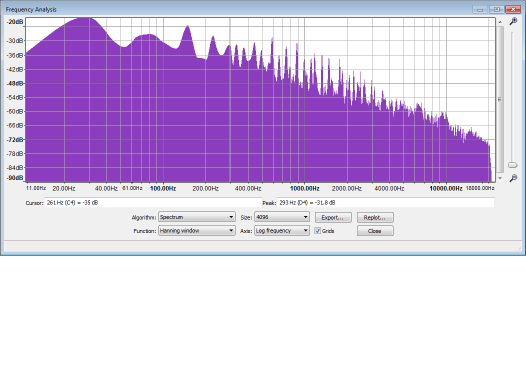

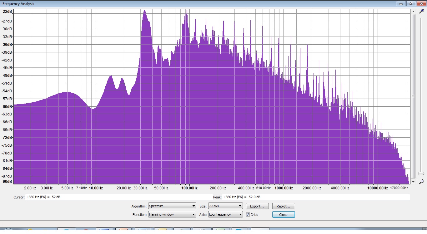

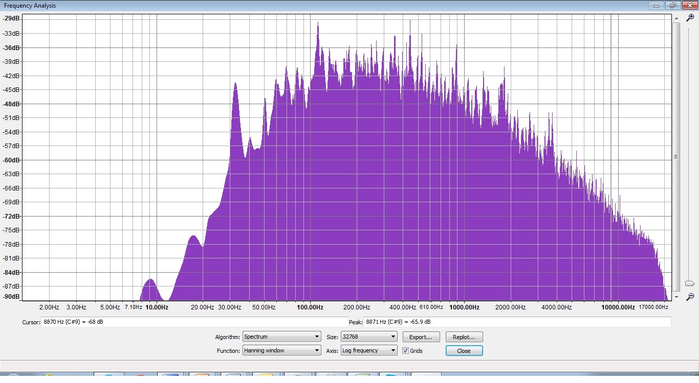

On the mastering side, which may be pertinent to the topic, in doing some digging last year I found that, in general if a 5.1 release has been done, the 2 channel layer has more low end than if something was just released in stereo. I need to analyse more but couple of examples.
First is Mahler 9 by the Halle recorded I believe in a fairly small space
second is shostakovich by liverpool phil on Naxos (so 2 channel). The last is Fucik (sorry for lack of accents) on Chandos, which was the red book layer of the SACD.
Too few points to make any meaningful conclusions and the amount of thump and bang on percussion will vary things a lot, but there is certainly something for me to dig futher on. It is a shame that gramophone don't bother with recording quality any more...

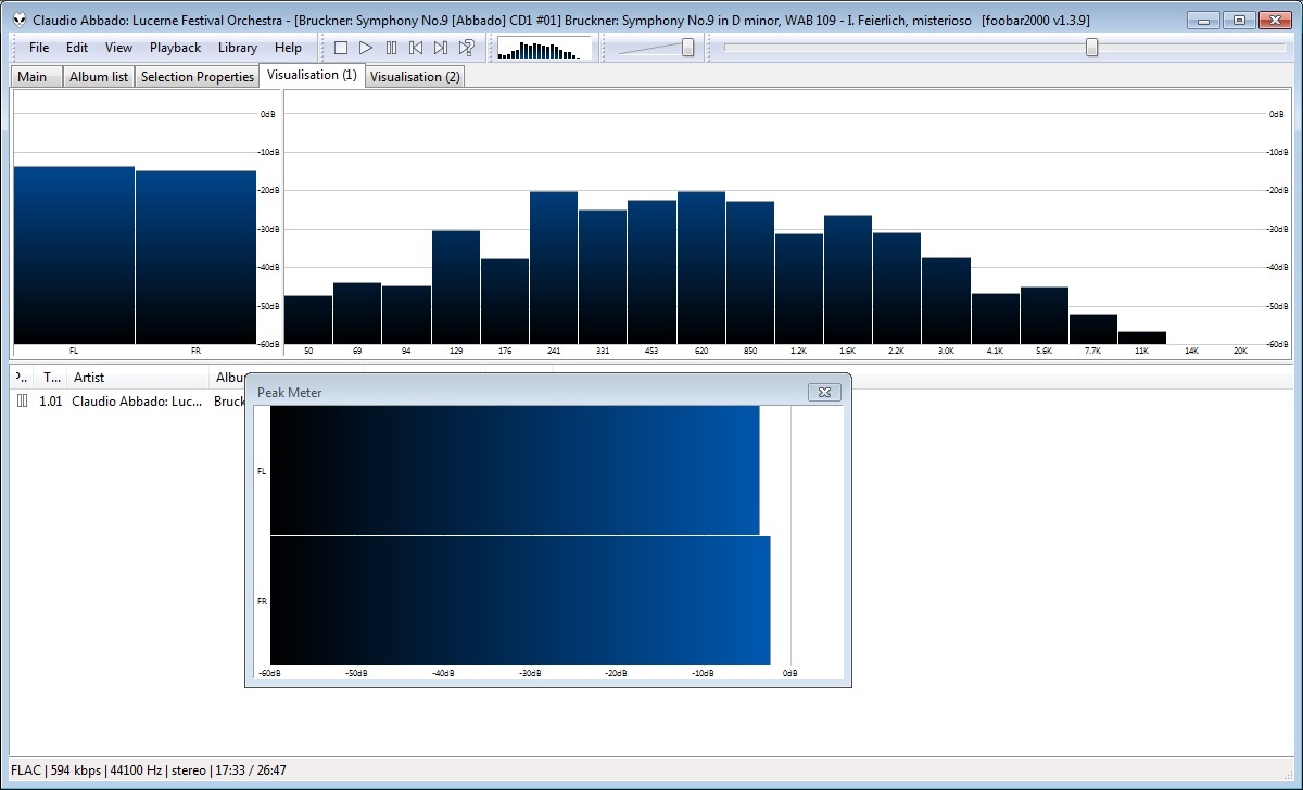

Except it's important to know how often that "peak" was reached. Was it "accidental" or "systematic"? Judging by RMS, it looks more like "accidental".
You never heard of crest factor? Note the difference between VU and peak on the screenshot. VU is within spitting distance of RMS as calculated here.
