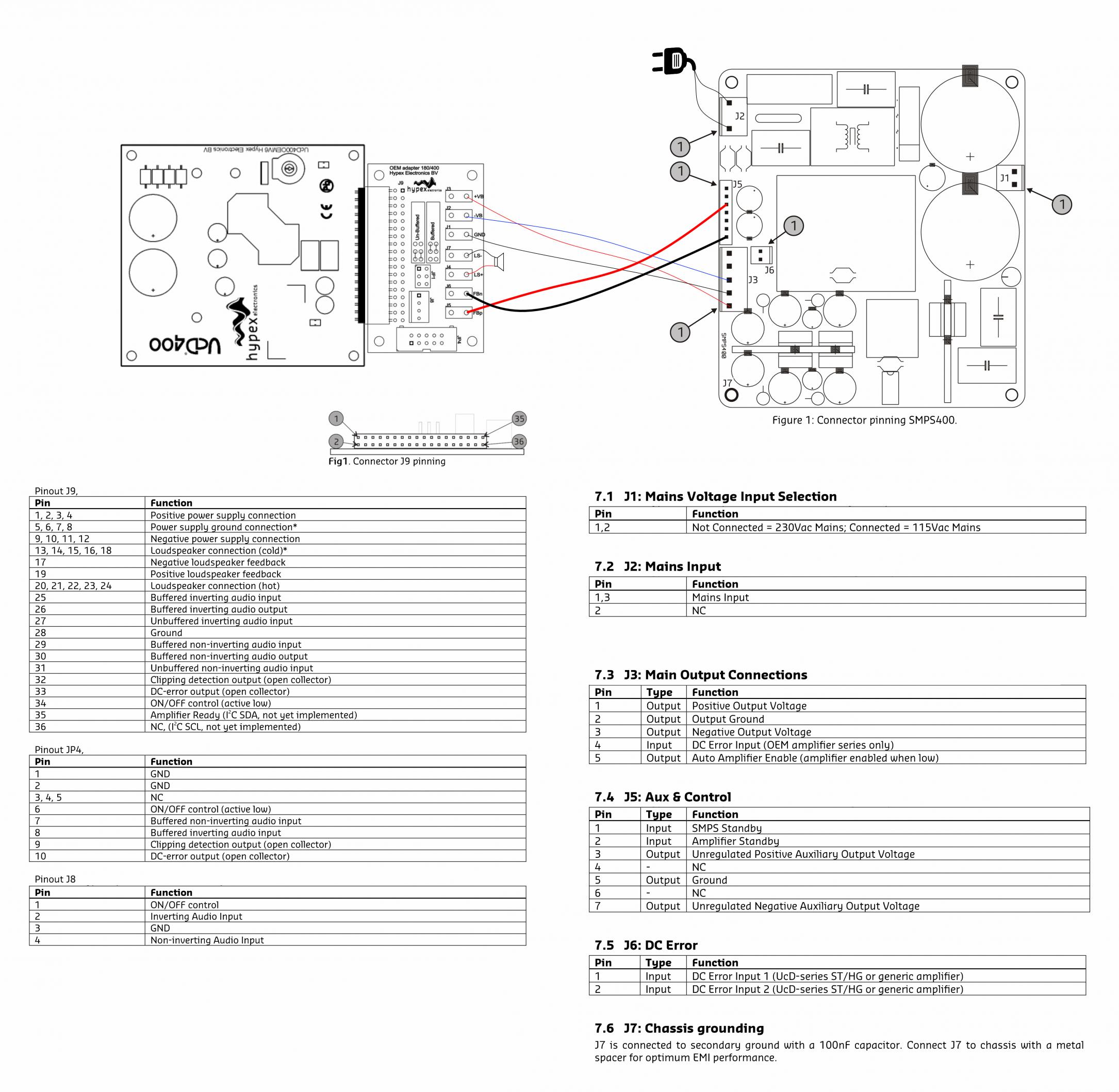

hey guys. actually I'm having problem wiring UcD400OEM to SMPS400. I almost did everything to make it sing but seems I'm missing something. I'm no expert in electronics. it would be great is someone can help me in this 🙁

Connect negative input and ground together at the chassis ground point on the rca connector and you are good to go. You need to connect on/off pin to power ground to trigger module on, as per the manual.
