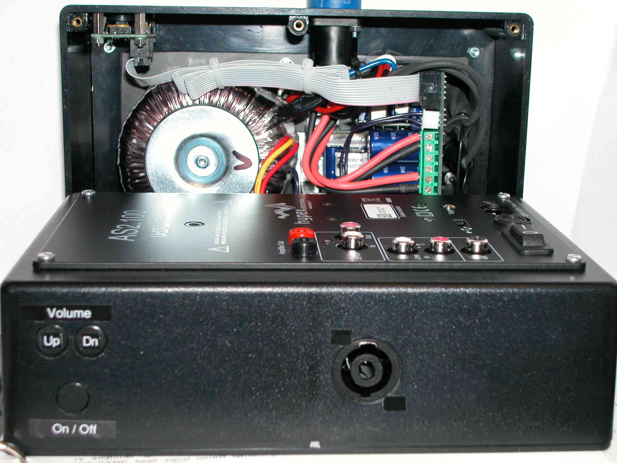

If you have dipoles or want to share between several speaker sets or don't want to cut holes in your best boxes or just want to experiment safely it's a good idea to box the AS2-100.
Multipurpose box 220x150x64 MB6 is one cheap solution. (CPC EN81783).
To prevent LF/HF cross-connection in two way setup use a 4 pole speaker connector eg Speakon NL4.
With the button PCB as I have it the IR receiver looks out the top of the box. I wanted the LED to point the same way. If you can de-solder the LED with out destroying it you deserve a prize.
All I have to do now is experiment.

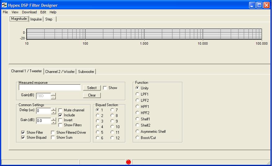

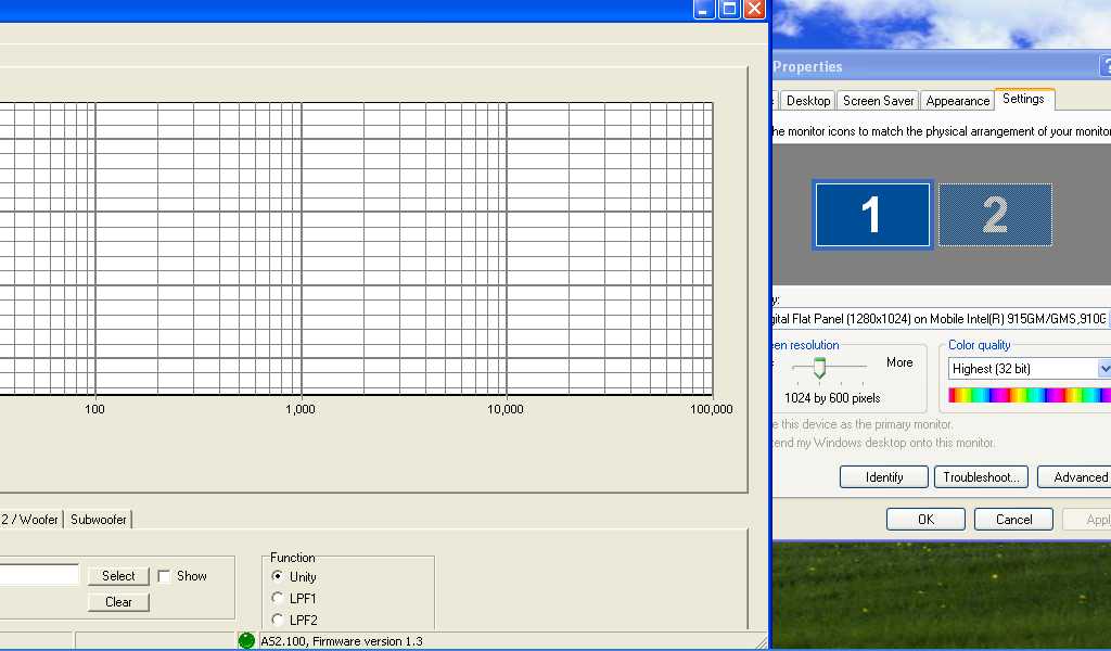

For convenience I put the control panel / filter designer software on an Asus Eee PC 900 NetBook (XP boot). The graphics chip set is Mobile Intel 915GM/GMS,910ML. The display is shown as Digital Flat Panel (1280x1024) but the maximum adjustable screen resolution is 1280x768. Unfortunately the Filter Designer screen only shows 3 functions, HPF1 to Boost/Cut are not accessible. If I plug in an external VGA monitor run at 1280x1024 and resize the window the graph stretches full screen and the extra functions are still invisible.
Back to the desktop PC...
