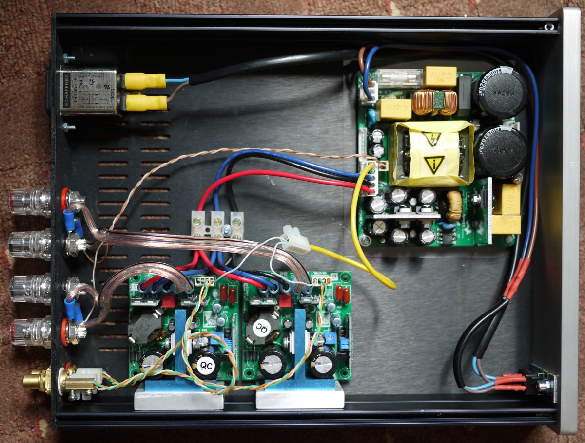

Last time I checked is was a 5V6. Which version (serial number) do you have?
I have SMPS400A180 ,0413A3054_1333
My power supply burn again after 2 days,
R24 exploded, what value have ?
Thanks you
Ok R24 is 10K, with D43 5v6 power supply burned.
Now i put zenner 12v and all its okay, work.
Thank you.
PS: your D43 what marking code have? my is 6Z...
Its marked D6...
D43 is marked 6Z and in catalog of smd marking, this code is zenner 12volts, not 5v6.
Best regards.
What if it is marked Z9 instead of 6Z... (PDZ5.6B)
The one I mentioned is really a two pin [emoji1]Now come to me another power supply in good condition , same, D43 is 6Z marking code, not Z9 , Z9 is with 3pins....etc
Thanks verry mutch for your help.

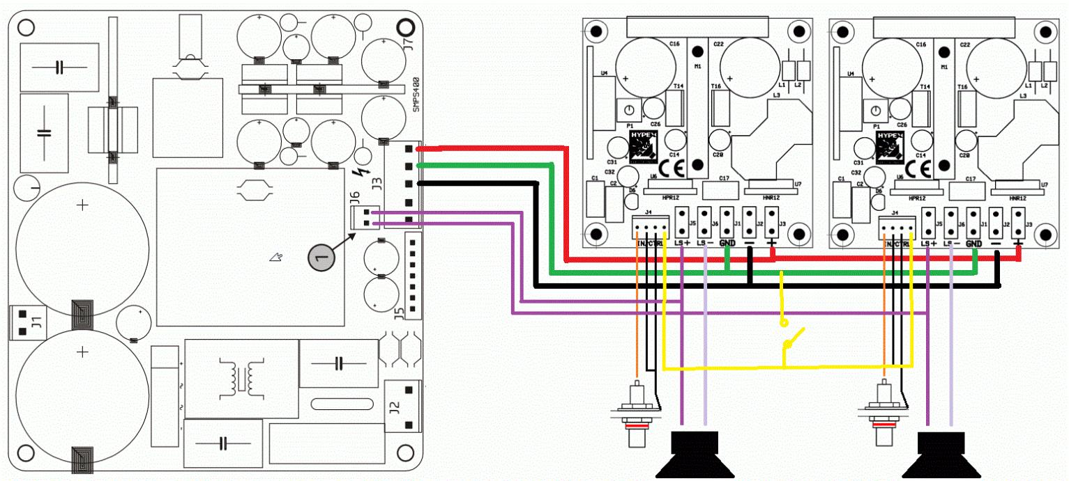

- Class D
- Hypex SMPS400 + 2x UCD180 wiring (DC error, Auto Amplifier Enable, Amplifier Standby)
